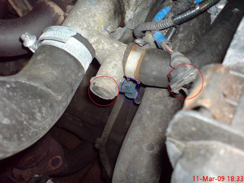

Sounds similar to a problem I've got with my Rover 25 1.6... turns out that the ecu temperature sensor connector had failed through corrosion. This sensor being faulty forces the ecu to take temperature readings from the oil temperature sensor, which obviously warms up at a different rate to the water and is less accurate with regards to engine temperature. Result is slight over-fueling of the engine by the ecu as it appears to it to be colder than it is in reality, hence the raised revs. Mine also needs a small amount of throttle to start it from stone cold, but is fine once warming/warmed up.
Pretty sure the 1.4K is the same as the 1.6K in the sensor dept. There are two temperature sensors on the cylinder head coolant outlet elbow (front of engine, gearbox end), the blue one (circled in blue in the pic) is for the dash temperature gauge and the black one (red circles for the sensor and the detached plug) is for the ecu. Top left of the pic is the exhaust manifold and top hose to radiator for reference.
http://www.lucaselectrical.co.uk/ and https://www.simpsonsupplies.co.uk may help. May be different sensor part numbers for different aged engines.

Thank you all very much for taking the trouble to respond, especially Pete with the photo as well!
