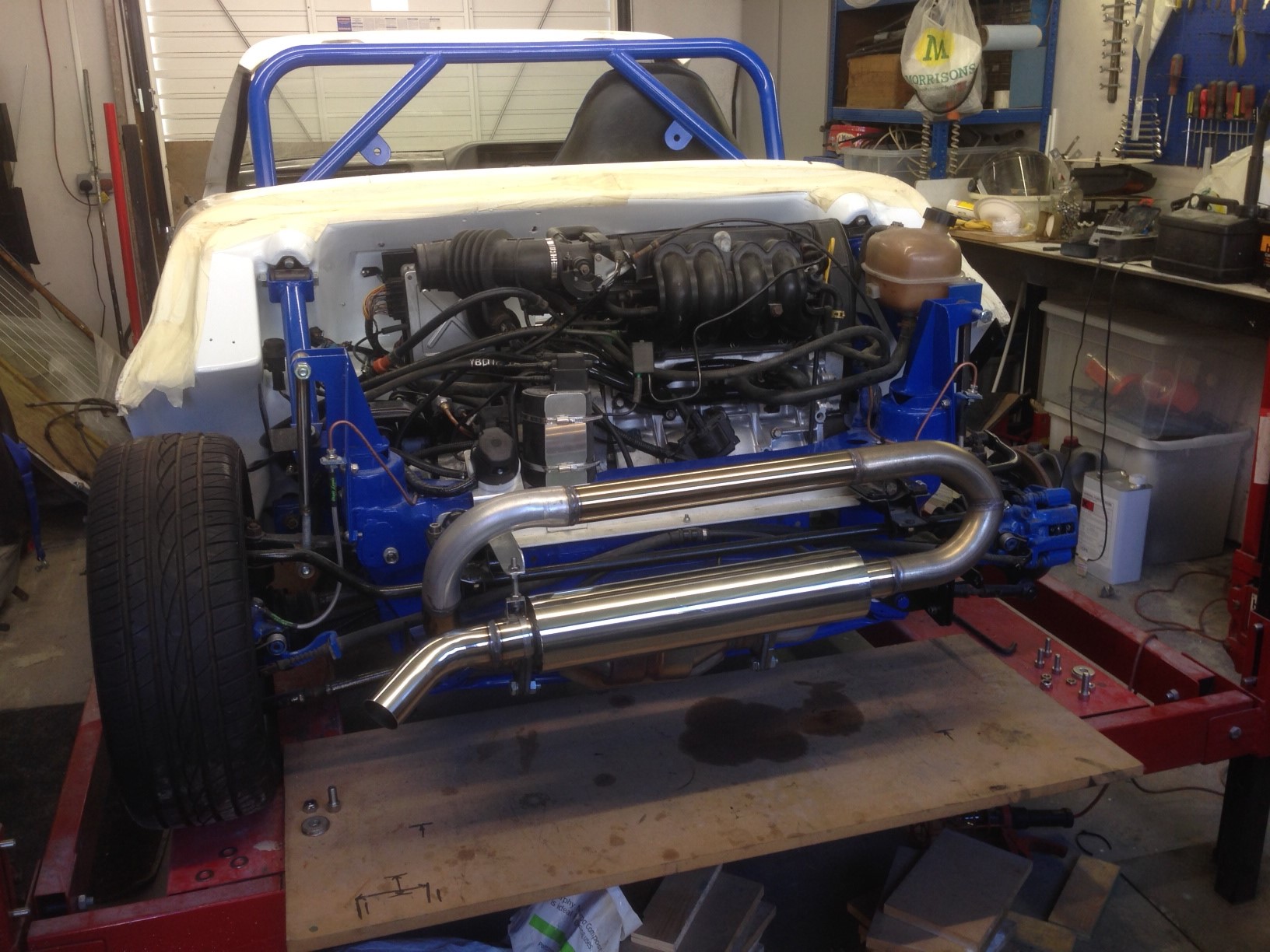

Hi Rich, There's not a lot of room left behind engine unless you remove the boot box as I have done. With my exhaust in place there is only around 4 inches clearance on the rear clam. This space gets bigger the higher up you go but it will be very warm in there.

That's an impressive looking set up there Peeps, my exhaust is single box only so I don't have the upper loop like yours there.

That's what you get for using an MGF 1.8 with catalyst (just visible behind silencer).

Nice, that's going to shift a bit!
