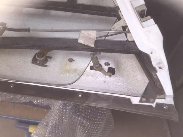

Now to fit the replacement - any tips on how to get the window glass out?
You shouldn't need to remove the glass. Wind the window down and there are the two nuts. A bit fiddly but easy.
Peter.

Many thanks. Job done.
