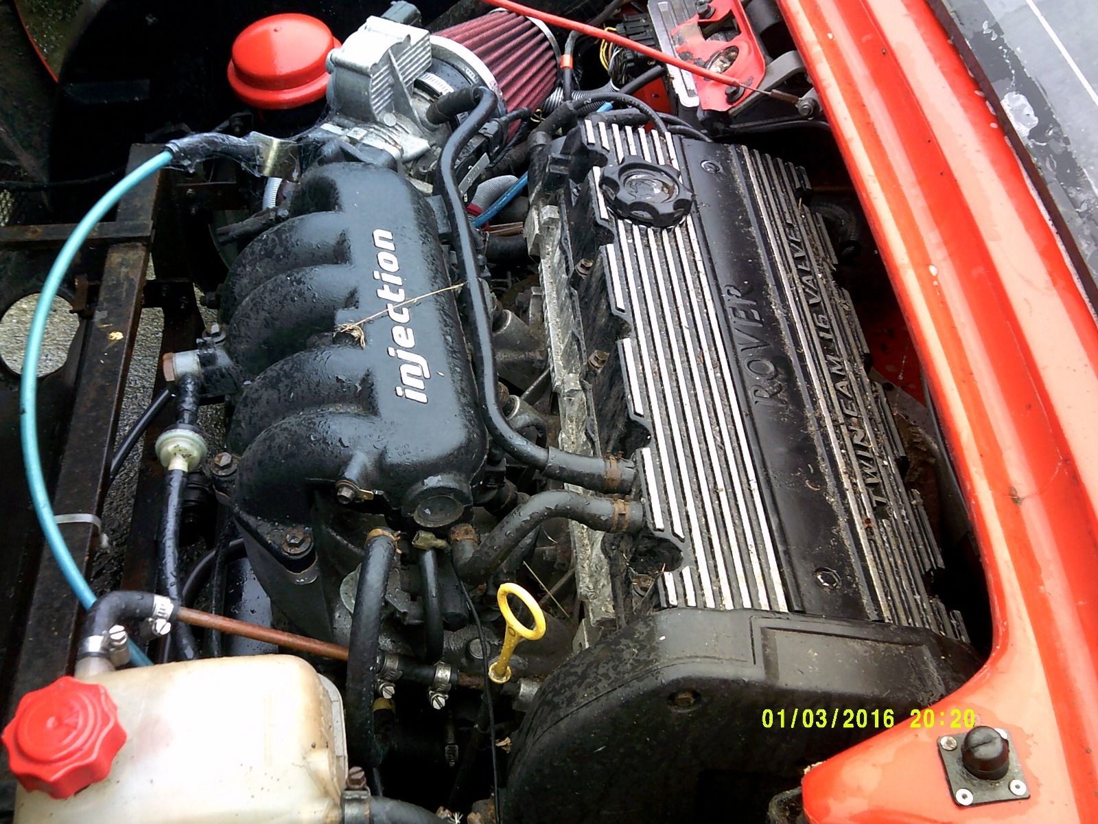

Stumped here guys. The engine # on my K series engine is missing. I have an exhaust manifold, came on the car, but the rest of the system is missing. I got an MG Rover downpipe but it fouls the underside of the engine. Any other hints on identifying the cc of this engine ?? Do I have to cut and weld any downpipe or should a stock item fit. Dave.

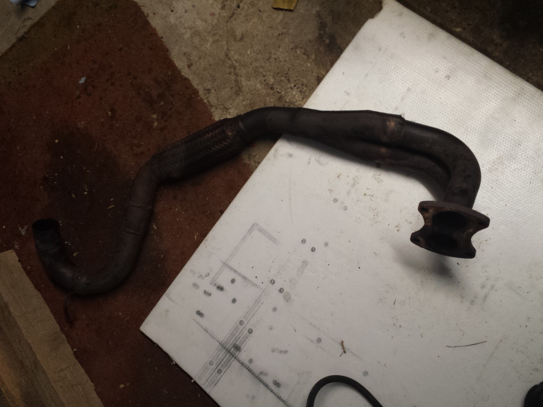

hi here is a photo of my k3 exhaust down pipe it is custom made you can just see at the end
there is two types of manifolds one with six bolts and one with four but that dose not matter
so long as the down pipe is the same
my k3 does not have the stranded Saab rear silencer the down pipe goes in the box at one end and tail pipe comes out of the over end
hope this can help

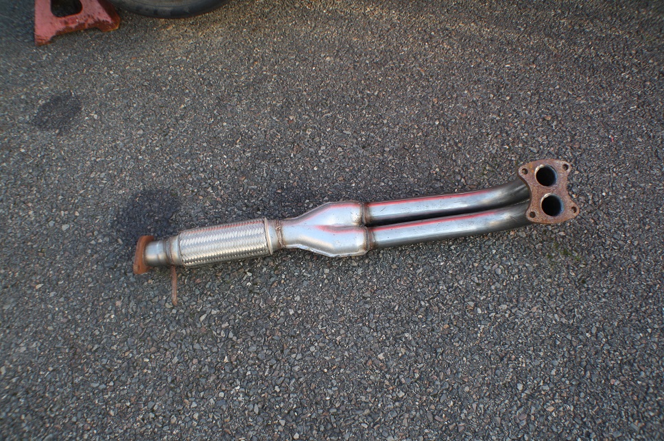

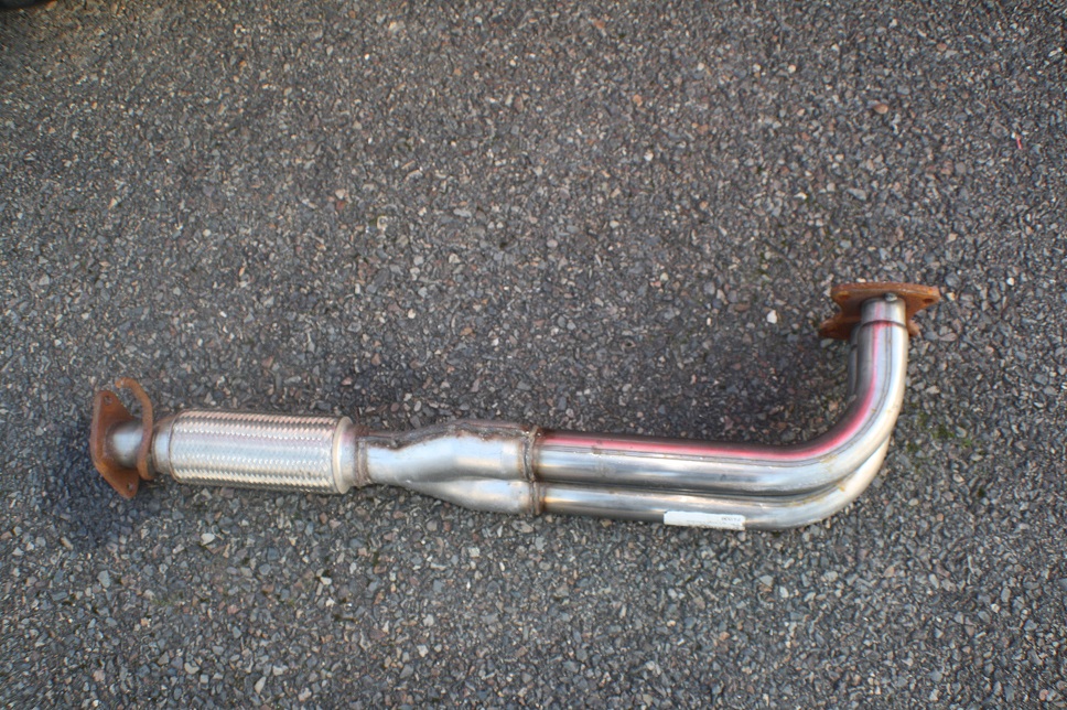

From the photo of the engine it looks like a 1.4 MPI from a Metro GTI. Your V5 doc should show the engine size. A standard manifold from an early 1.4 is fabricated item & not cast. It's outlet flange has 4 studs. The down pipes with the 2 into 1 joint and the rest of the st st system were from a company that no longer deals with the K3. The down pipes may be similar to the Metro GTI. I do not own the K3 now. But I hope this helps.

Thanks for that guys. Pics really help. I have a new welder on order and my local exhaust center people are very helpful so should be fine.
