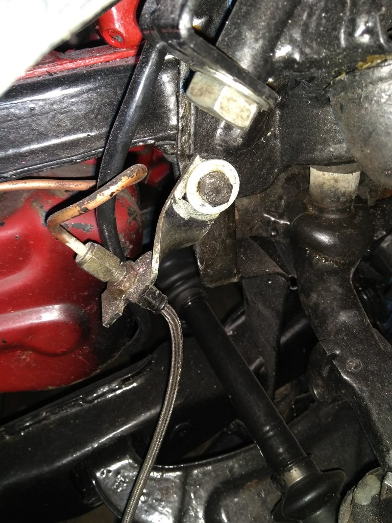

First brake pipes. I have four identical brackets, each has a D shaped hole in one end which fits over the inner end of the flexible hose, then a 90 degree twist, then one and a half holes in the other end. Can anyone tell me where these fit on to the subframe?

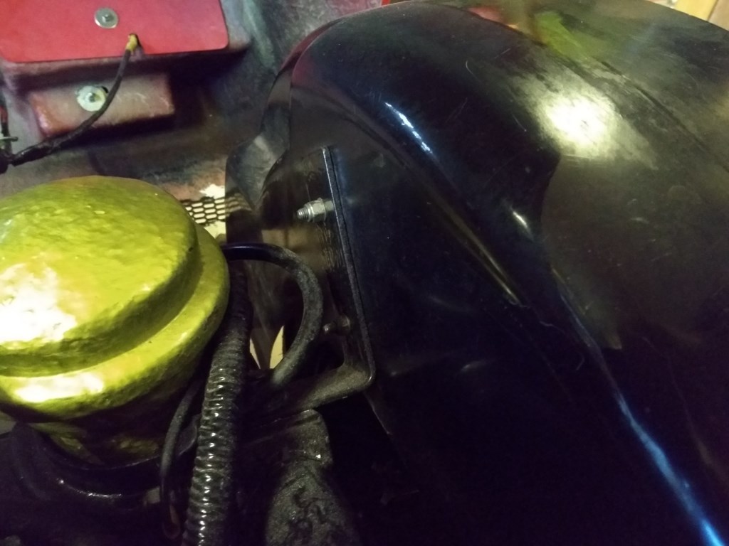

Second the inner wheel arches. I have a bag of nuts, bolts and self tappers labelled inner wings. My build manual says see diagram for fitting the bracket but there is no diagram and I do not have any brackets.

The twisted bracket fit on the M8 lower front mounting bolts on the suspension towers with the bracket pointing forward and down at a slight angle. I adjusted mine to get the best clearance for the flexible hoses. I will get you a photo when I can get good access.
The rear wheel arches are fitted with a bracket that fits onto the top bolt of the torque tube and the rear arch is fastened to this with two M6 nuts and bolts. See photo.

I have taken a picture of the brake pipe bracket.
This one is at the rear.
Hope this helps.
