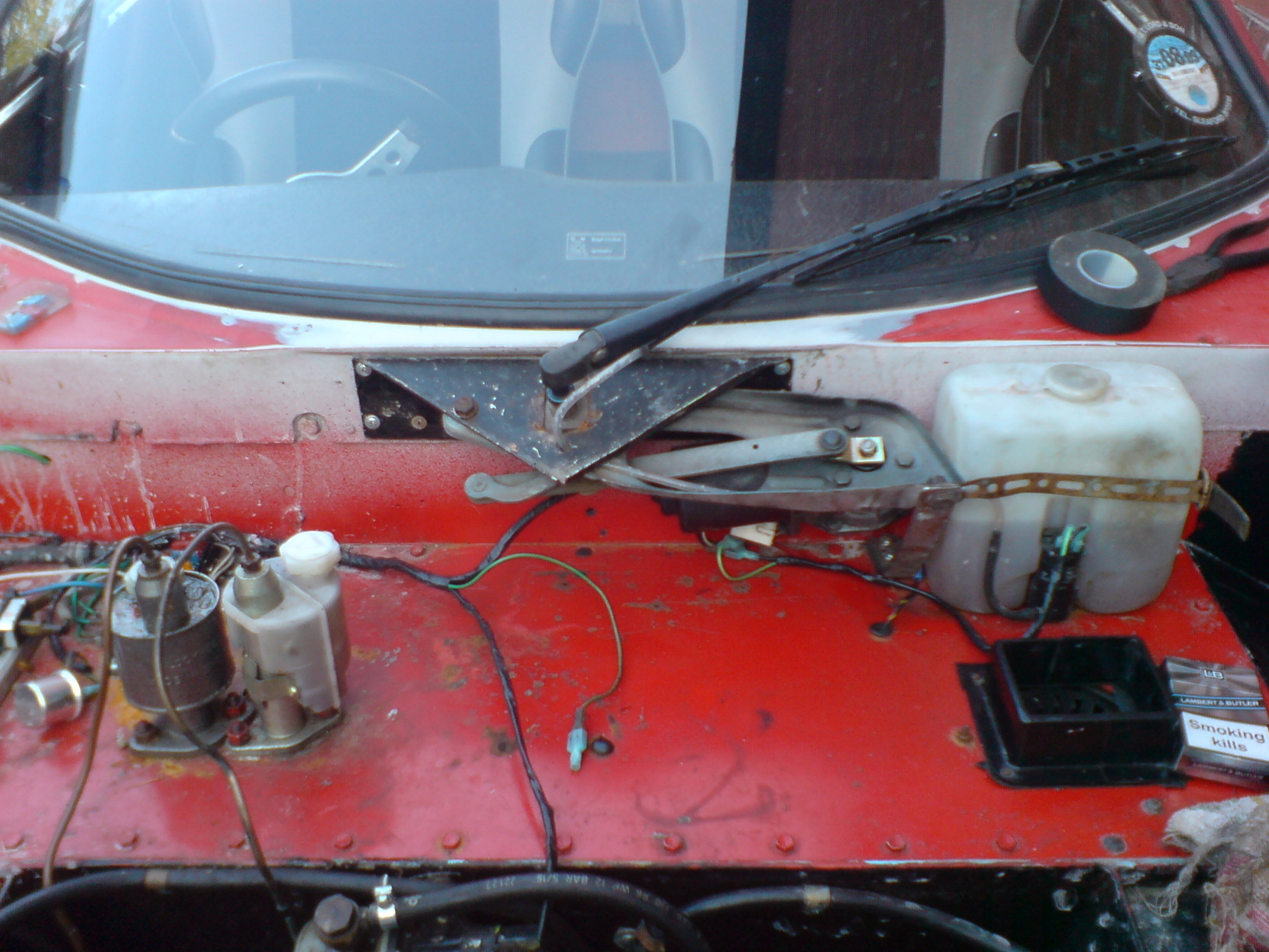

I got one from the single wiper AX. I've stripped it from it's nasty looking bracket and I'll be mounting it onto a pair of aluminium brackets. You get multi speeds and it goes fast enough to sweep the whole screen. One of my flea bay purchases!!

Here's the new install - Citroen AX with the nasty bracket - I don't think it looks too bad, though it is a bit big for what it does.

I removed the bracket and have made some ali ones. What is the sweep like? I can't tell until the screen goes in.

Perfick - Exactly right.
