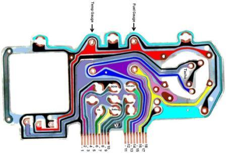

The speedo on my Rossa II has always been way out so, when the cable went, we decided that the cost of a new one would be better put towards a decent speedo. We went for the Smiths International gauge and, while we were at it, decided to fit a matching tachometer.
These fit the holes left by the old gauges, but the circuit board needs a fair bit of modification to keep the existing fuel and temperature gauges and warning lights. After a bit I got bored of sitting with the circuit board and wiring diagram, tracing the wiring. So I stuck it in the scanner and coloured it in on the computer.
I thought I'd post it here just in case it's of any use to anyone else.

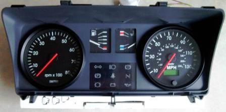

..... and here's the finished article, ready to install.

It wasn't as easy as I thought it would be to retain the existing fuel and temperature gauges and warning lights. You can't refit the perspex cover as the bezels of the new gauges get in the way, so I had to fix a perspex cover behind the existing panel, which involves lots of cutting and adding bits.
Do you think it would be worth putting some sketches on here of how I got round it?

You could always put some sketches up if someone asks for them - it might be a bit of hassle for nothing otherwise but its very good of you to offer.
When I did mine I fitted Smiths fuel and temp gauges (pics on my thread in Projects) which were easy to do and removed the original ones from the panel, covering the holes with a blanking plate from another model of Metro. Apart from the speedo and tacho the only things I use on the panel are the warning lights for main beam and indicators and it would be easy to change those too. One of the things I meant to do during the build (and forgot :roll:) was to run some spare wiring from the engine bay and from the front to the dash - it would have come in handy several times already......
