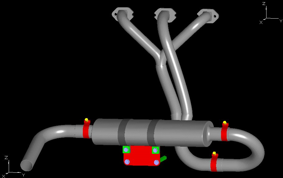

The early Rossas had the mild steel Imp exhaust. I have one left in stock going very cheap.
I have in stock complete LCB stainless systems to fit the Rossa1 & 2 including the fitting kit and clamps.
They are not cheap but are easy to fit and should never need replacing.
Please contact me direct if you are interested.
