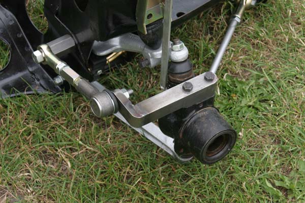

Has anyone seen the newly engineered tie bar produced by Alan Britton, Coupe and Rossa owner and proveyer of Rossa parts. The prototype, see picture attached, was seen at Newark last year and I believe that the final design may be available this year from Alan. The member ensures that the tie bar is positioned between the top arm fulcrum axis inboard and exactly in line with the centre of the top ball, outboard which should ensure no bumpsteer whatever.

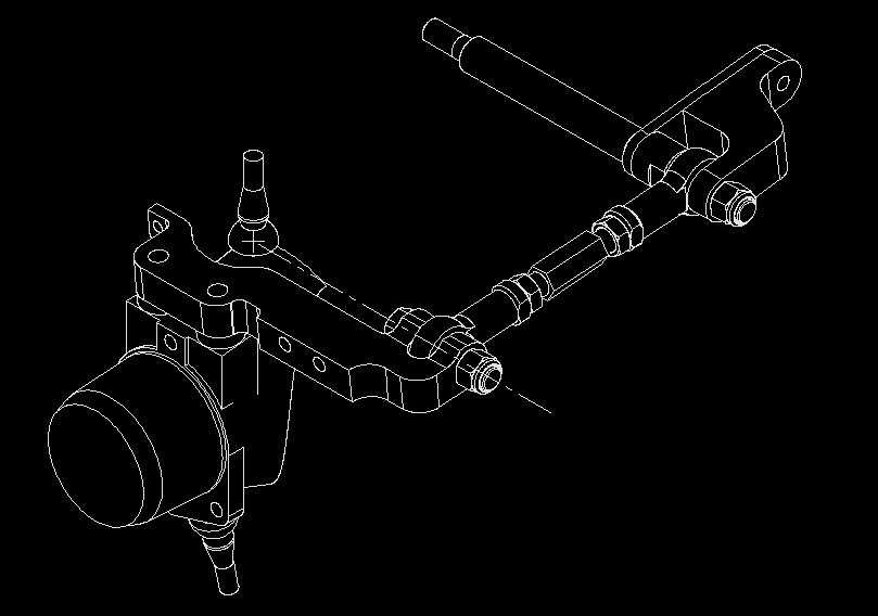

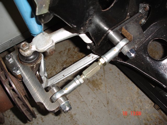

Thanks Malc for the photo of my early idea.
But design has changed considerably since then.
The new arm is waterjet cut and then machined.
It is a direct replacement for the original steering arm but uses a spherical joint in line with the hub top ball joint.
There is a lug for mounting the drum handbrake cable and a face for mounting a disc handbrake caliper. Either can be
machined away if not required.
The standard RH/LH thread track rod is retained.
The inner spherical joint is mounted on an extension of the top arm pivot with a sturdy block fixed to the old plate mounting point
Machining is almost completed and kits should be ready for Stoneleigh. No price yet.
