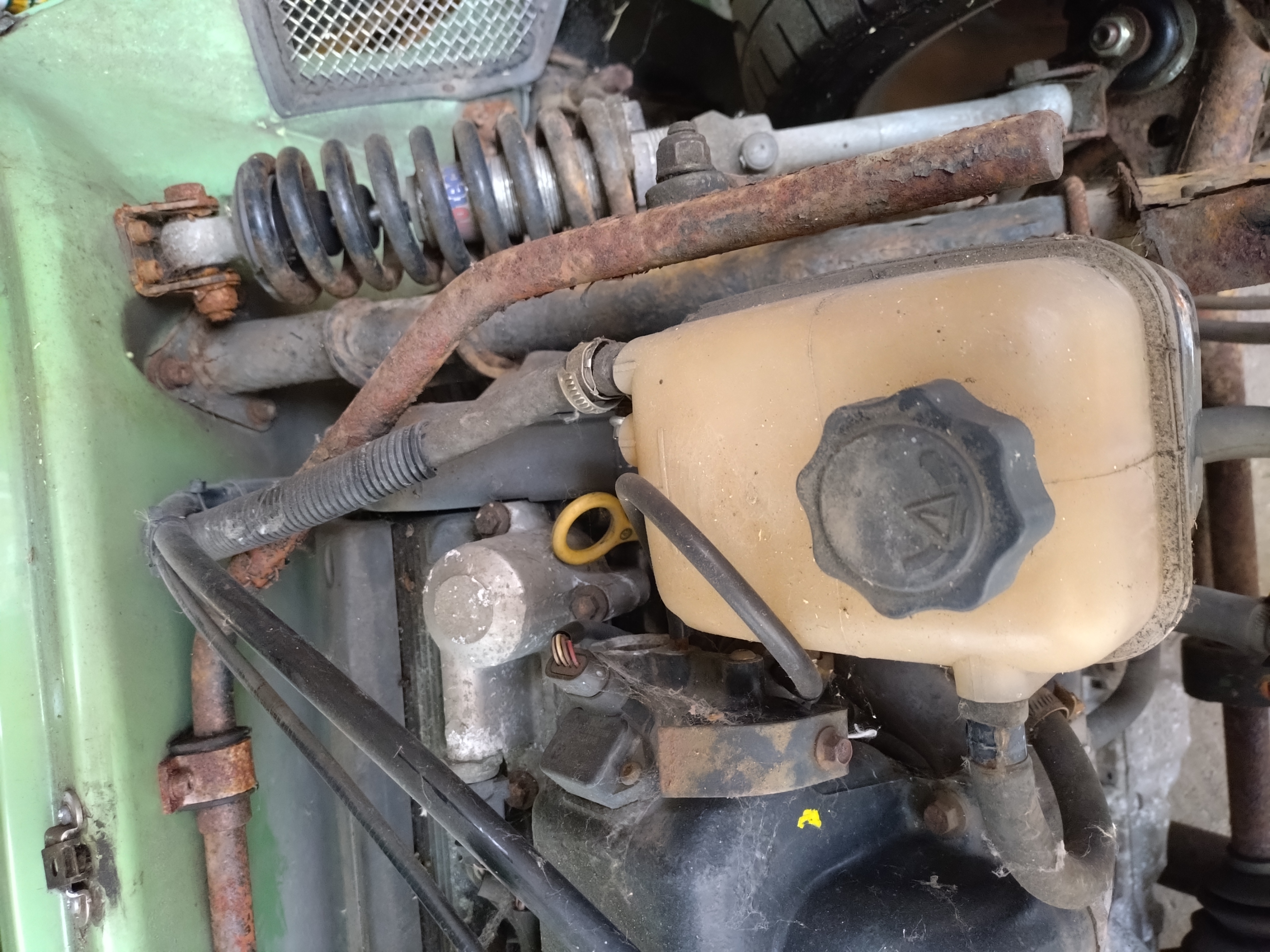

Hi Just repainting my rear antiroll bar
Diameter is 18mm but need to replace the bushes, does anyone know what part was used GTM ??

At 18mm you have loads of options. Lots of japanese and german cars use 18mm id bushes and either oem or polybush aftermarket kits are available in that size. Might just be a case of googling images until you find something that looks right and taking a punt. Mitsubishi outlander looks very similar but unlikely to be what GTM originally used. VW polo also looks a good match.

I will have a look at VW polo, you never know as the bottom joint is off a polo

i bought some antiroll bars from Alan Gow years ago who was the person who made them for gtm he said the bushes were from a metro but did not say what type of metro but i think it may the a series engine type metro but not sure. i did not use it in the end as i found out later is was made with 20mm bar so would be to stiff and the bushes would not fit the wrong size bar.

Well I have a bush that fits, Ford Mondeo MK1 18mm rear antiroll bar bush: part number 7 144 202 . Febi 24918
Many thanks for everyone's
recommendations
