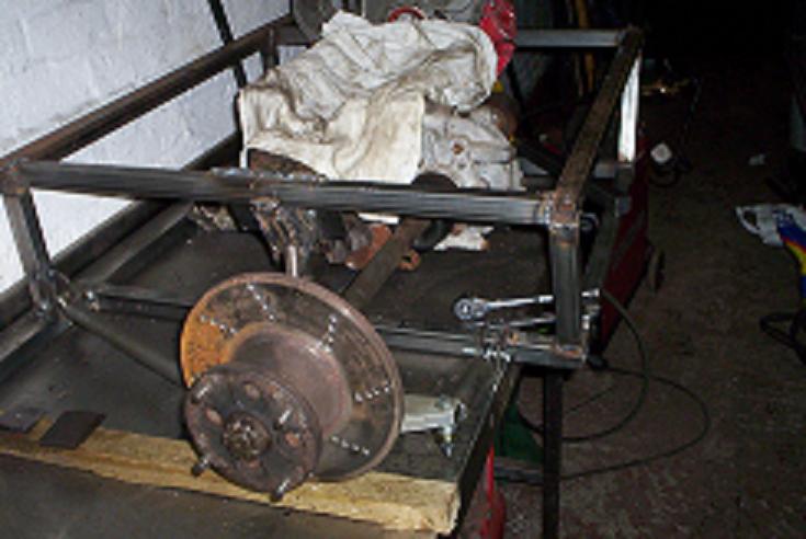

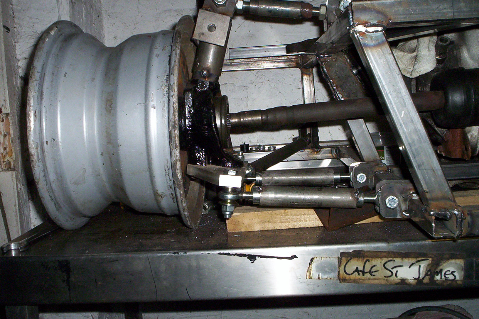

a bit of idea i am playing with on my rear suspension

Post Re: Rear suspension
Well they certainly won't steer with that lower wishbone. How's the geometry and roll centre work out with that set up. Upside down swivel hubs will put the lower pivot further inboard than the upper pivot, which is the opposite of a conventional Mini set up.
Mon Mar 03, 2008 12:58 am
It'll depend on the inboard pivot point of the top arm. If taken straight to the upper member of the frame adjacent, it'll cause increased camber under suspension compression as the effective wishbone length will be different top/bottom. Whether this would be a problem - I dont know.
I'd be dubious about putting a mount into the middle of the upper member also - but i'm assuming that has already been taken into account. :D

[attachme
nt=1]gtm build 001.jpg[/attachment]
thrown plans out the garage again, mk3 version
Simular to a tarrapin :wink:
Also i have a design on simular lines, to sort out the toe stiffness issues especially seeing i will be winding the wick up even more on my car this year :!:
But i was not planning currently to spin the upright upside down.

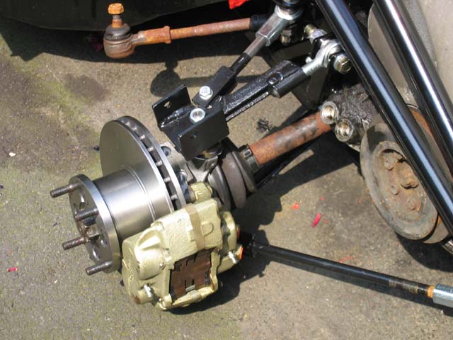

is this simlar to yours

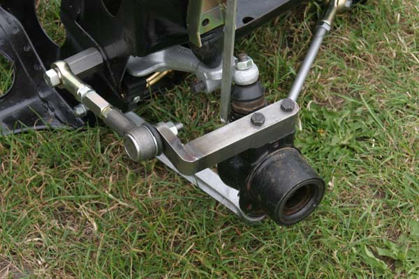

Has anyone seen the newly engineered tie bar produced by Alan Britton, Coupe and Rossa owner and proveyer of Rossa parts. The prototype, see picture attached, was seen at Newark last year and I believe that the final design may be available this year from Alan. The member ensures that the tie bar is positioned between the top arm fulcrum axis inboard and exactly in line with the centre of the top ball, outboard which should ensure no bumpsteer whatever.
File comment: Photo of Alan's prototype tie bar arrangement
