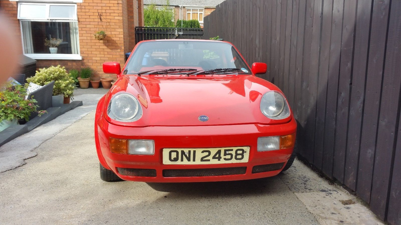

I’m back with. Rossa, following the enforced sale of my K3 a few months ago..........
Once I get home from my ferry journey and long drive north east, I’ll upload photos properly, but here’s my Facebook post as a warmer upper.

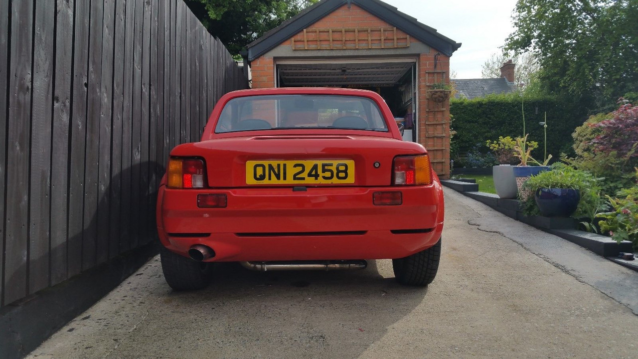

Pictures as advertised for reference;
J.

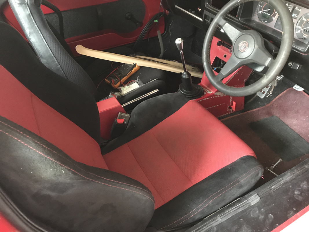

One detail of my Rossa that I need to sort is the centre console as mine is a bit of a mess because the fibreglass has been chopped about and then covered in corded carpet and now that Rossabitz has supplied me a shiny new one, I would like to know if anyone has trimmed theirs in vinyl, as my original one was painted red but I’d like it covered now rather than painted?
If you have, was it difficult and do you have photos?
J.

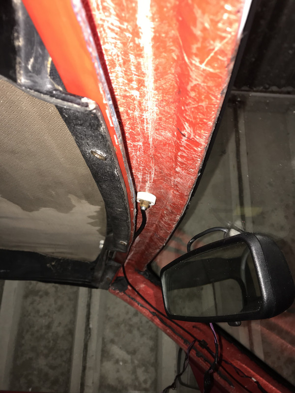

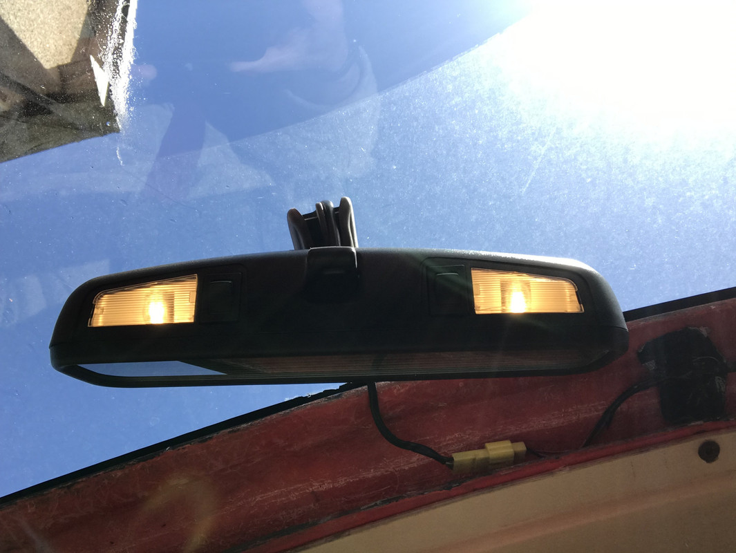

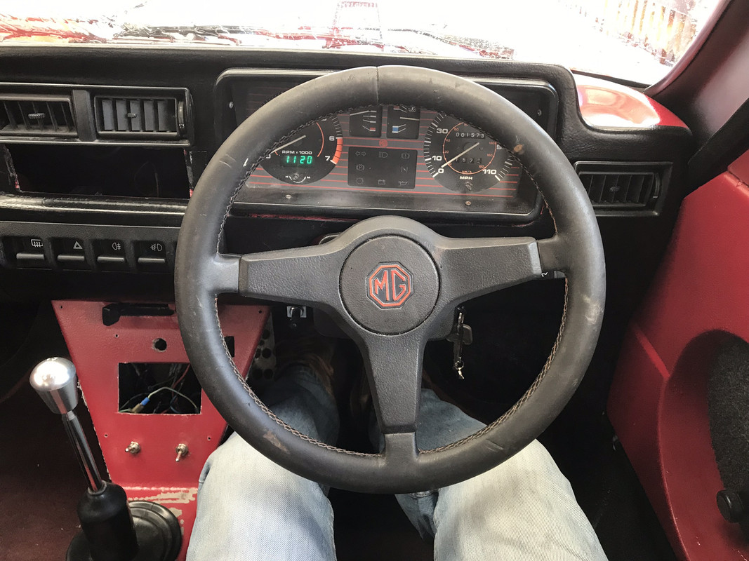

First proper run out this year and a much deserved wash, after I finally got round to fitting up and wiring the MGF interior mirror that gives much needed interior lighting and I also fitted the MG Metro steering wheel that I got recently - much nicer than the plastic grey one I had on it
J.

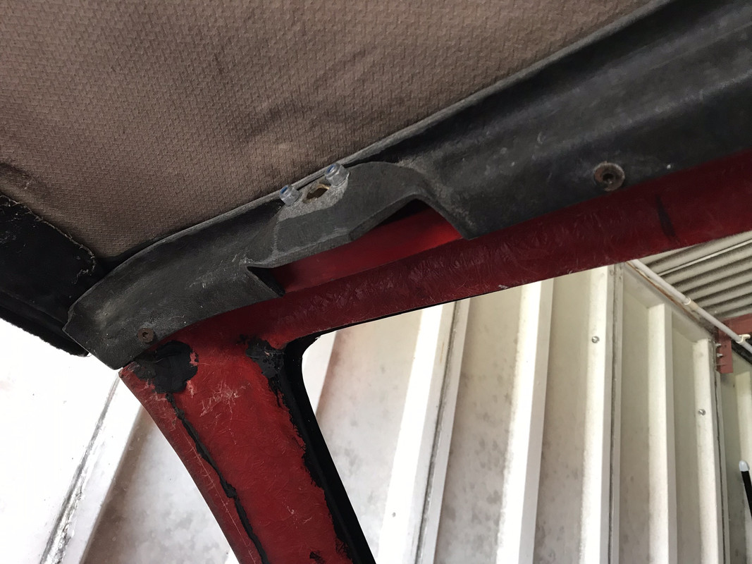

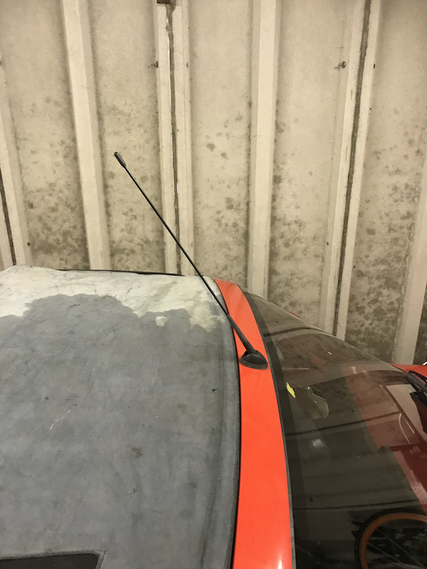

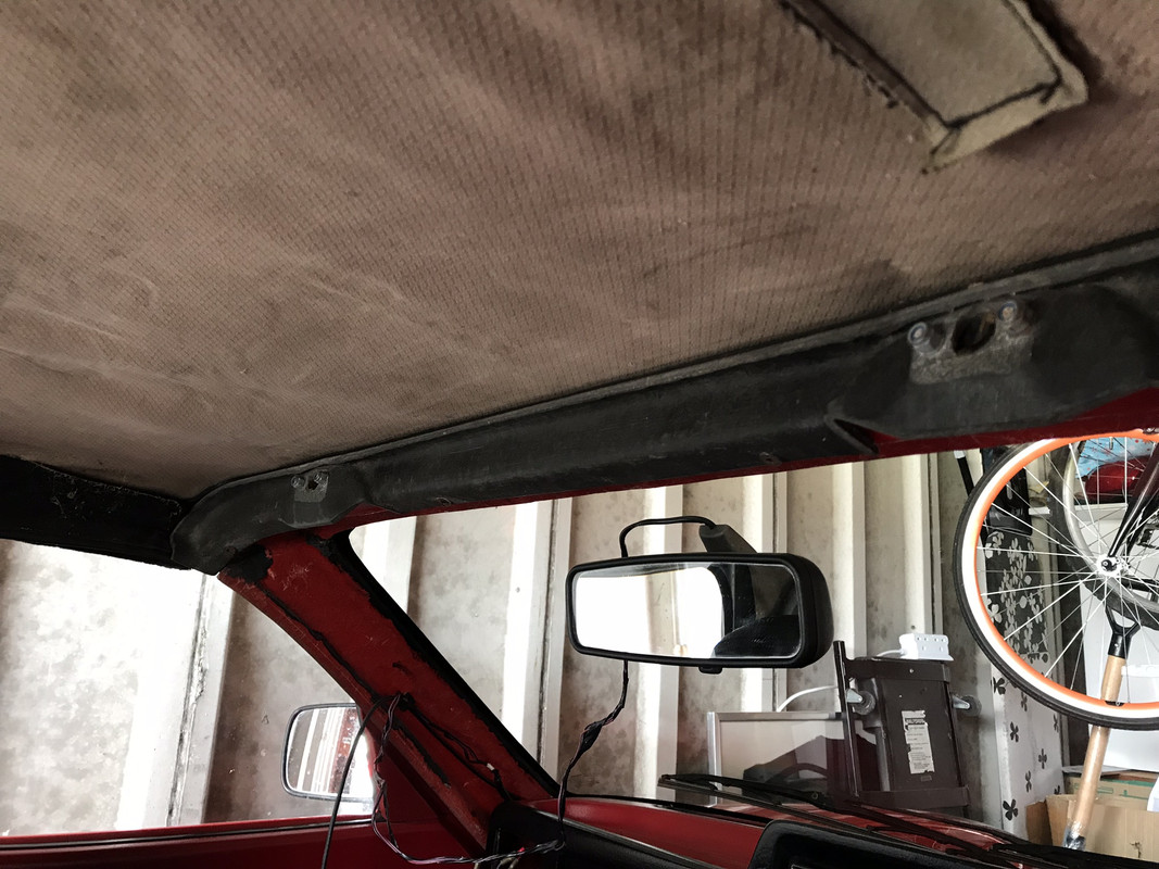

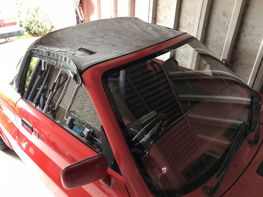

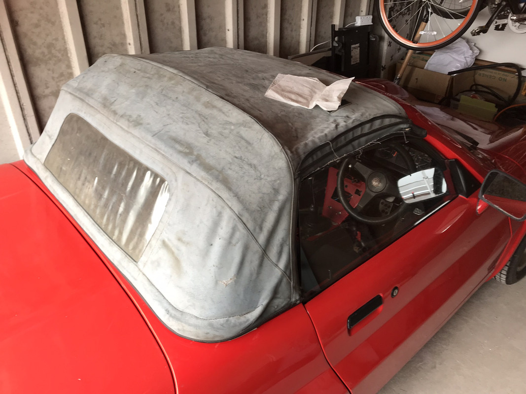

Well, it’s been a few weeks since I got any time on the Rossa, what with me buying an old VW T3 camper that needs so much attention and last weekend, I managed a few hours sorting the cable run for the MG rear view mirror lighting, the cable for the aerial for the radio and wiring loom for the said radio.
I also started to trial fit the new inner windscreen surround trims to finish it all off and then decided to mount the soft top assembly using the 4 hard top header rail bolts instead of the Triumph cam levers and you know what - it actually actually works.
This morning, some bolts that I needed turned up and one of them was for mounting the FIAT Punto aerial to the header rail above the windscreen and this was duly done and I can now start putting the trim panels all back together.

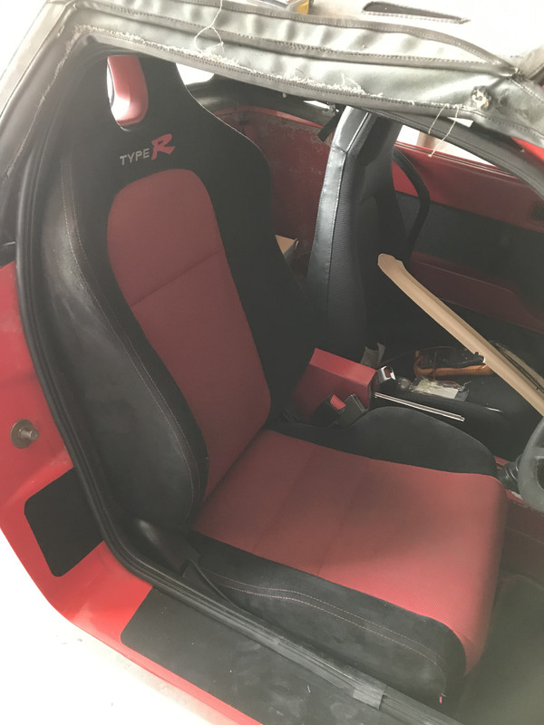

I have been after a set of Honda Civic Type-R seats for the Rossa and manager finally to get a set reasonably locally and after picking them up this morning, I proceeded to fit and guess what, they look the part but are too high with no way of lowering them and I am soooooo disappointed :cry:

Well, after a long search for a decent set of Honda Civic Type R front seats, then finding that they are too bulky for fit comfortably, today, I was in my local scrappy to get a replacement Fiat aerial base and I spotted an Audi TT with a very unusual interior; therefore, after copious amounts of tape measuring, I had unbolted the whole set, front & rear and stuffed them into the back of my daily driver before I could talk myself out of it and paid the man.
I duly got them home and after removing the Mazda Mx5/Eunos tombstone seat on the drivers side, the trial fitting began and a little mod to the runners will mean that it fits perfectly for me.
An hour or so on each runner set should see them fitted and the matching back seats will allow me to trim the rear bulkhead moulding.

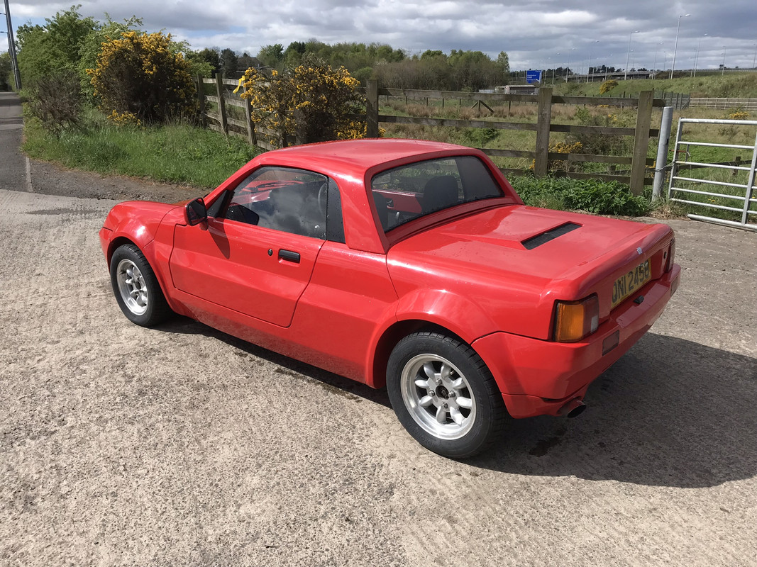

Woo hoo! The wee car just passed it‘s MOT today with advisories on front wheel bearings needing nipped up and slight play on steering rack at steering wheel - happy days given that the car has only done 207 miles since its last MOT :lol:
