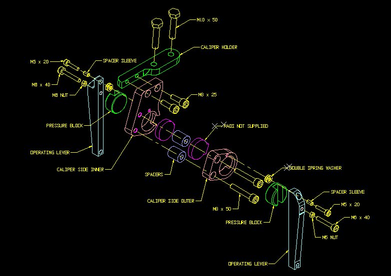

Hi bert
Yes you can fit 'A' series Metro discs.
I sell a handbrake kit.

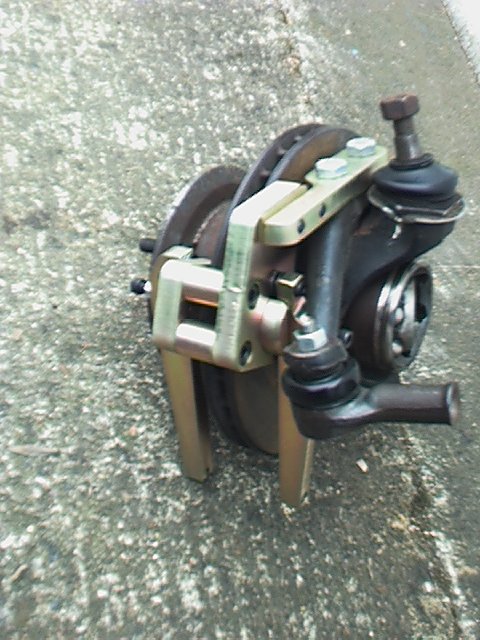

Post Re: Discs on a rossa??
The kit fits Coupes and Rossas,vented or unvented Metro
or Mini discs.
The price is £150 + vat + carriage
You'll also need Citroen GS pads and new cables.
Alan
