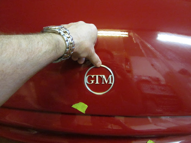

Got the car sanded down with 800 and resprayed.. now just doing a color sand and buff of the car to bring out a nice shine.. I got a front emblem made up by a friend with a milling machine..he dropped by with the finished product today.. this will be buffed up and clear coated to keep the aluminum from oxidizing.. here is a few shots..it fits perfectly in the recess I made in the hood..
Now back to color sanding and buffing...
