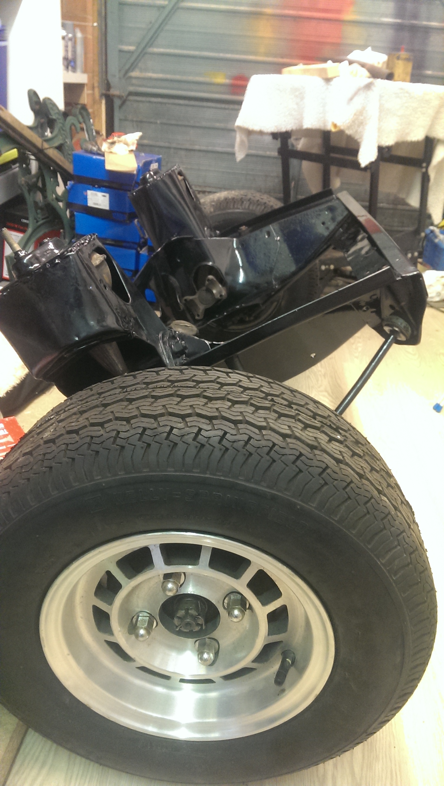

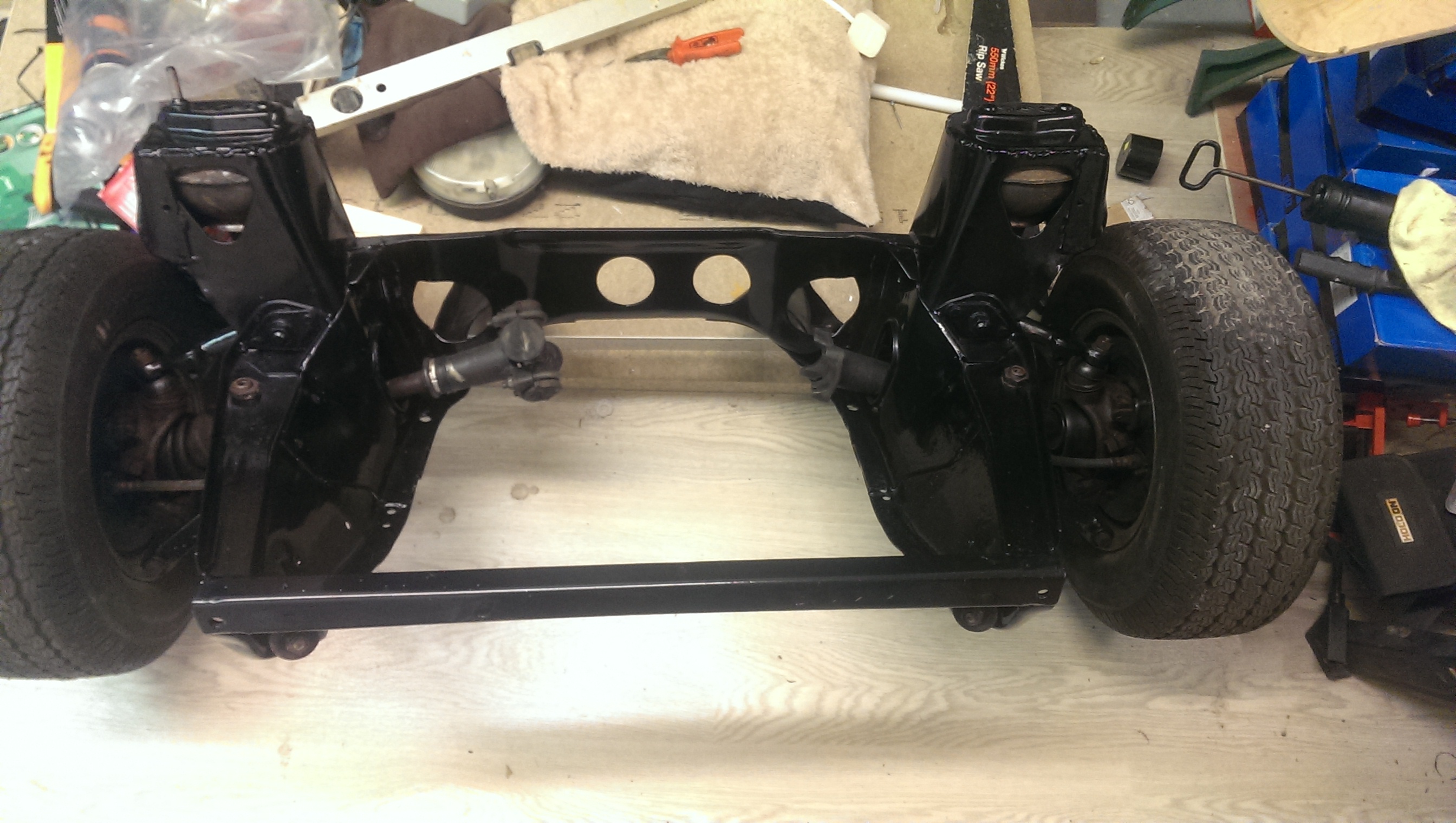

Well a quick update, been a while coming as been on shutdown at work.
Finally got the subframe powder coated and rebuilt with new bushes, new hi los
Or anything else at the mo, just need to get it rolling again to get it home

Post Re: New member
Subframe ready to go back into the car.

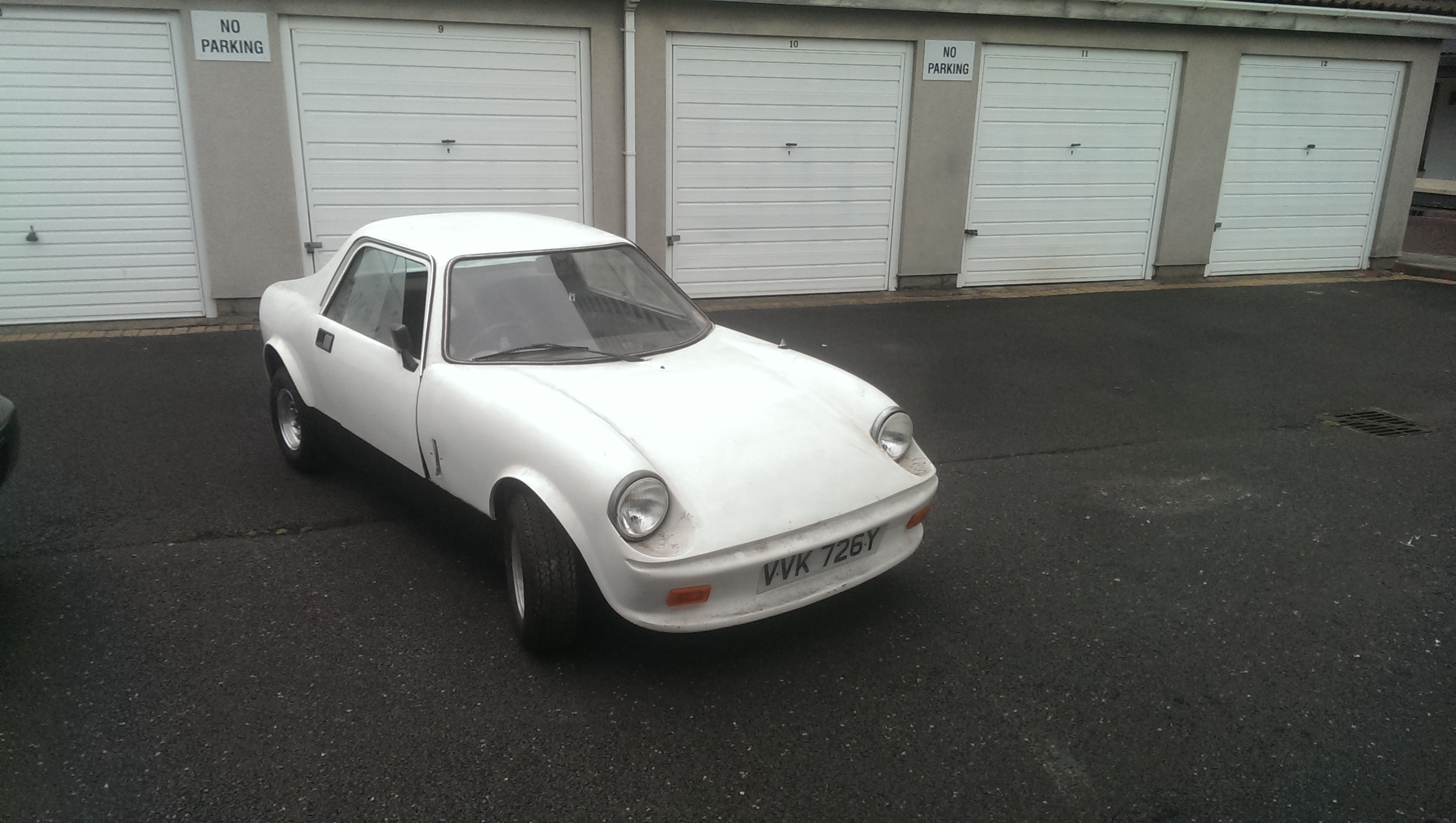

Sadly don't have no install pics but managed to roll the car out of garage tonight
To start work on the front end. First time in ten or so years.
Going to strip the front subframe in the same way and rebuild and install in the car then transport it home
Garage is only ten mins away so not to bad.
