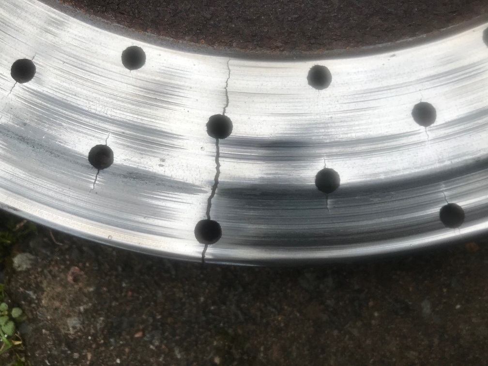

Just a quick warning on something to look out for if you have drilled discs. Mine does, were on when I bought the car six years ago. If they have been on since the build then I guess they've done okay - 16 years/32,000 miles. I had mine MOT'd today and the tester called me under the ramps and showed me two cracks in the offside front disc, both started at a drilled hole and went all the way to the outside of the disc. They are abut 60 degrees apart and both on one side of the vented disc only. They are on the inside so I don't often look at that side. The outside is fine. Not sure how long they've been like that but I think not long as I've noticed a slight vibration under braking just recently, since the last track day I did in October. I guess mine get some fairly extreme use - I get through a set of EBC Bluestuff in 6 track days!

Here are the cracks:

kaighn80 wrote:
the shape of the spots or grooves can make this worse, did you notice if the spots go all the way through and if they have a point, when i groove my disks i use a ball nose cutter to make the channel radius-ed to reduce the chance of cracking, but its always a risk.
They go right through both parts of the vented disc. There is no doubt that the cracks start at the holes as there are small cracks starting at many of the other holes and the larger cracks go right through holes.
I agree that radiused grooves are a much better way to let the hot gasses/dust escape. These drilled holes were on the car when I bought it. I think I'll stick with plain for now.

Those track days have finally killed them it looks
Think you’ve done really well to have lasted this long :lol:

Dave it is a common problem on all drilled discs seen it on TVR's

Probably you have the MGF front upgrade kit as produced by some folks? Uses same calipers but with different bracketry to allow for bigger discs.
My 304s are grooved/dimpled, i'd never want fully drilled discs precisely for the reasons you've shown.

We had drilled discs on Jedi race cars, but after cracking have now changed to grooved
