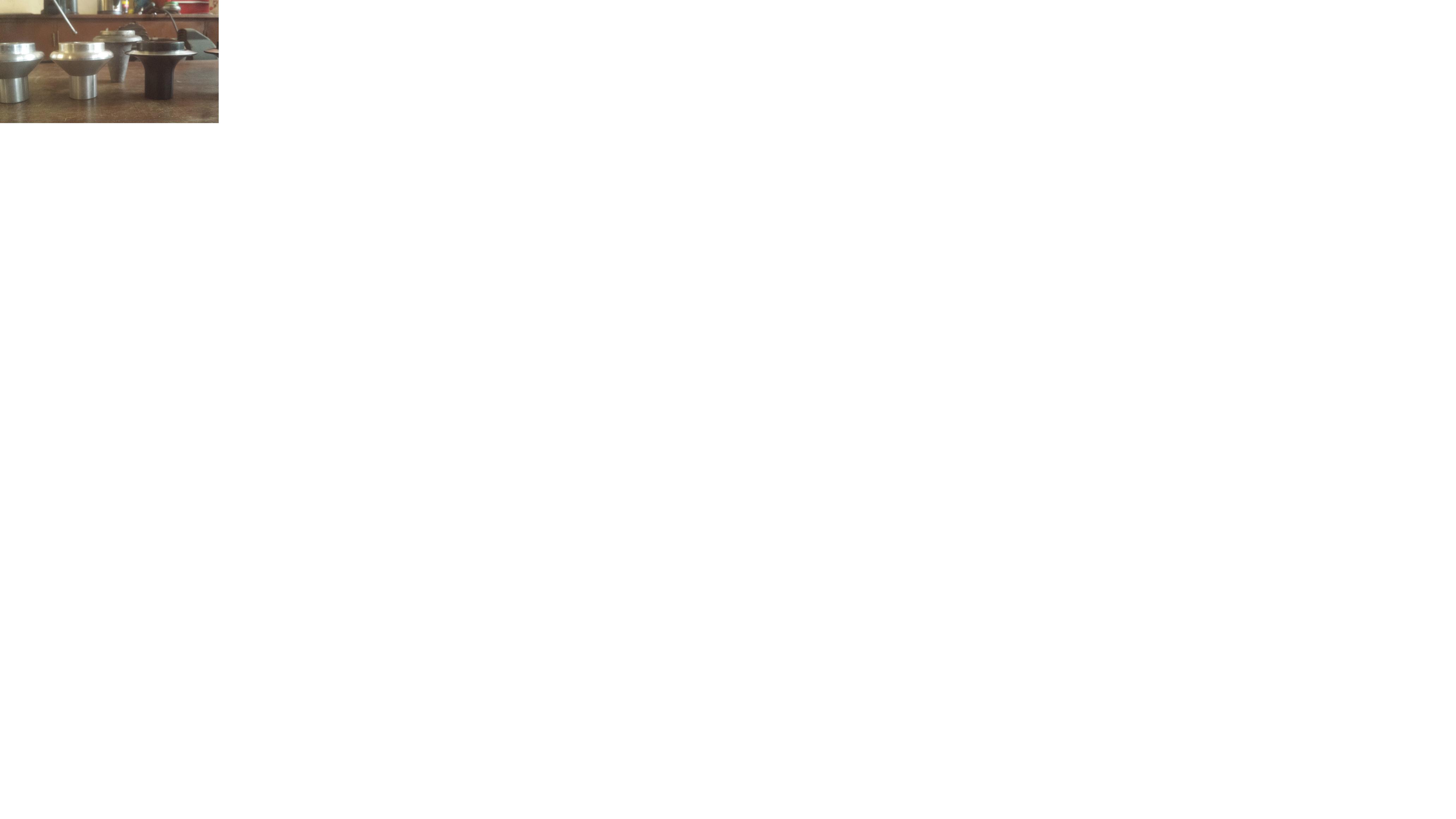

Thanks Steve. Yes i had looked at them - think the price put me off. If I remember correctly they were nearly £300 for the complete kit!
But I realised that my rubber cones were well passed their best. So decided to replace them first & see what difference that made. As it turns out quite a significant difference - the old ones were very compressed & hard, resulting in very little suspension movement. You’ll see the difference in the pic. Much softer but still think i need adjustable shocks too. Just waiting for a bit better weather to try it out. :D
