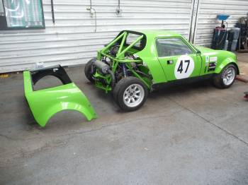

As you know I have 2 GTM coupes:
1) The red car. This has a purpose made roll cage manufactured and fitted by the firm that has just made Shane's, I gave him the address and details some time ago. There is no foward diagonal on it that would obstruct the passenger space. There is a cross diagonal in the back frame.
The front and back portions of the cage are linked by low level horizontal bars which are running forwards/backwards at low levels across the door openings. There are 2 very short back stays that land on the top of the rear bulkhead. I have owned this car for about 5 years, it came with an MSA logbook and I have competed in about 40 MSA sprints and hillclimbs and never a word has been said by anyone about the roll cage. In fact nothing on the car has ever been queried by a scrutineer, Mr Goldthorp built it well.
See pictures:
2) Kermit. I bought this about 2 years ago. It had no MSA logbook and had never been used in competition. I got it inspected by an MSA scrutineer and it was issued with an MSA logbook. I have competed in MSA events about 15 -20 times and nobody has ever said anything about the roll cage. It does not have a forward diagonal strut/brace - it had a passenger seat in it when I bought it. It does have rear facing back stays which are connected to the rear spaceframe. See picture:
Steve,
The first obstacle is getting and MSA logbook which Shane could do now - it is pretty unlikely (in my opinion) that a car with an MSA logbook would be denied permission to compete at an event. In the details they take for the logbbook the roll cage is noted.
David
