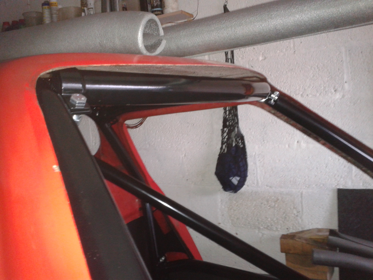

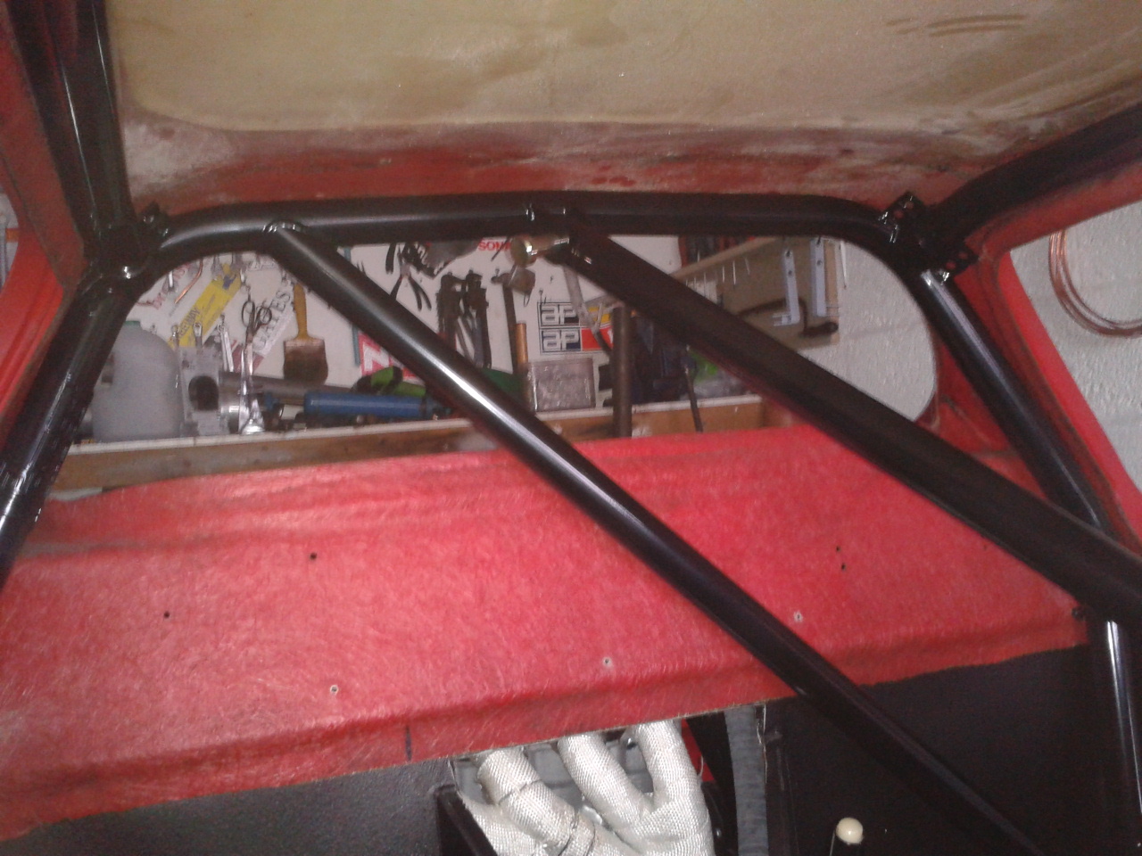

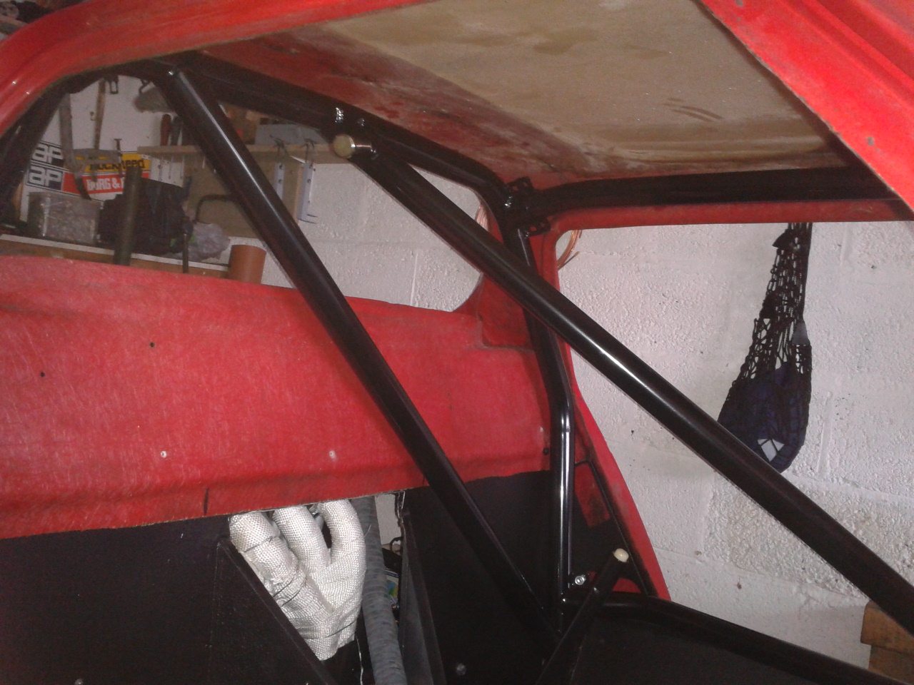

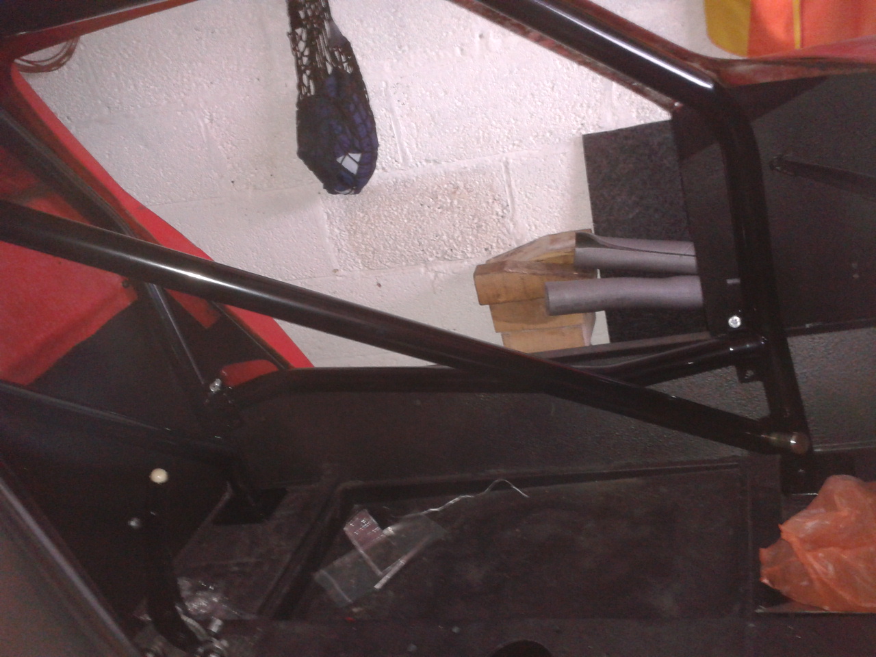

just a quick mock up on fitting the cage

That does look to fit rather well.
Mon Mar 03, 2014 12:55 pm
Post Re: r 1 coupe
It does look good, I hope mine when fitted looks like that :roll:
Mon Mar 03, 2014 1:42 pm
Post Re: r 1 coupe
Cage looks fantastic -- does it meet MSA regs? If so you may have found a solution that a lot of folks have been looking for!
Tue Mar 04, 2014 12:49 pm
Post Re: r 1 coupe
If the MSA requires a back stay it is not compliant, but when looking at Westfields, Caterhams etc they are not fitted with back stays, where would you attach them :roll: so it should be easy to show plenty of other short assed cars without back stays to strengthen your argument.
