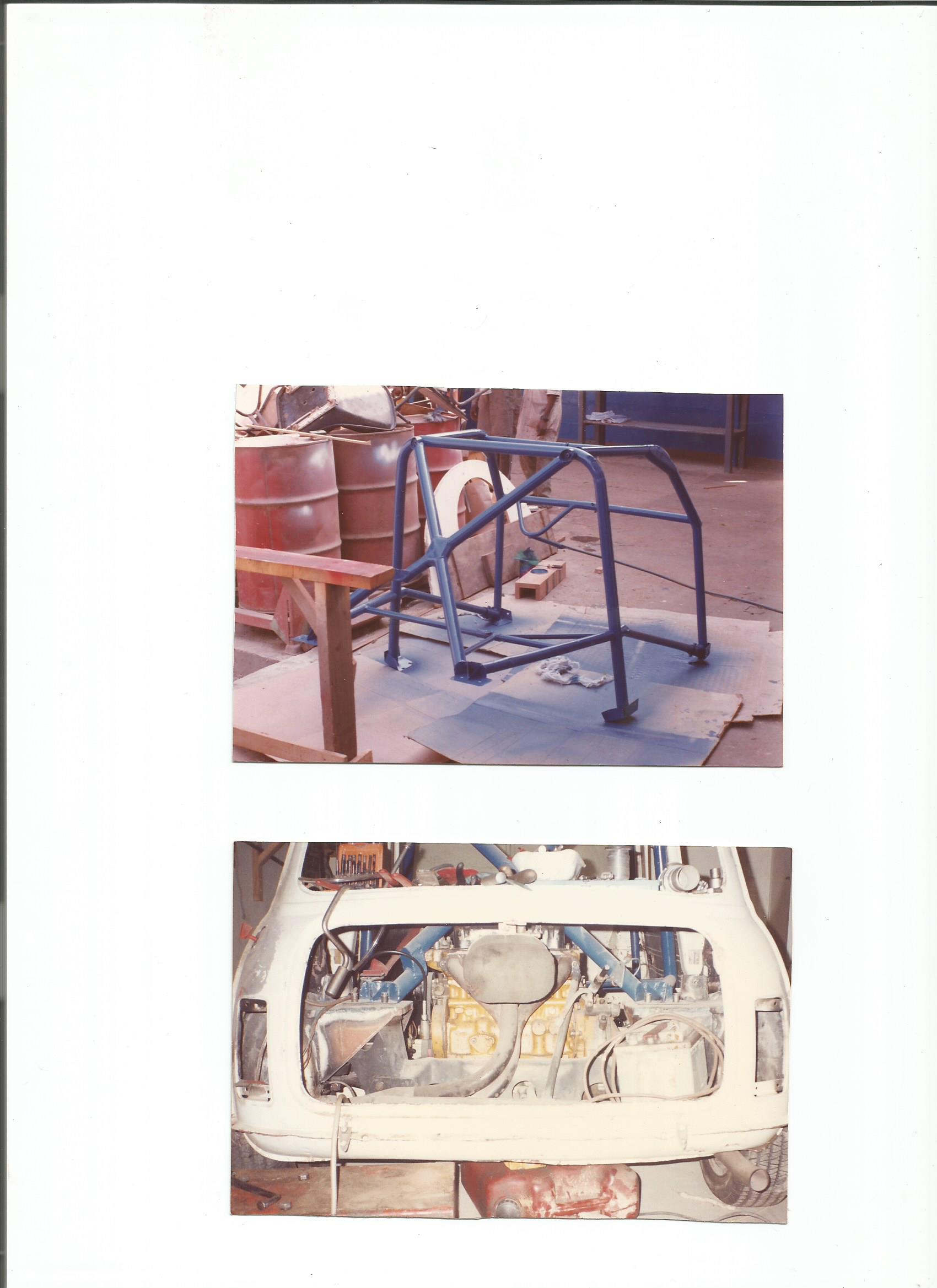

My Twinni mini rear and cage

Nice solid work there John -- probably need a bit of tank tape round that battery to hold it down.

No battery fitted at that time, it was fitted on the passenger side just behind where the seat would go if it had one.
Now if our friend who wants to make a mini special could arrange transport the twinny is here minus its rear engine and front (rear) subframe for a very reasonable sum?? :D
