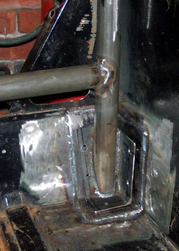

WEST :idea: How about using a small diameter rod c4mm threaded at both ends, bond the top to a mount in the roof and anchor the base to the dash. Think of the weight you'd save. My MGB Roadster had one. Would make a good mount for rear view mirror too ( or do you not want to see whats come out your exhaust pipe ) :!:

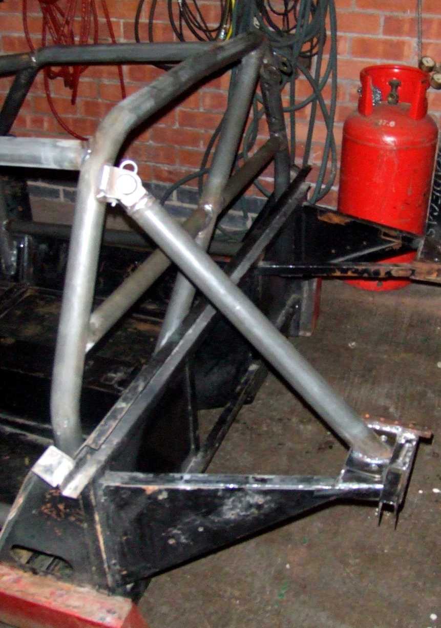

Have seen these pictures, ok for a single seater set up and probably approved for sprinting. Wouldn't pass scutineer for rallying though probably ok for other discipline? The RAC would not aprove a second bend at the cill hence my mitred tube connection at the feet. Not sure about the bends in the door bars either. It's not a 'Mini' at the back so the rear struts are going to some other location than the top of the subframe tower.
I tried very hard to get the RAC to agree to putting the rear struts through the body not the window but they said NO. I do have two very nice grommets to go in the rear window :!: :!: :!:
I am retaining the door pillars but have cut them and will internally sleeve them with cross bolts.

The cage pics i posted are of a msa approved cage for hillclimbing/sprints so no doubt there are differeances in rally specs.
the rear diagonals are joining to the top of the spaceframe in front of the mini tower mounts, the car still uses a mini subframe althou heavily modified simular to mine.

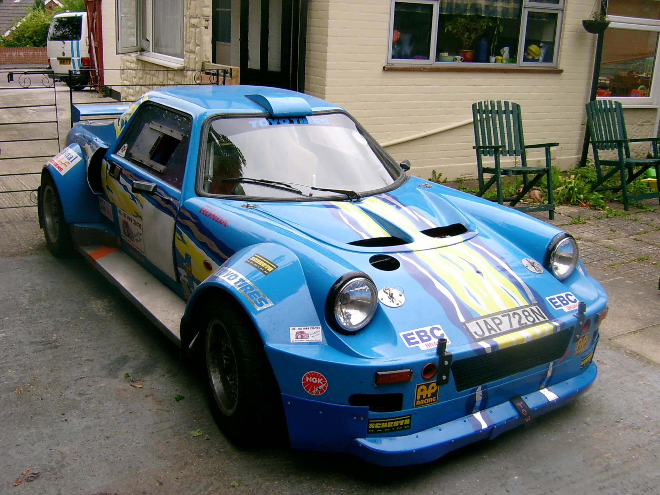

Happy new year to you all,Please veiw my site http://www.gtmhonda.co.uk
195bhp B16 that sorts them out.
2008 ACSMC TARMAC championship winning car,just email i may be able to help. :lol:
