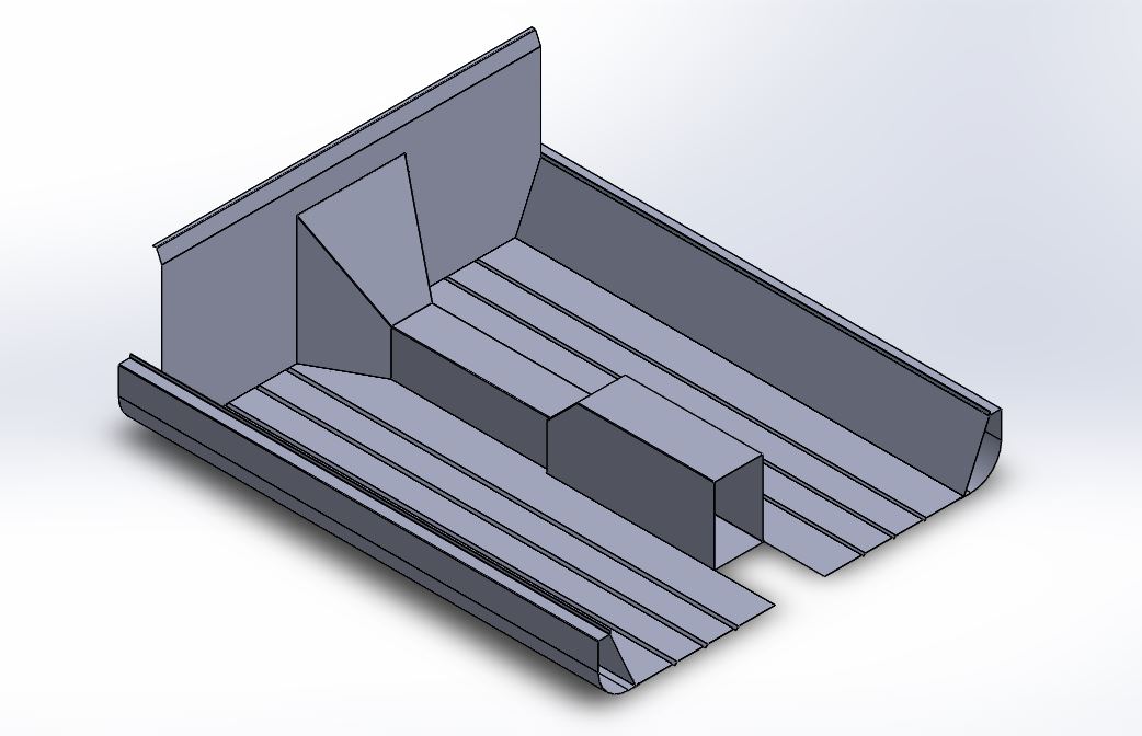

Went over to get the rear suspension off my GTM on the weekend, and also did some measuring. most of it is quite easy to do but the front is a bit more tricky, mainly because the floor to front bulkhead junction is rusted away! may need some help with that bit, quite pleased with progress in Solidworks considering it is only 2 evenings work.

Looks nice.
Did you measure it or did you get the dimensions somewhere?
How thick is the sheet?

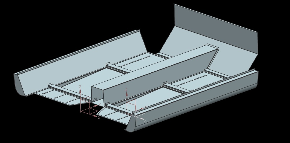

Show me yours and I will show you mine :roll:
Mine is done In NX and sheet metal meaning I can unfold it for templates, Modelling all the joged edges and getting the split lines to work for drop down seat pans so that they are foldable has been bit fiddly

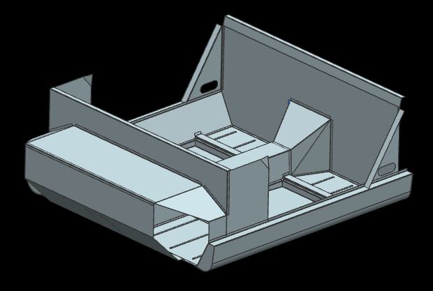

Thought I would bring an update, finally had a bit more progress.
Ta Da
Getting my head around the triangular transition from bulkhead to tunnel caused a bit of thinking due to the tunnel walls not being vertical. Getting it to model in sheet metal was a bit of a pain but it unfolds on the computer now, need to add a couple more details and tidy the flange transitions a little.
The front wheel wells should be fun!
