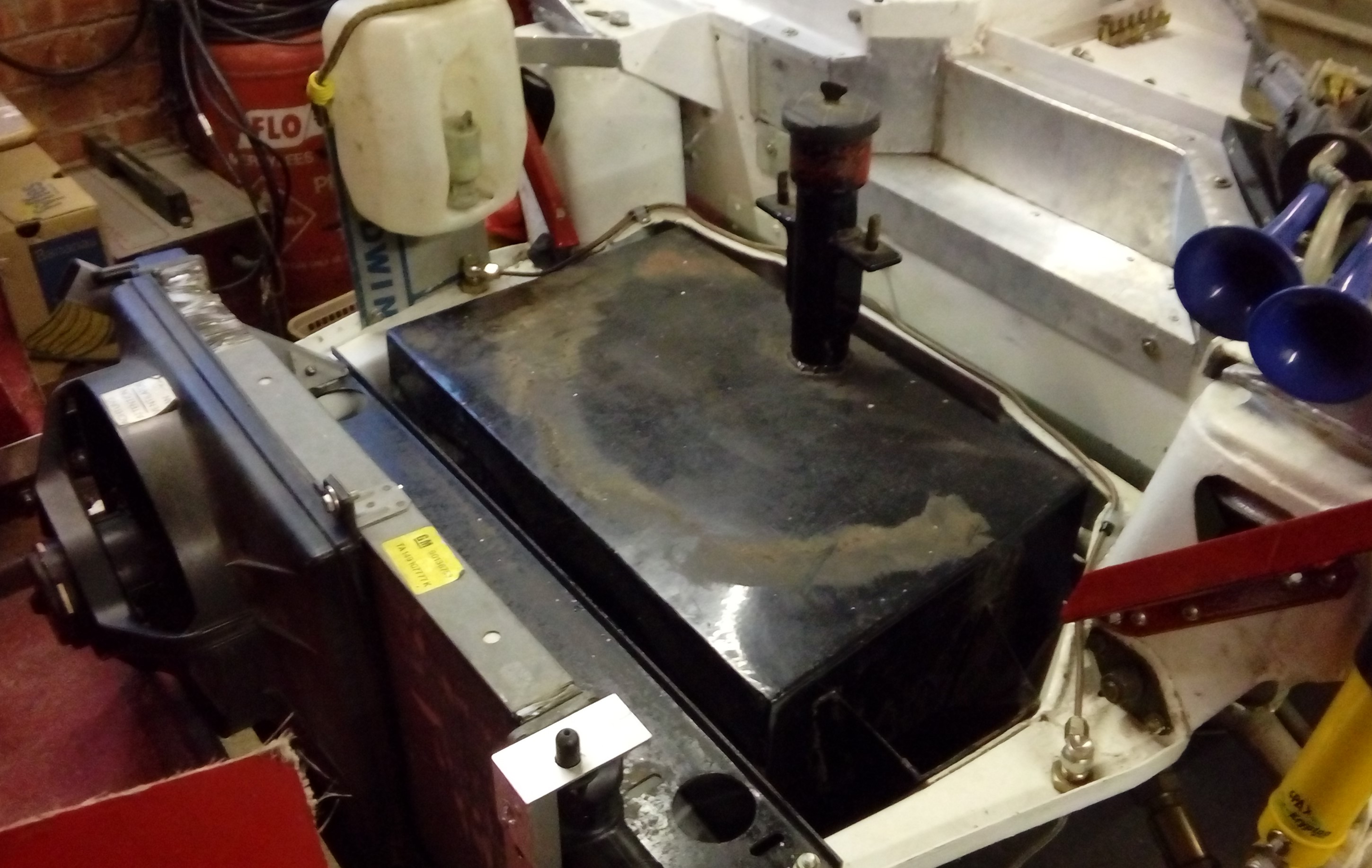

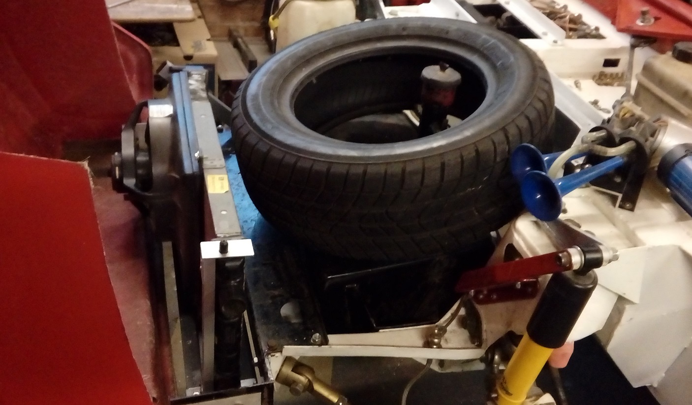

Ive got one of those chunky steel items though its going to need some modification. I want to carry a 13 inch spare wheel which will fit in the front ok but I could get a battery down there instead and get some better air flow over the rad if the tank gets relocated elsewhere. Its more trouble trying to shoehorn the spare rim in the back. The tunnel isnt really practical for me as Im A series and need the room for gearstick and the rest but agree that its the best theoretical location for COG. How warm does it get between the engine and the rear bulkhead? Would suitable heat shielding be the solution?
Apologies for big images, will try harder next post.

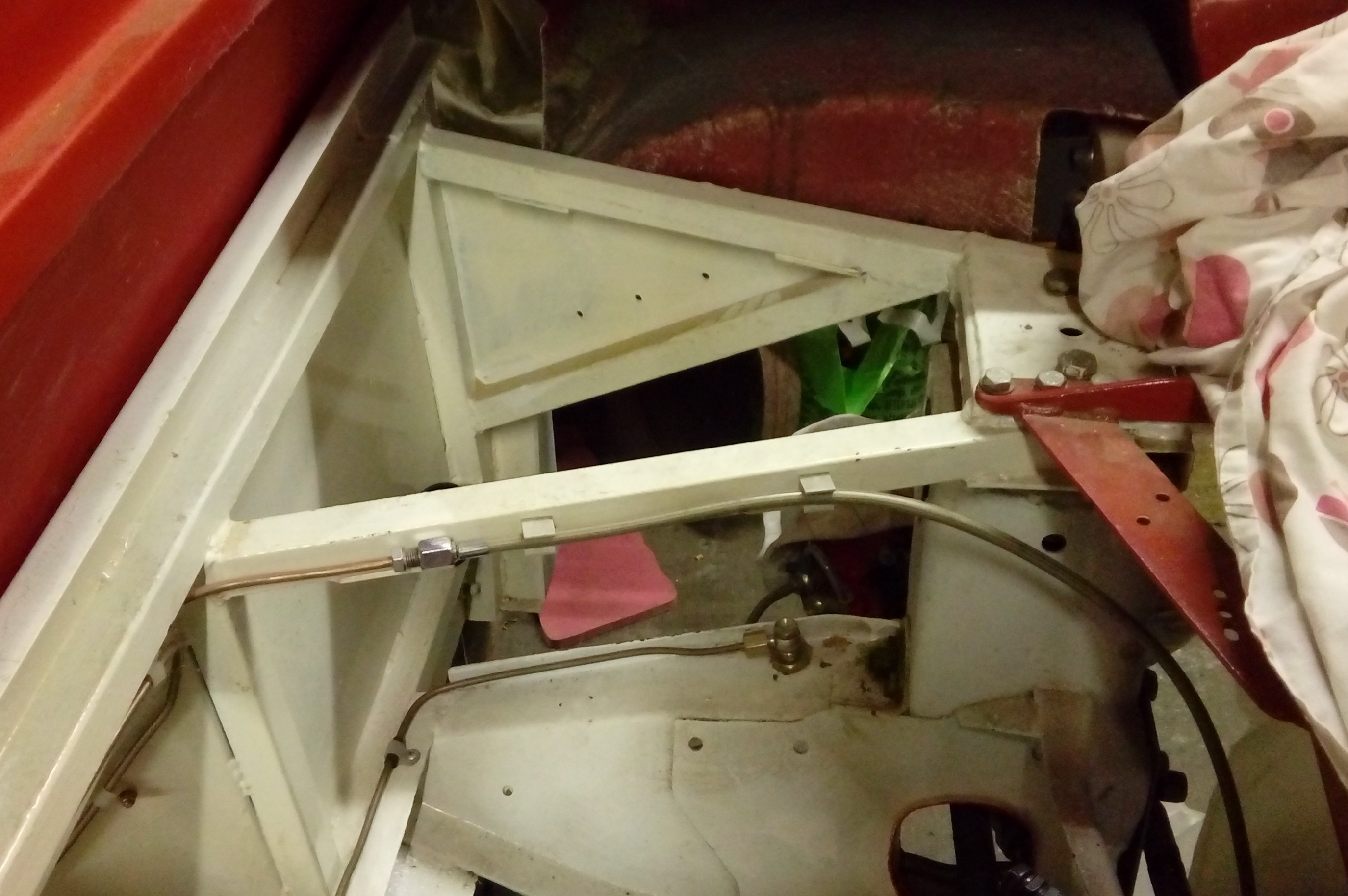

Hi John, having tried to think of a car with a tank near an engine I cant come up with one a a precedent so I think this might be project for a braver builder than me. I did quite enjoy your thread on your rebuild, Im thinking Davies Craig water pump as well. Back to plan A: To get the 13" full size wheel and tyre in place Ive cut a bit out of the bulkhead. Its a removable cover so I can get to the back of the pedals and other gubbins. Im having another look at the shape of tank to go for and will look at getting one made. If I look at having the battery location on the front subframe passenger side I can design in enough space for it I guess.
