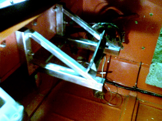

Post Re: Steering Column Bracket
Tim
one word Triangulation
How i did mine, An early development picture taken with the cheapist digital camera known to man, you get what you pay for in quality :roll: it did the job tho.
also my pedal box mounts off it, so its all nice and stiff, thinking of stiffening it up even more possibly in the future., the horizontal tubes run all the way under the bulkhead and bolt up to the pedal box the tubes finish about half an inch short of the front bulkhead

Wed Jan 21, 2009 10:35 pm
Neil,
Almost exactly what I was going to do. I think I prefer the idea, rather than having the frame all the way across, as I can't see where it would get the strength from.
I'll have to get my bracketry sorted out, so I can keep pushing with the car.
