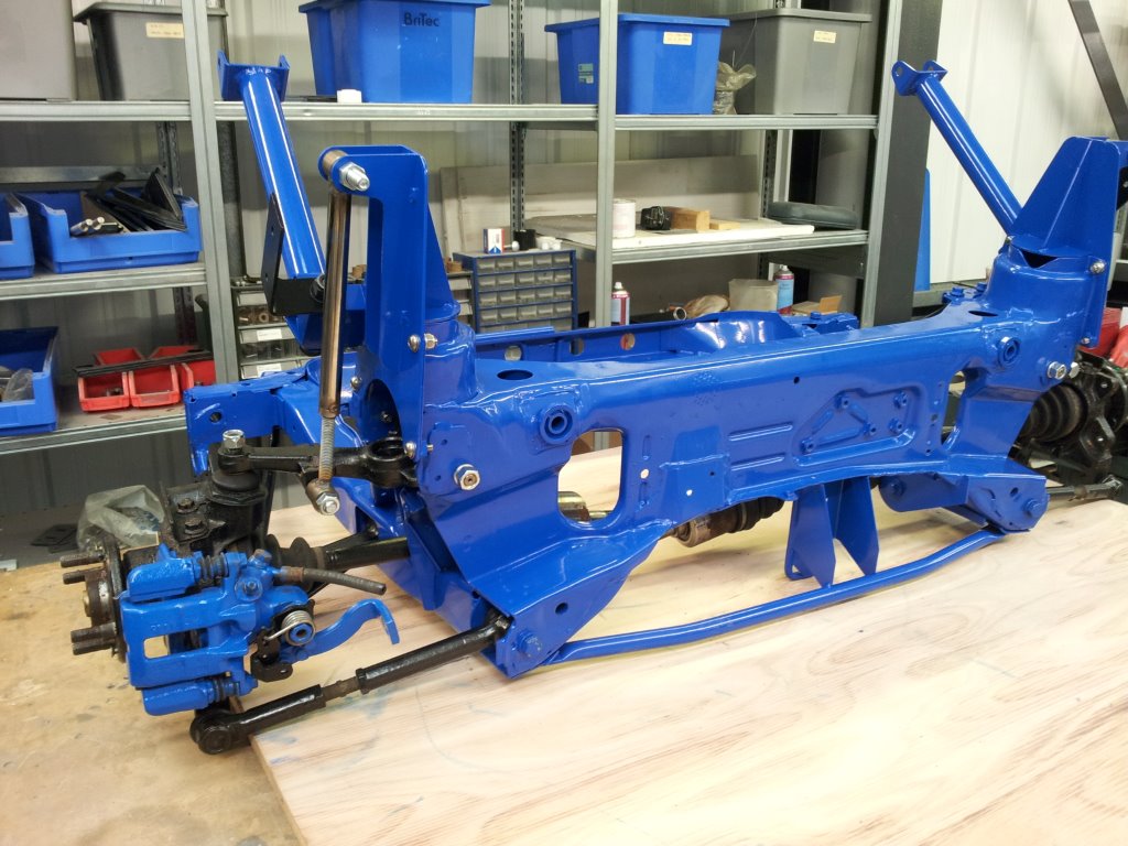

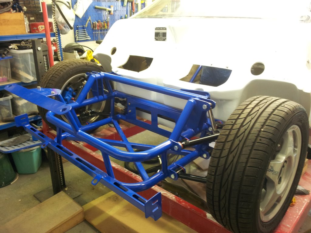

Not sure about the turbo engine, there isn't much space available to the bulkhead, if the turbo is low down then maybe.
I dumped the front subframe so that I could have coilovers and double wishbone suspension on the front, see pic, and made some retro fitting brackets to fit the existing rear subframe converting that to coilovers. It is an MGF rear subframe, basically the same as metro so I will be using stock MGF rear end. I just wanted to lose the hydragas and have some adjustment.
Peter.

Cheeky Peter
Good to see someone doing something a bit different with a K3, I am liking the front frame

Thats a nice piece of work, looks like a nice big garage too. :)

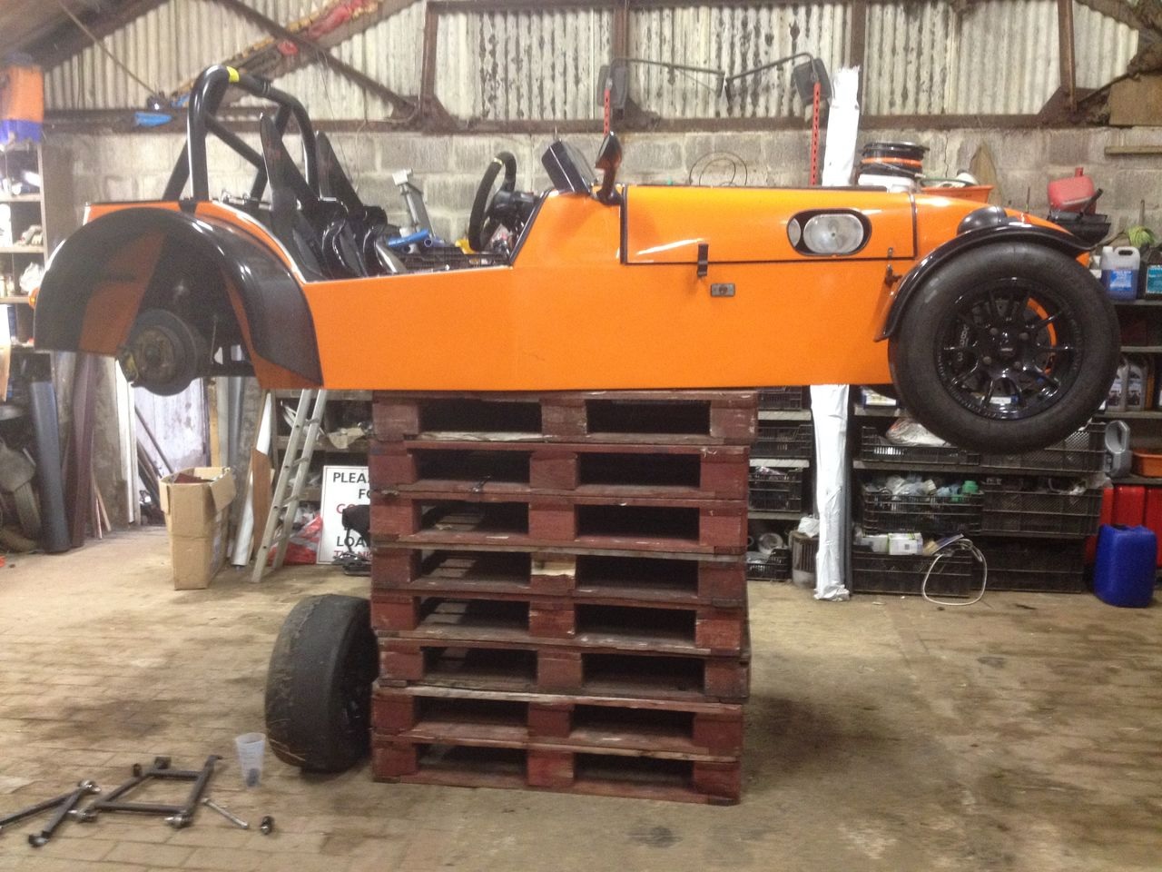

Post Re: 1.8 Turbo engine in K3
You should see his nice home made 4 post lift all good stuff :wink:

Hi PEEPS,
Do you have any idea of the weight of your new front subframe?
For that matter, does anyone know the weight of a MGF subframe?

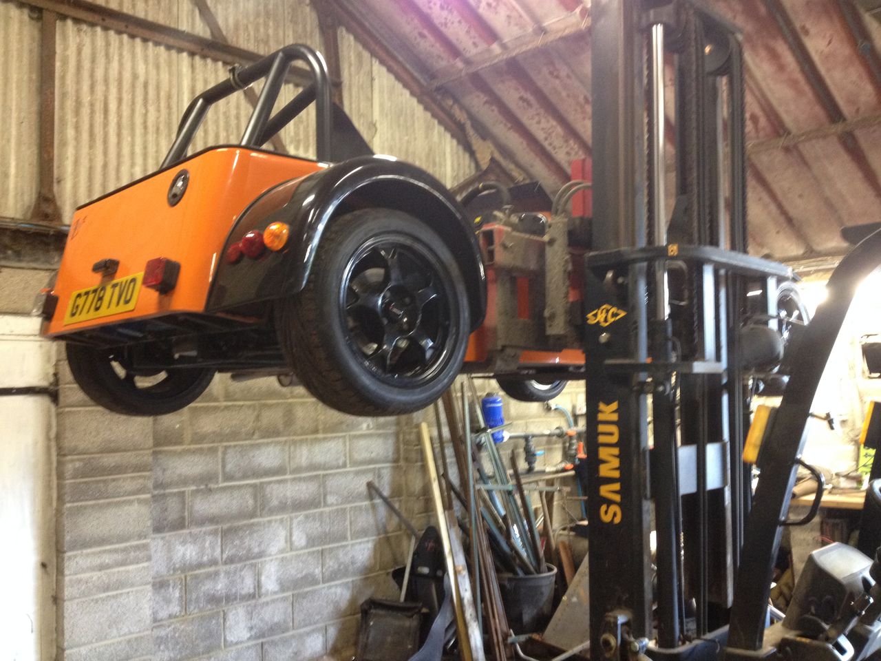

Is it as good as this one:

The MGF subframe weighs 29 kgs approximately and the tubular one weighs 23 kgs.
I just wanted adjustable wishbone suspension that would use the same mounting points.
Peter.
Peeps 4post is much easier to adjust :lol:
The attachment Eds car lift.jpg is no longer available
This one's pretty easy too:
Apologies to Ed - I stole his pictures from the BKCC forum...
I only use my forktruck on my mini, too many elf an safety issues! :wink:
