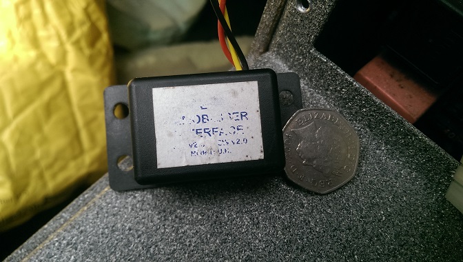

Immobilizer interface - I don't have a fob but this apparently talks to the ECU to deactivate it?...

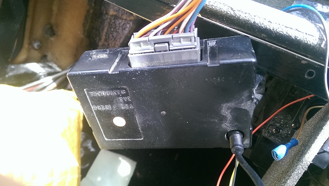

Immobilizer (I think?)

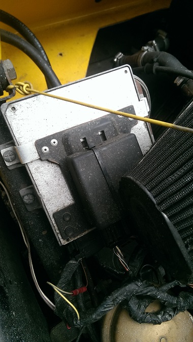

ECU - wedge type (VVC 160 engine) - what's the back box that attaches to it?
the black box has 4 relays in it they are for the fuel pump / oxygen sensor / main relay / starter relay

i think this is right If its a 3as alarm type, ( single button fob), then
its only immobilised on the starter signal, it looks like you have the 3as alarm type in the photo but you have a mems3 ECU - wedge type (VVC 160 engine) - wich needs the later 5as type, (2 button fob), and matched alarm and fob. the 5as sends a signal to the mems3 ecu
you don't have a 5as alarm so your Immobilizer interface must talk to the ECU to deactivate it?...
or you have a un-coded ECU
hope this helps

Paul could be on to something with the inertia switch - they cut the supply to the fuel pump. The 5AS immobiliser also cuts the fuel pump supply but IIRC only after it starts i.e. it spins (you hear the whirr and then stops when it gets up to pressure before starting) but then it doesn't come back on after starting without the ECU handshake. It cuts the earth to the fuel pump though so you can get around that by simply running the earth for the fuel pump straight to a convenient earth rather than via the 5AS - less protection but less to go wrong!
I'm pretty sure the mems 3 should need the 5AS but your pic seems to show the 3AS so maybe the first interface box is a get around for that???
