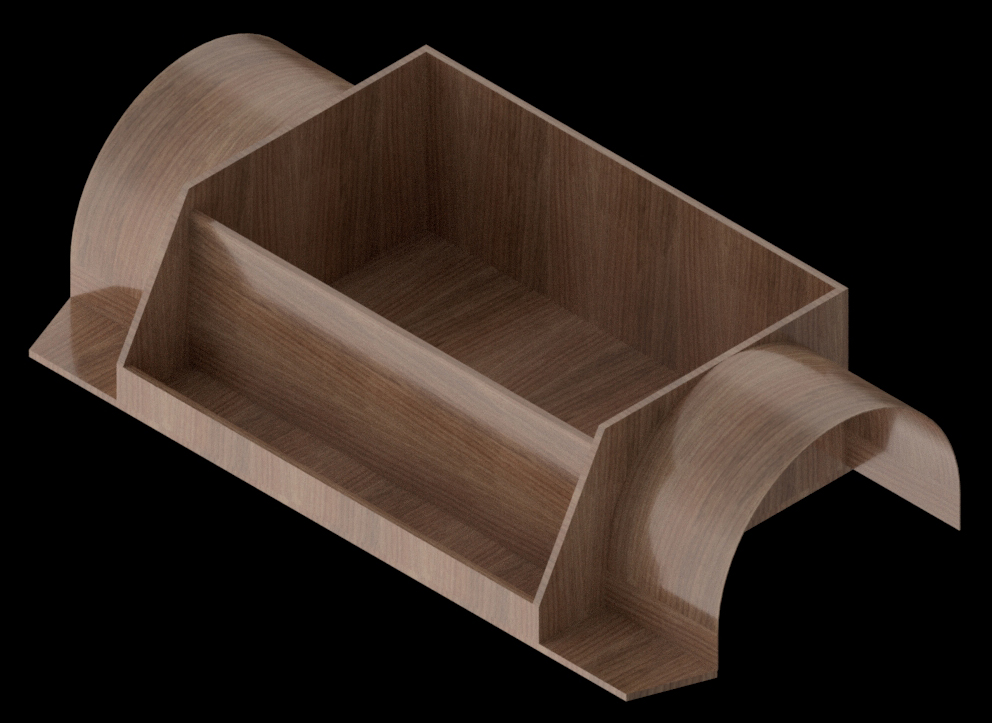

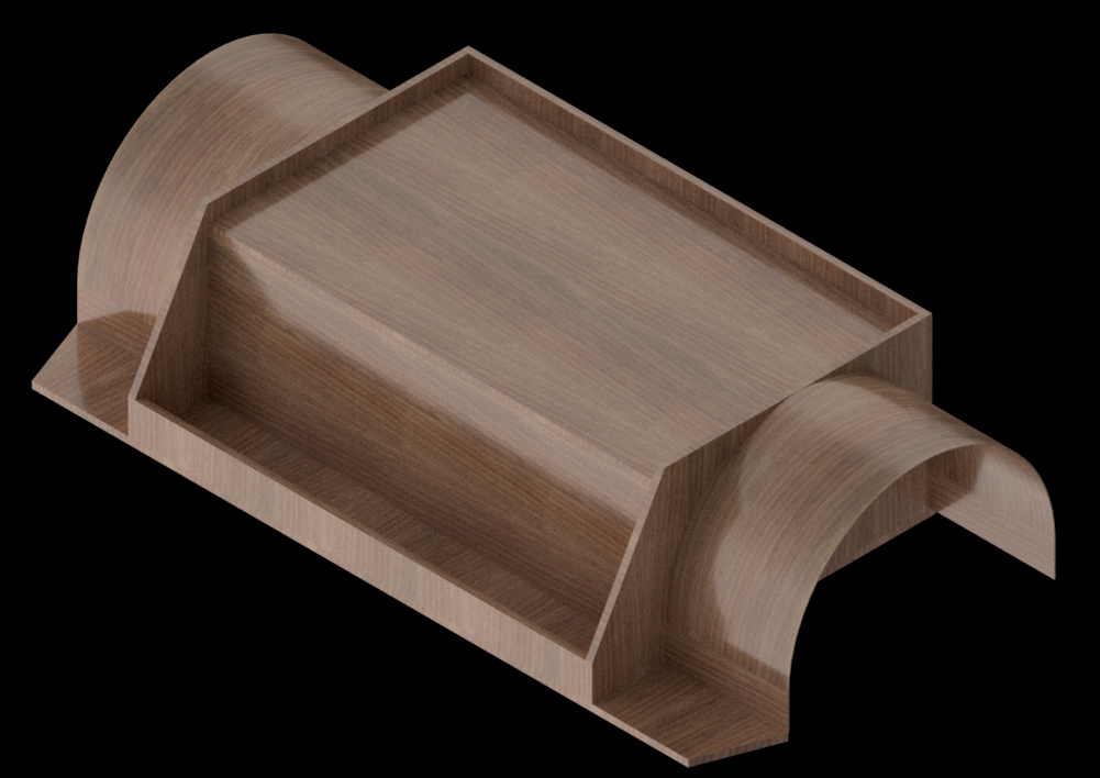

The 2 images are the simplified front sub frame proposal. The 1st one has the top removed to show the space which could be used for fuel or battery pack. The space could also be used as storage.
The second image shows the box section sealed off and working as a structural member.
The wood texture is used to get a better appearance of the set up, it would be made in a number of different materials to make up a composite panel which could be as light as 10kg with a target of 15kg.

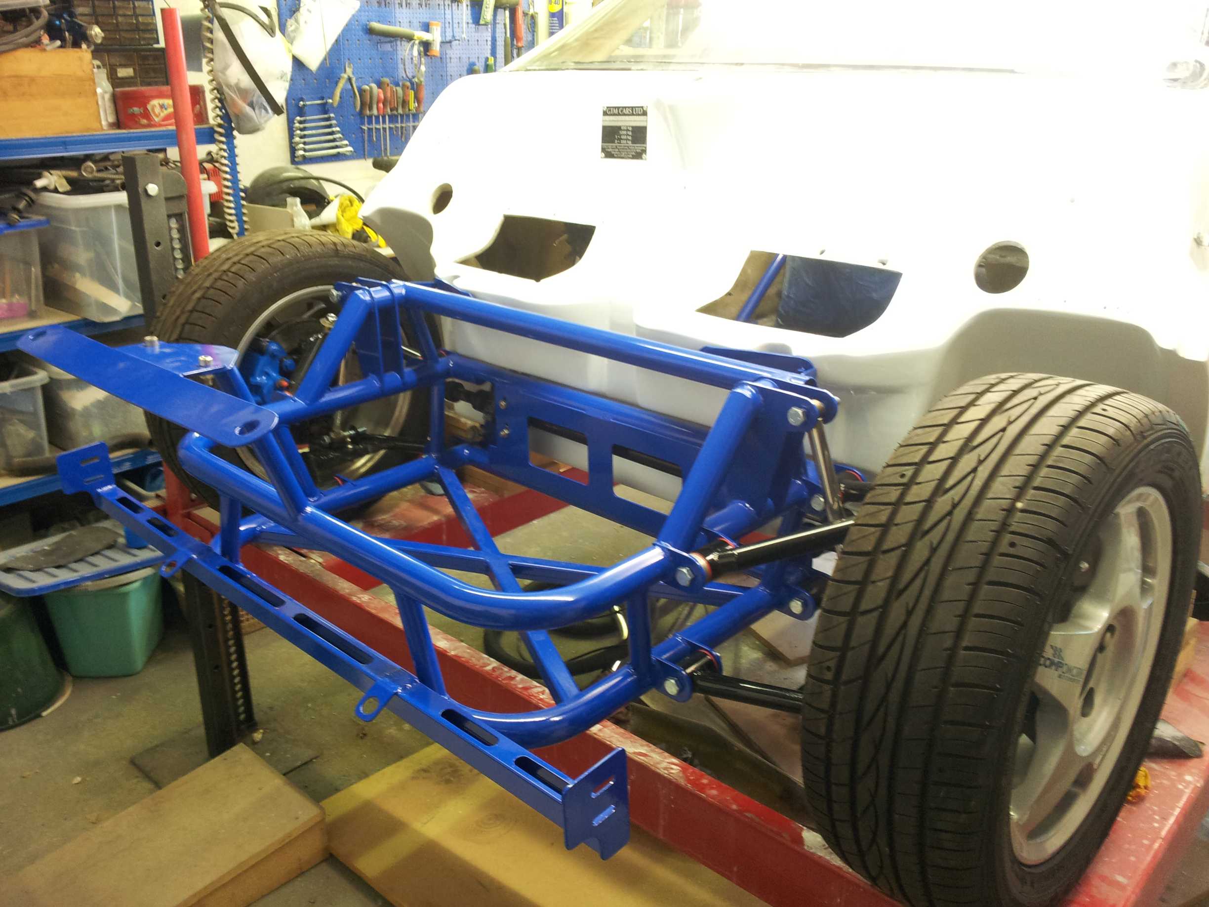

Hi Here is a picture of my replacement front subframe, made so that I can dump the hydragas for coilovers. It was made from thickish tube and ended up around 5kg lighter than the metro one. I also made my own wishbones and retained the metro hubs.
The second picture shows it fitted to the tub, (original mounting points).
The last picture is of the MGF rear subframe, it does need a couple of brackets grinding off and engine and gearbox mountings modifying. As shown the rear suspension is different to the metro in that it has a trailing arm, a control arm and the original top arm. I understand that the TF subframe is different to this with a bigger trailing arm etc. I converted this one to take coilovers as well with retro fitting brackets. Also with the TF subframe you will need to devise a bracket arrangement to attach the torque tube to that comes from the tub.
Hope this helps,
Peter.

Nice but a whole level of skill don't have!!! :cry:
Have you settled on a spring/ damper set up that works with your brackets? and do they work on the front as well as the back. Is your car for road or track?
ps sorry to hijack the thread with other questions.
Mon Jan 09, 2017 2:36 pm
Post Re: K3 changes to the car suspension and drive
Hi Malcolm,
Check out Olivers post "coilover dampers" to see more of what we are trying to achieve. I used GAZ 13" adjustable dampers and coil springs, 200lb on the front and 300lb on the rear. Having corner weighted the car they seem ok but I need an mot on the car next to try them out.
The brackets fit on the front or rear of either metro or MGF subframes.
Peter.
