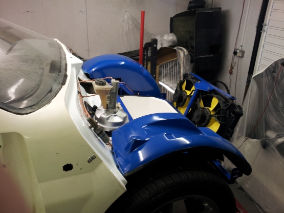

Rich, Here is a picture of an MGF radiator fitted under the front clam of my K3. Although I have made my own front subframe the location is probably easy to bracket off the metro subframe. The bottom edge of the radiator is level with the clam pivot points and it slopes forwards at the top. It clears the clam by a good two inches at the top. I did have a picture somewhere of it in place with the clam down, I will root it out. Peter.

Just as an update, I've now done this for myself and found that I've got the radiator in upright just by adjusting the standard mounts and using alloy cross bars to mount the MGF radiator using it's standard mount points and rubbers.

Paul. Hi Paul, Sorry, I missed your post. I kept the radiator upright by lowering the lower mount, basically bolting a length of alloy angle below the mounts and fitting the radiator to that. I cut the top mounts off and made a new one from alloy sheet that fixed to the storage tub. Unfortunately I didn't take any pictures with the front off, just this one from the sales thread.  You can see the top mounting I made.
