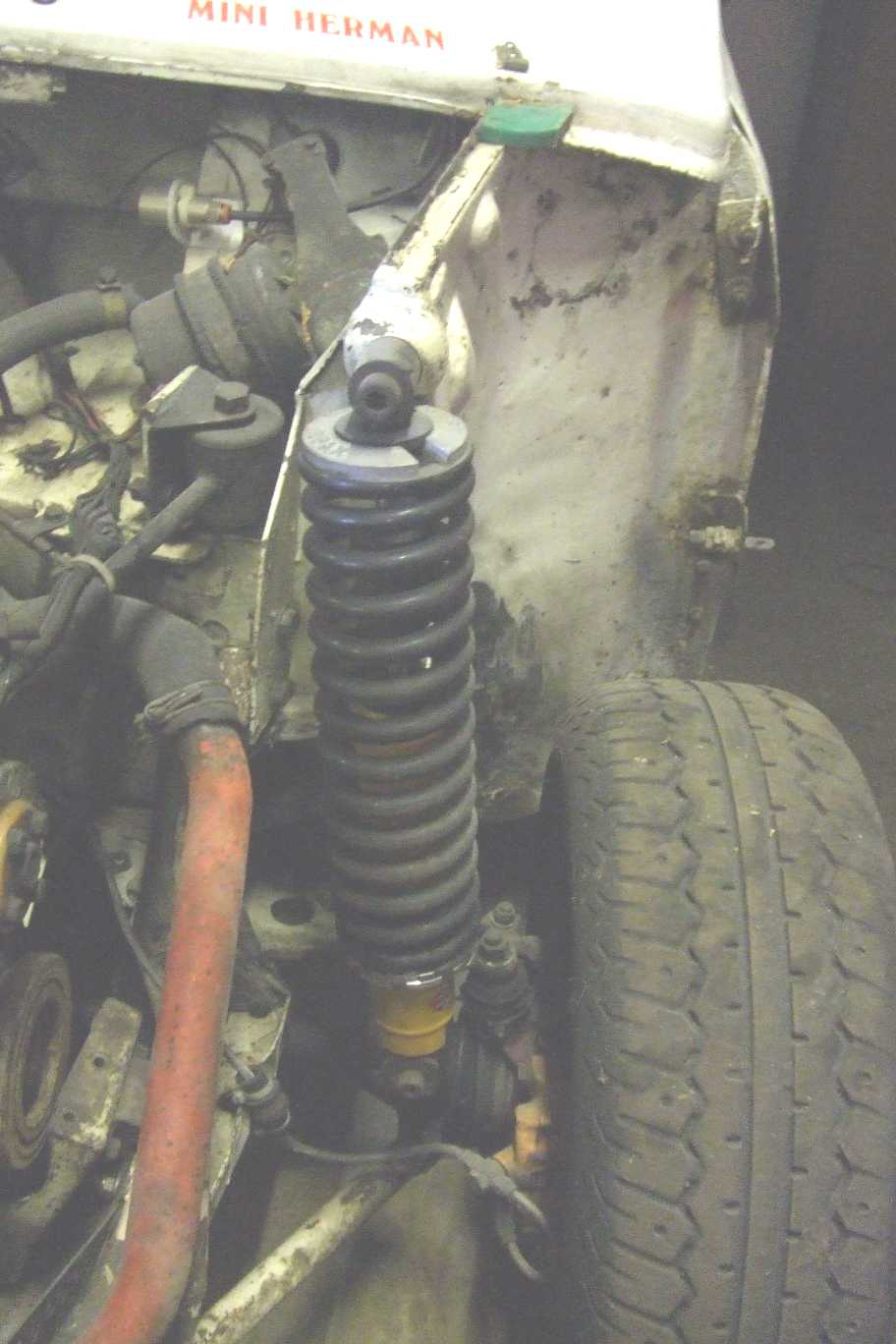

Post Re: coilovers on a Coupe
the other Tim wrote:
As above, pro's and con's, 1.9" or 2.25" and whats the ride quality like :?: :?:
I converted my Mini in 1991 when there was not as much kit around as there is today. 2.25" meant there was much more choice. I opted for spax on price and reputation, you do not have to buy springs from spax, there are plenty of spring suppliers about and nowadays you can get dual rate springs which is seriously worth considering if you push the car to any degree but still want 'down to the shops' comfort. My overall experience of coilovers was that it changed the mini from a go kart to a modern comfortable car and allowed easy set up of corner weights.
At the front of the mini, there was the issue of clearance (have 13" wheels) hence the top mount was fabricated and welded to the body. With the GTM it is a similar simple case of fabricating a decent bracket to attach securely to the car. Looking at the GTM, the body work I used on the Mini was not available on the GTM so rather than jump in and develop this mounting, I have elected to stay with rubber cones for now but that is not to say I wont be looking at going coilover in the future.
Spring rates we calculated were 275lb front and 120lb for the rear. These were ok in fact they were wonderfull on the road and on bumps but when the car was pushed on tarmac circuits, there was a bit too much body roll, I would go for 350lb next time or use dual rated springs (damn the expense). The moral here is you ought to consider adding a percentage uplift to the calculated rates if you are seriously pushing the car.
Another piece of useful information we learnt was the bottom mounting. Our Mk1 suspension sat on a plate located on the bottom arm which all looks nice and tidy. The coilover put too much stress on the bottom ball joint which exploded on me during a road rally. The Mk2 suspension now picks up on the standard shockabsorber mount. We use a new HT 12.9 bolt and torque correctly after every 6 or so events and we have not had any trouble. Hope this helps.

Oh peter any chance you could edit your post with a smaller picture as its a little large :wink:
