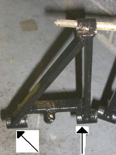

Hi All,
Can anyone help me, i've got the original GTM lower arms which need new bushes in the ends that join to the rear wheel hub. Anyone know what bushes to use? I was going to fit Mini lower arm ones all round but they are a wee bit big for the hub end. Any ideas?
Marty

I think there's mention of this somewhere on another thread -- opinions seem to vary between MGB or Austin A60 spring eye bushes -- might even be the same as an MGB is an Austin A60 cabriolet.

Thanks Steve, these them?

I made my own from 1" diameter polyurethane bar.
I have the dimensions here too but these were drawn when I was going to use nylatron.
As you can see from the photo I made them in one piece rather than split and I didn't bother with the flange on the end but the dimensions are the same. They were basically polyurethane copies of the original bushes.

Suspect the two smaller diameter bushes are innner lower wishbone bushes from triumph herald/spitfire /vitesse family whereby they will be available as plastic - I know the single bush is mini .. regards

We've just done this job too - we used Mini polyflex bushes turned on a lathe to the right size - they are now a good fit and it has just flown through it's MOT!

If you use the 1" Polyurethane rod you don't have to machine the O.D. at all. You only have to drill the hole for the bushes.

This is what I used.
http://www.superflex.co.uk/sprods.php
I think I used the 80 shore hardness.
I used stainless steel inner sleeves with a little silicone grease on them.

The Bushes on e-bay look right but I'd check dimensions with the seller first -- in any case if you've access to a lathe the poly bush suggestions are a better route especially for durability.

I'd just add that it's a good idea to check the actual dimensions of ALL four housings!
Three of mine were one size and the forth was significantly smaller. (they were all less than 1" BTW)

No access to a Lathe sadly, i order the bushes on ebay, hope i can make them fit! :lol:
