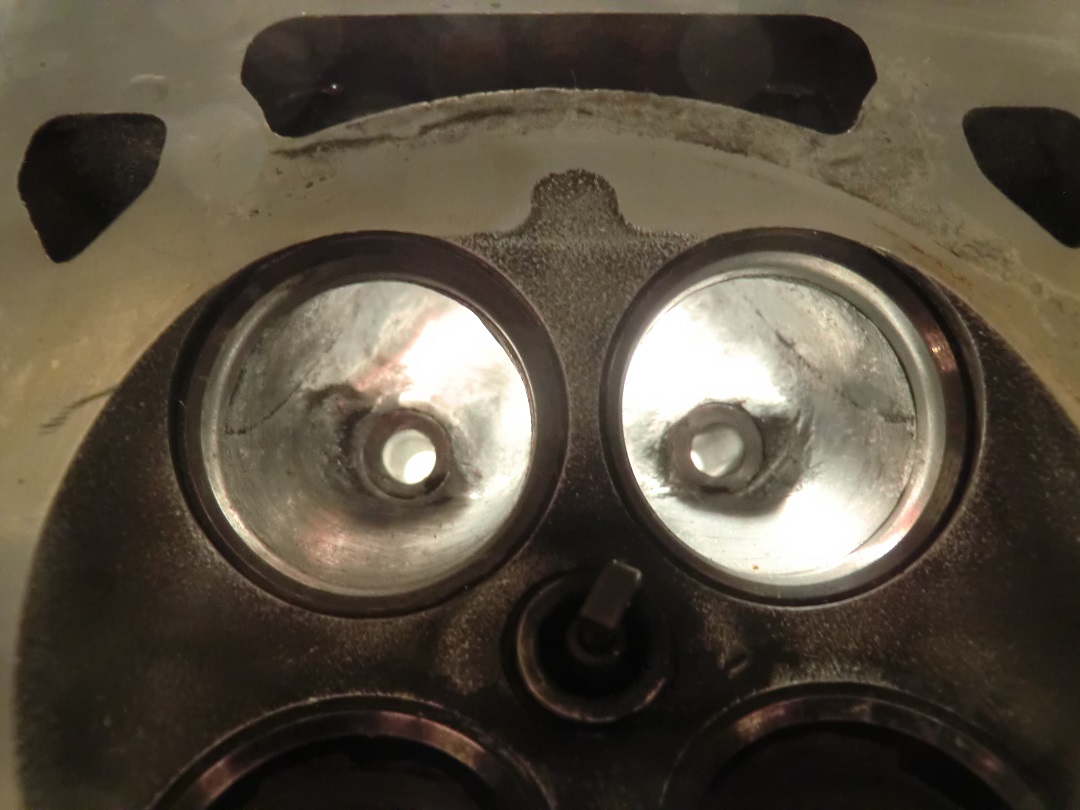

Well, I'm finally making some progress with my engine. It only took me 5 months to move it from the pallet to the shed so the progress since then is flying by comparison.
I got the head off a couple of weeks ago and have now managed to get a bit of port work done. It's my first go at this so was a bit nervous but wanted to give it a go and having looked at lots of pics and vids I thought "how hard can it be" Decided to go for a basic removal of the rough bits with just a small amount of metal taken away around the valve guides and bifurcation. The valve guides were chipped with some biggish chunks missing, especially on the inlets. No sign of where the bits had gone or any damage from them having rattled around in the combustion chamber so I wonder if they were chipped while being installed. Whatever, the pics I'd seen of peoples porting projects had all shown the guides ground back to the alli so that what I did too. Here are a few before and after pics. Not sure how much benefit it will give but it was quite fun having a go.
Exhaust - before: (I'd given the right hand valve a bit of lapping before taking this as this is the cylinder that was down on compression. Seemed to lap up okay so all will be lapped as the next job.

Inlet - before, note chipped valve guides:
