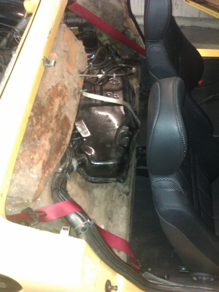

The rear bulkhead timber work has been remove in preperation for tidying the wiring and fitting a propper fibreglass cover:
A messy bulkhead to tidy up:

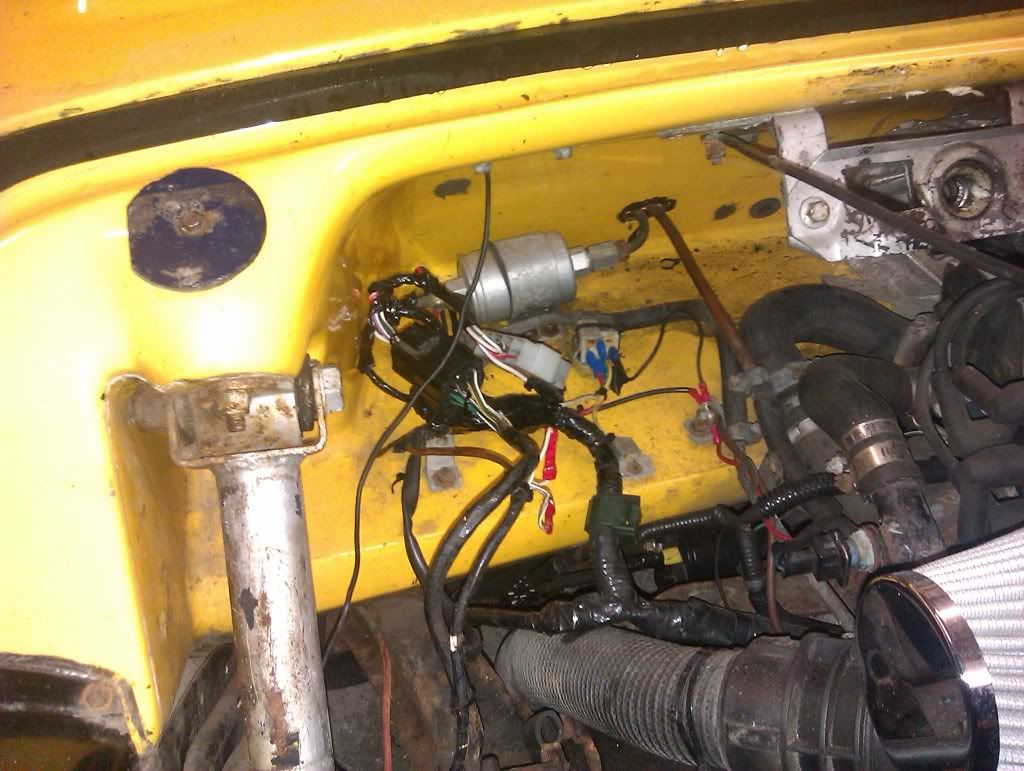

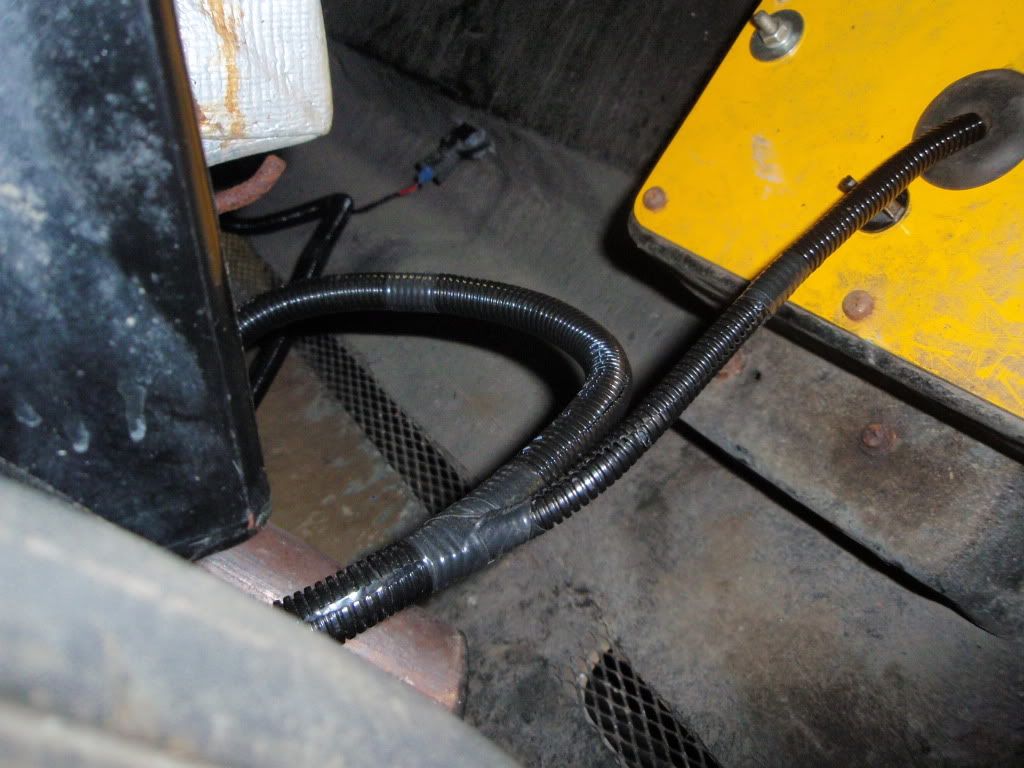

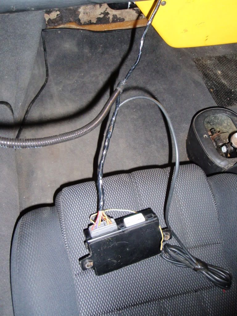

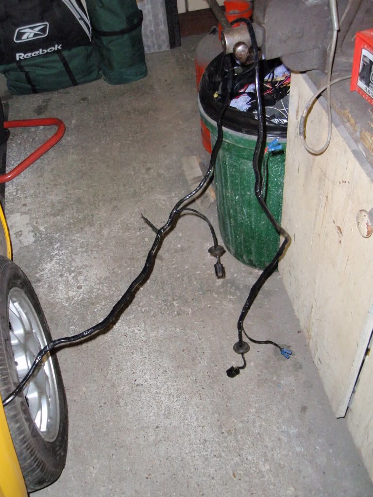

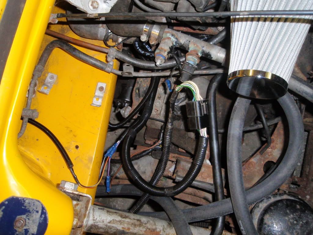

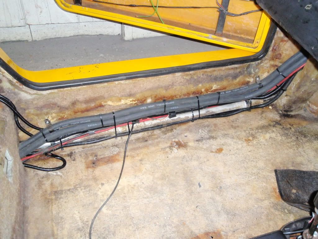

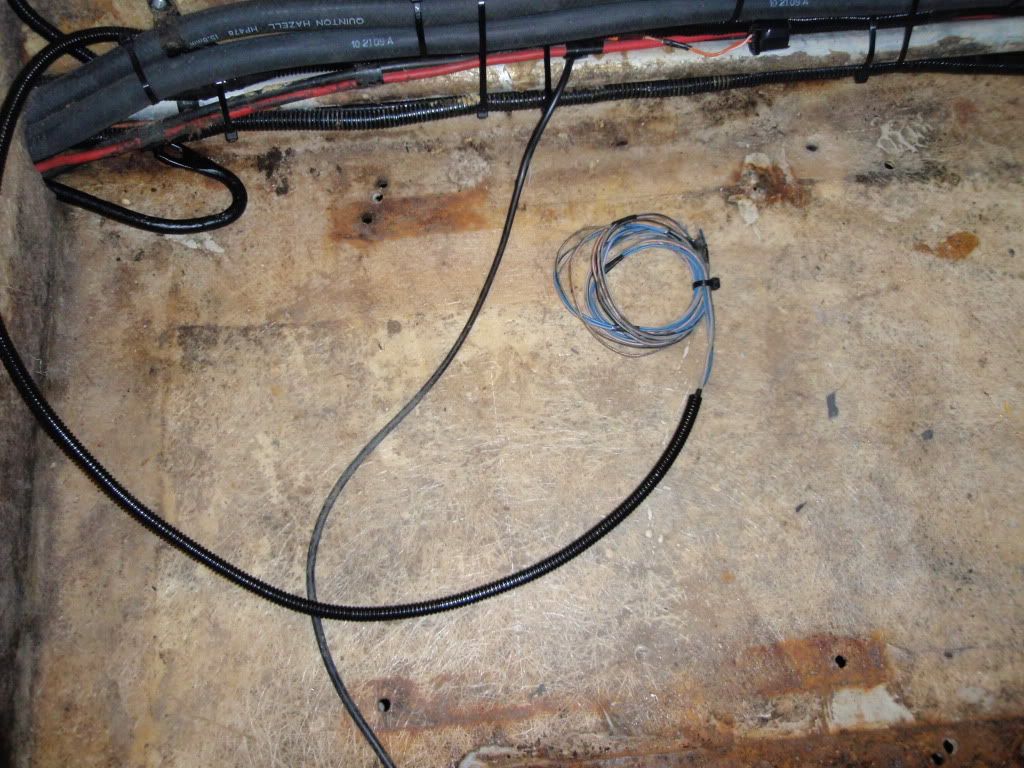

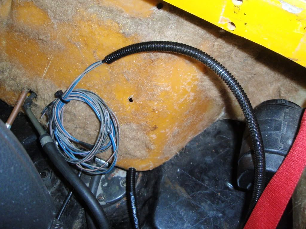

Quite a few hours were spent staring at wiring diagrams, finally got it running again. The fuel pump is now controlled by the ECU as it should be, multiple wiring faults were tracked down and rectified, the wiring has all be re-wrapped and protected with convoluted tubing.
And i now have speaker wires in the car, as there were previously taped up in the loom and finishing up in the engine bay.

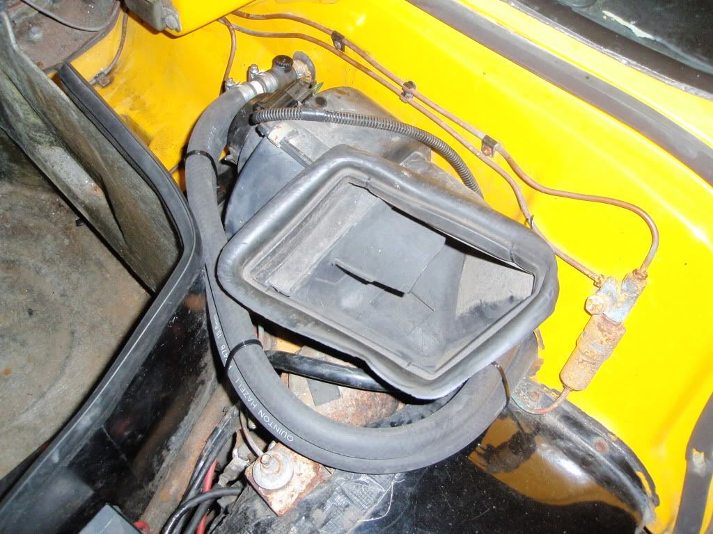

Fitted 2 new lengths of heater hose aswell, as the old hose had been rejoined in numerous places and was starting to perish.

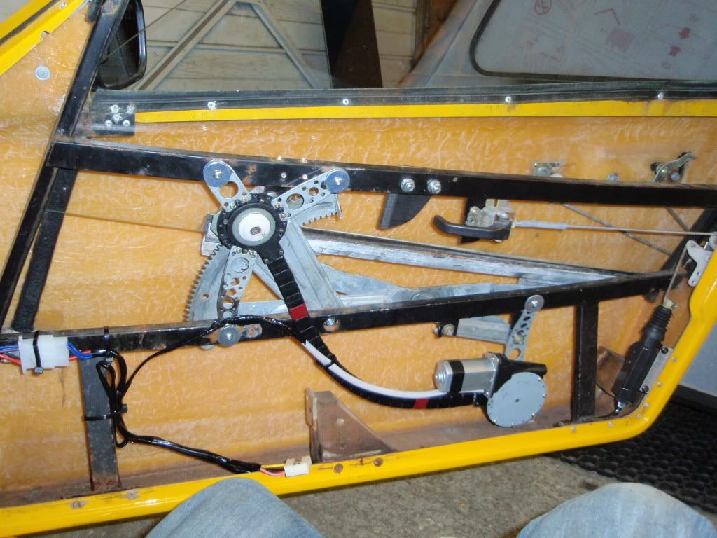

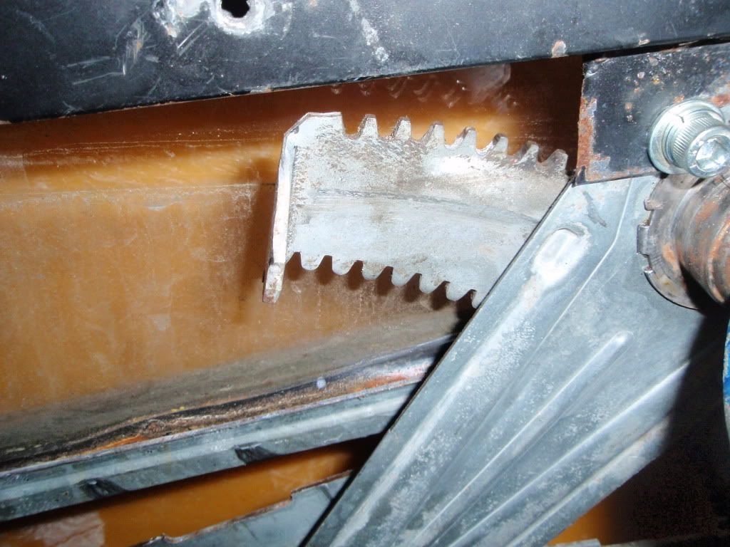

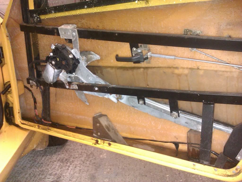

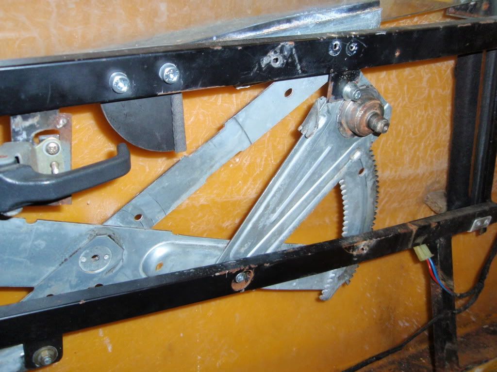

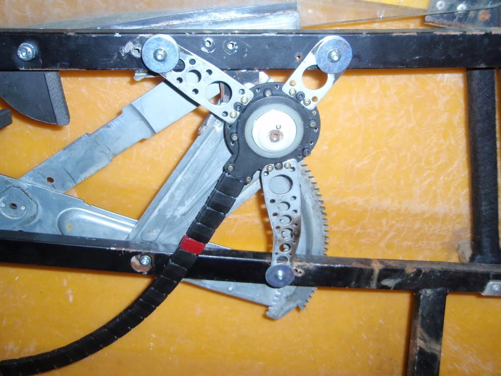

Window regulator has been replaced with manual versions ready to have a new motor kit fitted.
Rear Loom:
Wiring inside car.
Engine bay wiring:
Heater hoses:

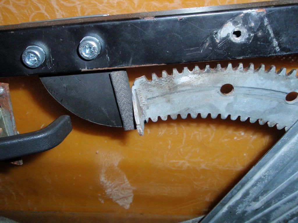

Window regualtors, with new brackets to stop the window travelling too far in each direction:
Will be using one of these kits:

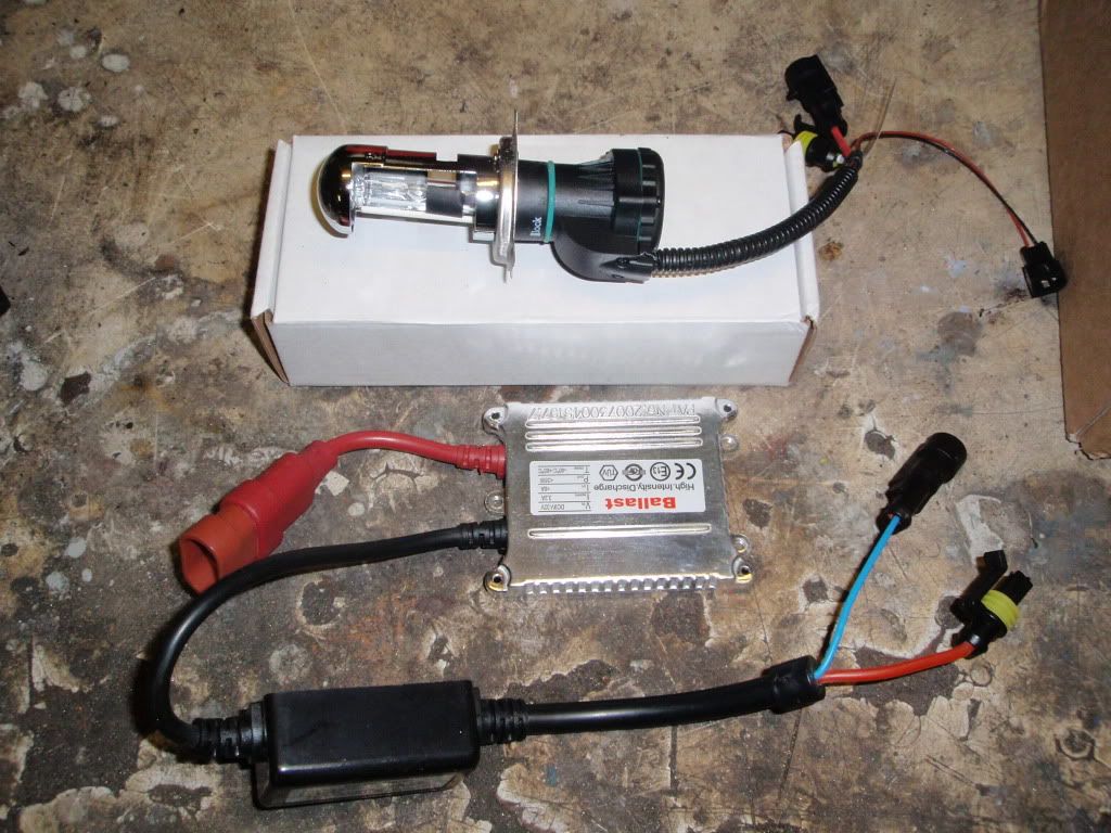

Also have some HID's to fit:

Looking very good,
I am sure the HIDs are illegal, unless fitted into a headlight unit that is suitable for HIDs (correct beam pattern), the car has self leveling headlights, and they must have washers.
You will fail the MOT unless the light pattern is correct.
The document is here; http://www2.dft.gov.uk/pgr/roadsafet...headlamps.html

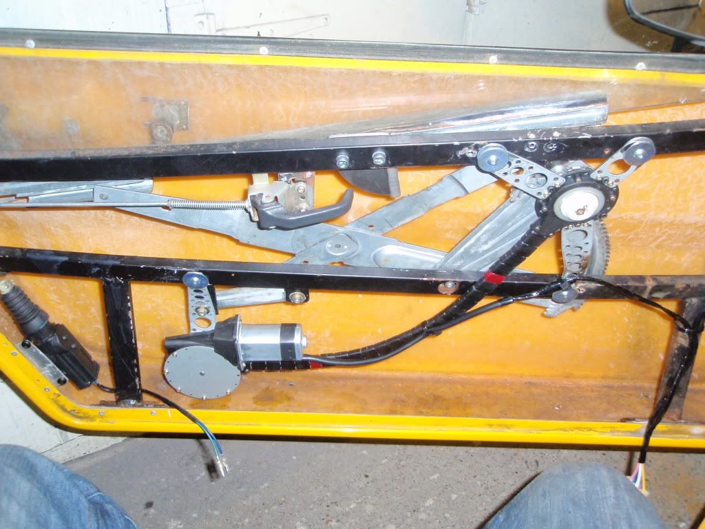

New central locking solenoids and electric windows fitted and working very well, the kit was very simple to fit and seems very good quality:

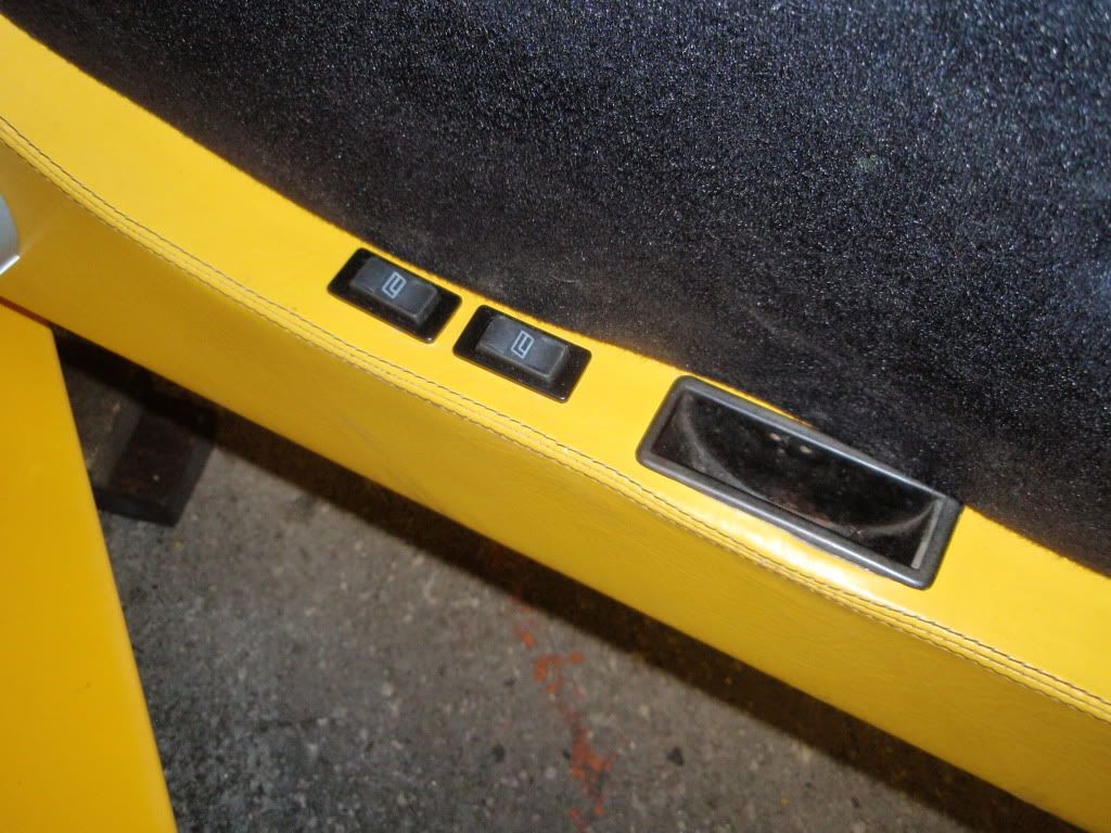

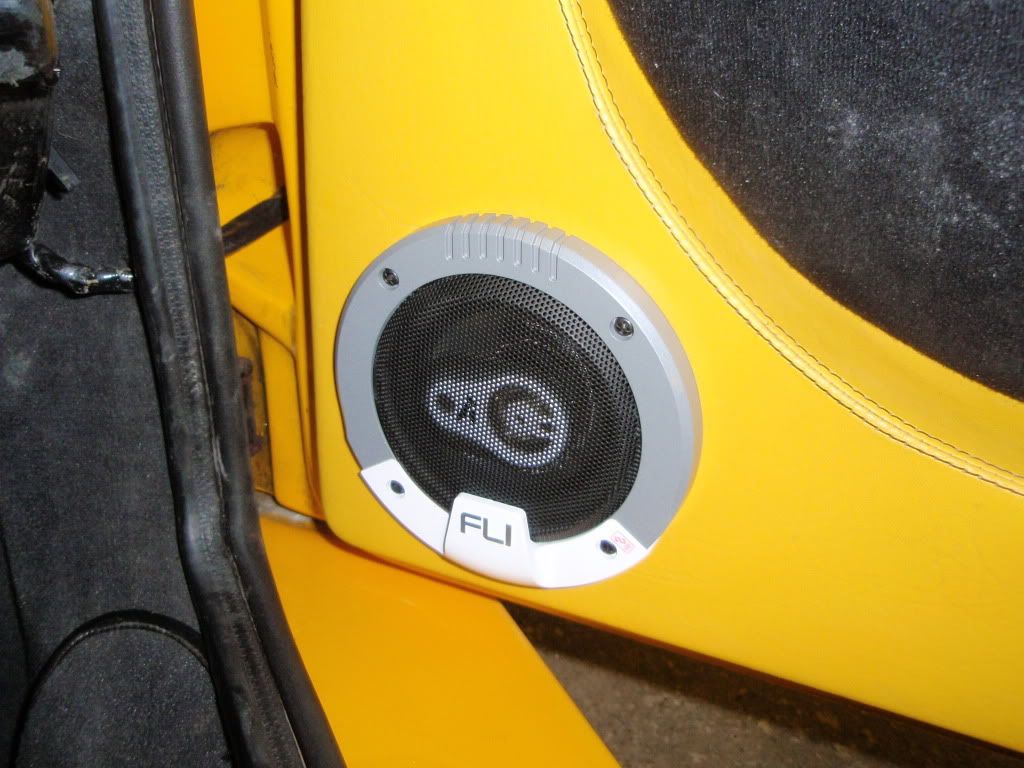

Speakers and window switches fitted:

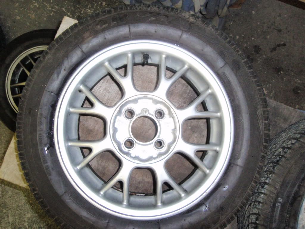

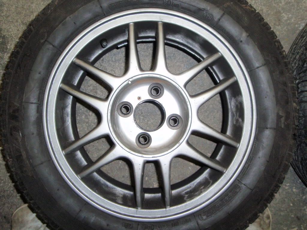

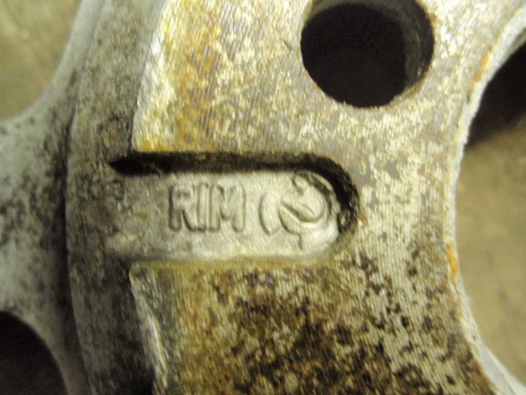

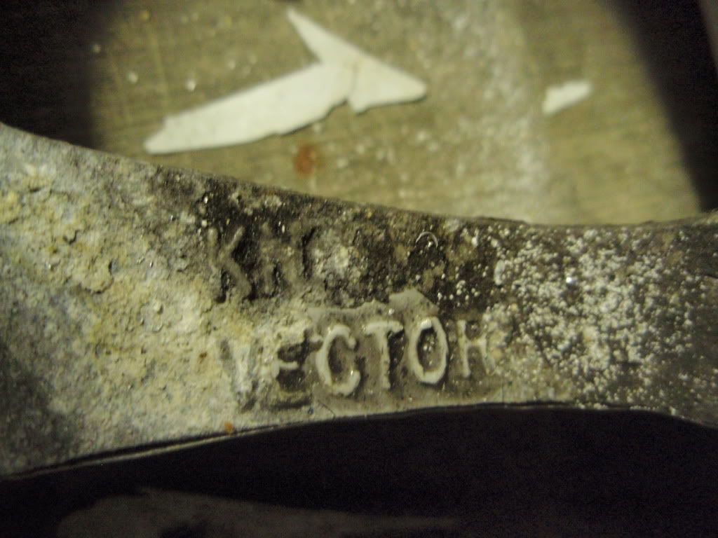

Has taken me a while but i've just noticed my alloys dont match, one side of the car has one style and another on the other side:
Would like to try and track down two more wheels to match this one:
I haven't worked out who its made by yet but i'm guessing it may have been rimstock/team dynamics:
This is the other style which is a KN Vector:
Both sets are 14 x 6 and fit with no body mods or spacers.
