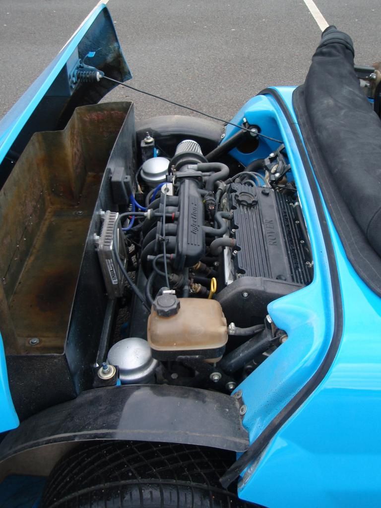

Heat sheild is some generic matting off ebay with 3 layers on the part closest to the manifold, the edges were tidied with heat resistant tape.
Really pleased with the trimming compared to the first guys attempts, it was carried out by Brockwell's in Kings Lynn (no website unfortunately)
Its Porsche mexico blue, looks really nice in the flesh but as you say very vivid in pics, but hey its got to compete with my last bright orange rossa.

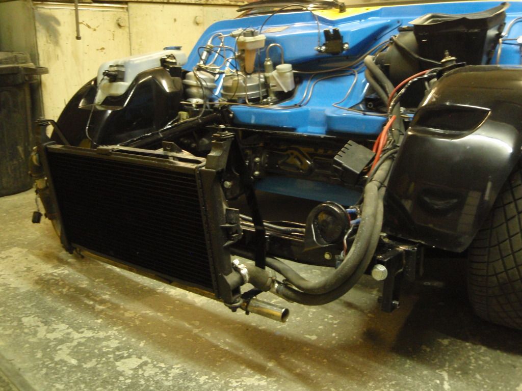

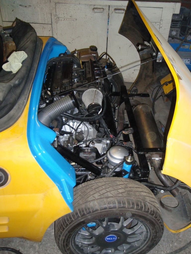

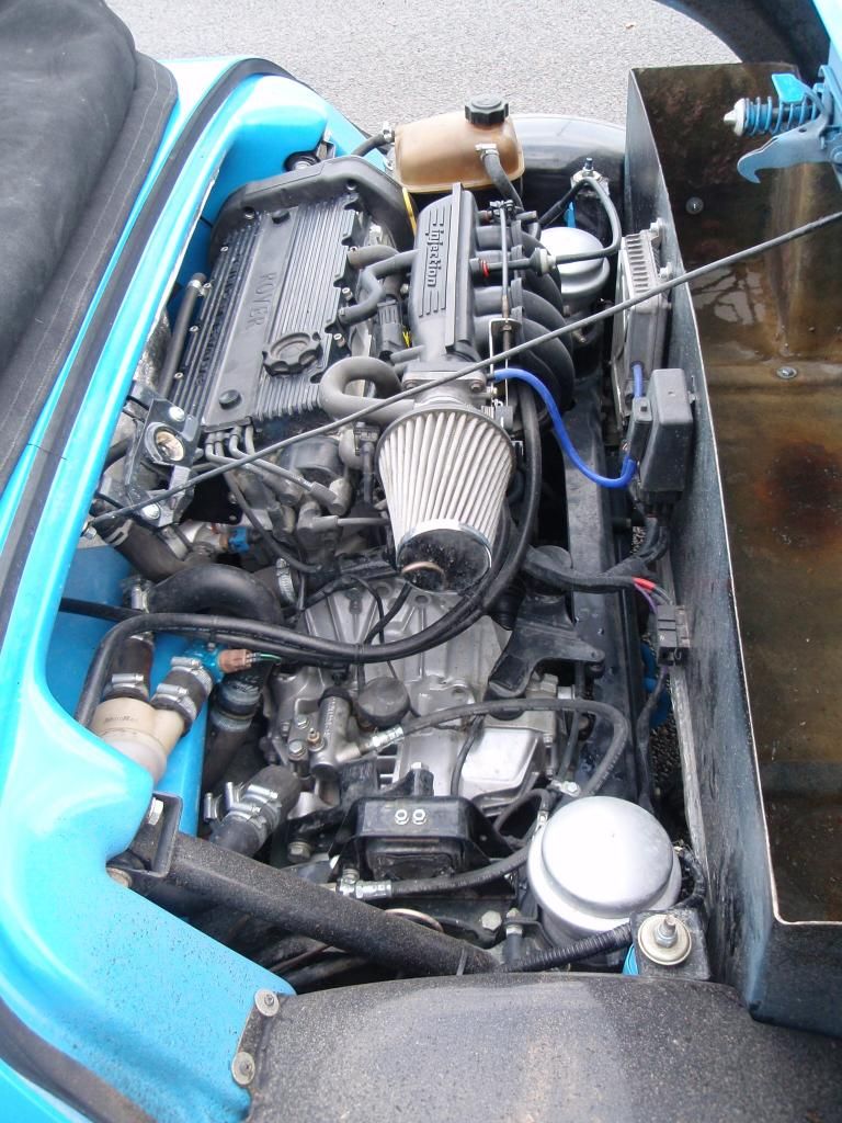

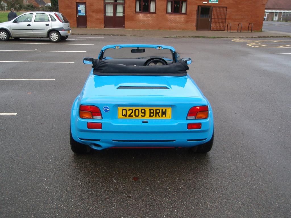

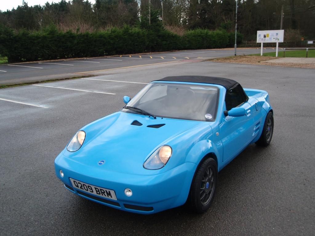

Have been making progress on the K3, can't wait to get it back on the road.

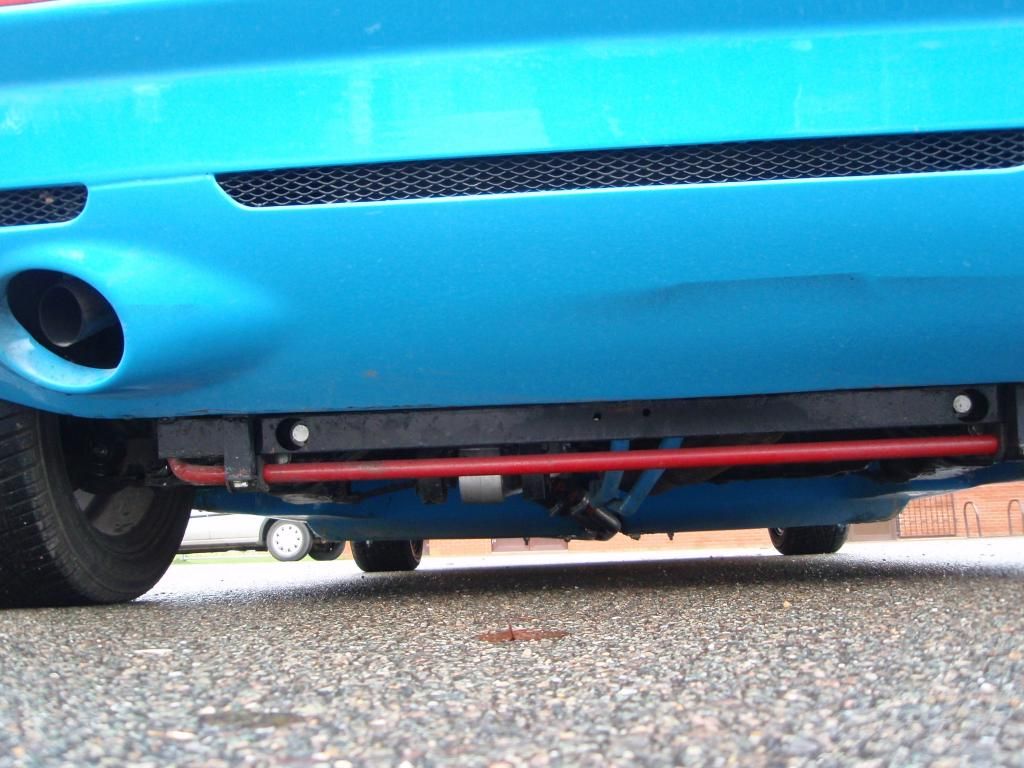

Rear end nearly done:

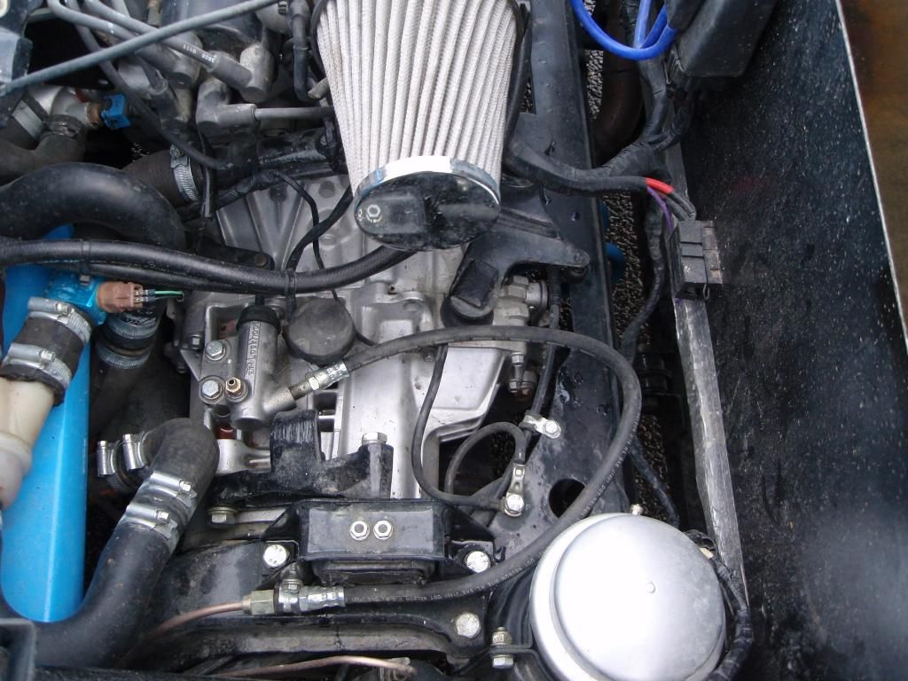

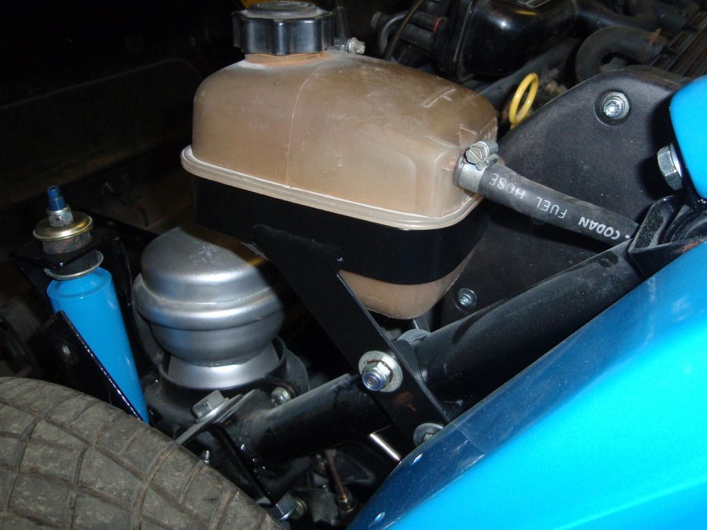

New bracket for header tank:

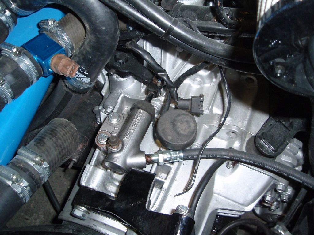

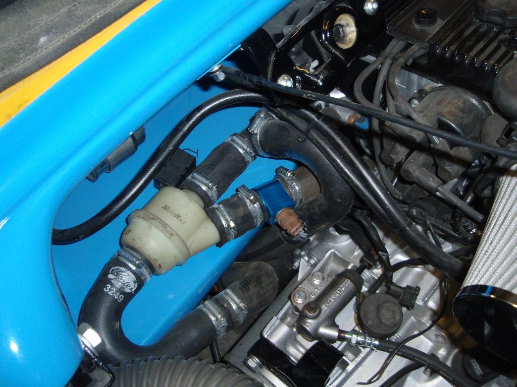

Rover PRT/Freelander thermostat setup:
Clutch slave cylinder setup:

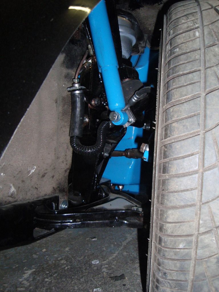

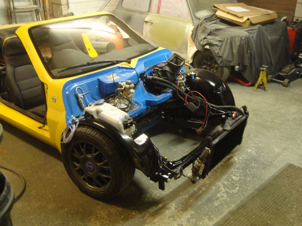

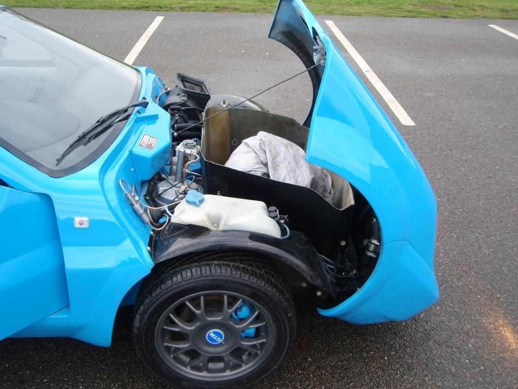

Front end now to the same shiny standard, fitted with all new suspension parts, hoses, radiator:

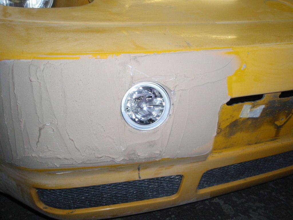

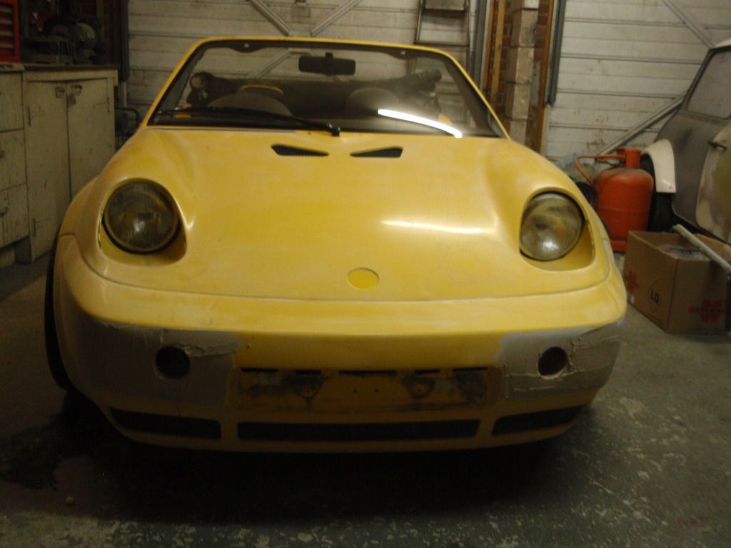

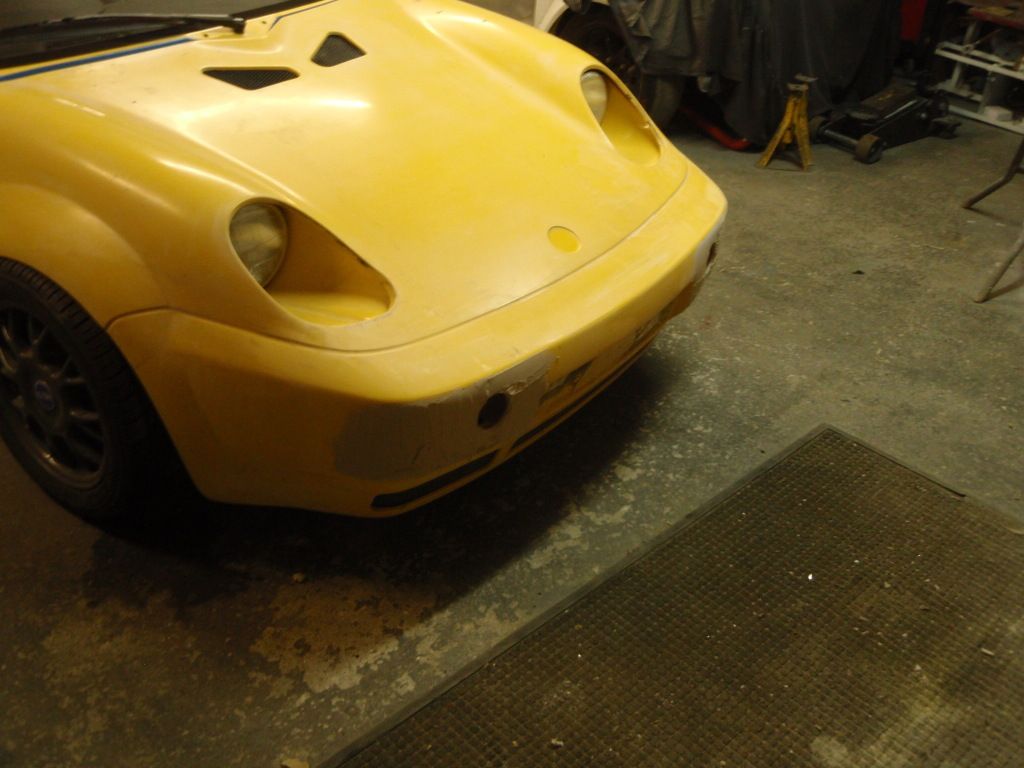

Remodeled the front end as the sierra lights looked very out dated and were damaged and too expensive to replace:
Just need to find some 70mm indicator lamps to match.

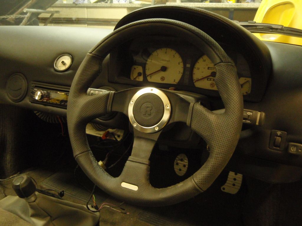

New steering wheel to go with the new interior:

Well done, quality of work and detail especially the area's that you don't see much after a build is complete looks good. Good photo's clear and informative.

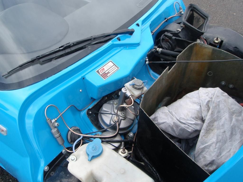

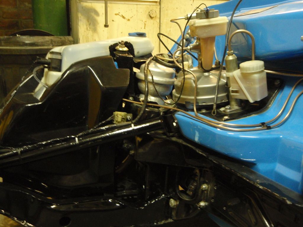

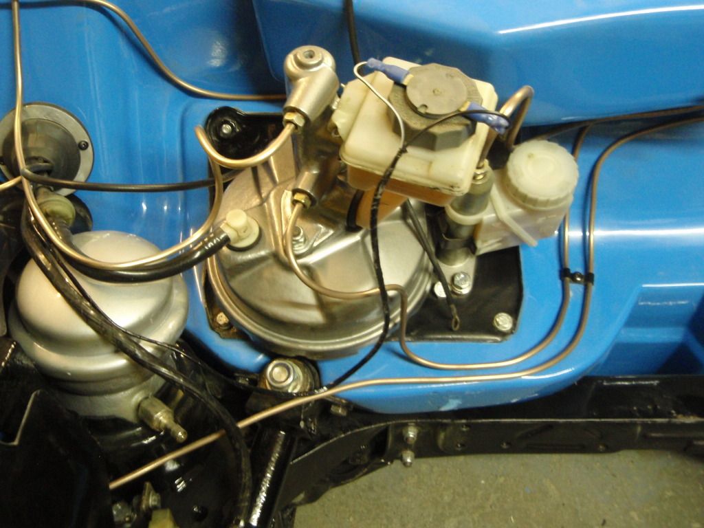

I did notice on one picture of the front end that you have still got the pressure reducer fitted to the lower part of the "T" connector fixed to the front bulk head. You may not need the reducer if you have fitted the rear calipers/hand brake mech off another Rover or MGF. You may not have much brake force at the rear.

Thanks for the comments, its the little details which bug me so i've been spending the time trying to get it all nice and tidy.
Thats a good point about the pressure regulators, the front calipers are standard 100 and the rears are MGF rear calipers. I guess only time will tell when the car goes on the roller brake tester.

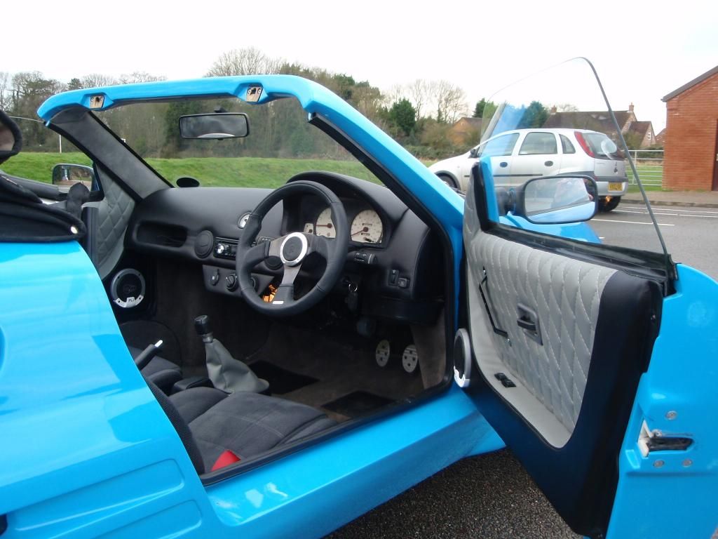

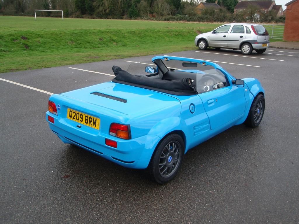

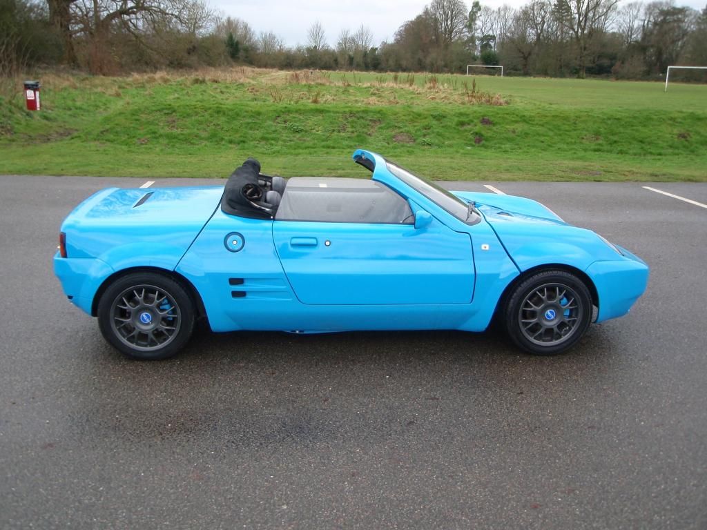

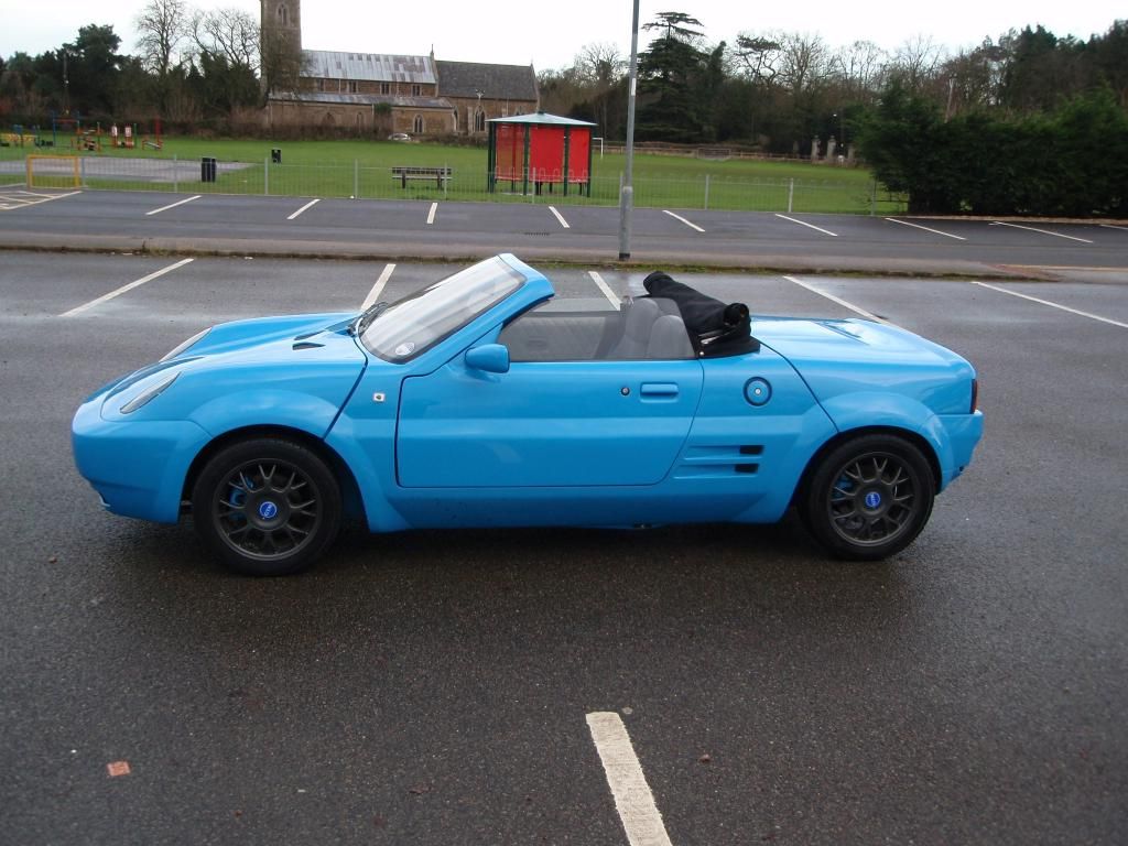

Very nice 8) To say that the car's like new would be an understatement - it's far better than that! That colour really suits it and is a nice change too. Well done 8)
I've never actually seen a K3 and your photos are very interesting in that the differences between it and my MK1 Rossa really stand out. Accessibility is much, much better and obviously lessons were learned and put into practice when the K3 was designed.
