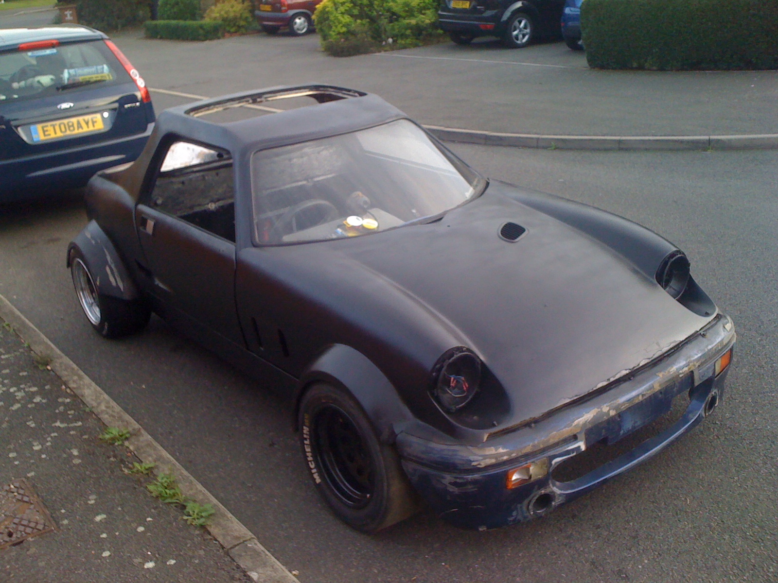

Rover 100 hubs dont fit as the bottom ball joint is different :(
I therefore brought a set of mini calipers for 8.4 discs. Which i then found didnt fit due to me have a 7.5 inch cooper s setup. If anyone is interested in these front discs and drive flanges for a 7.5 setup as they are for 10 inch wheels please send me a message.
