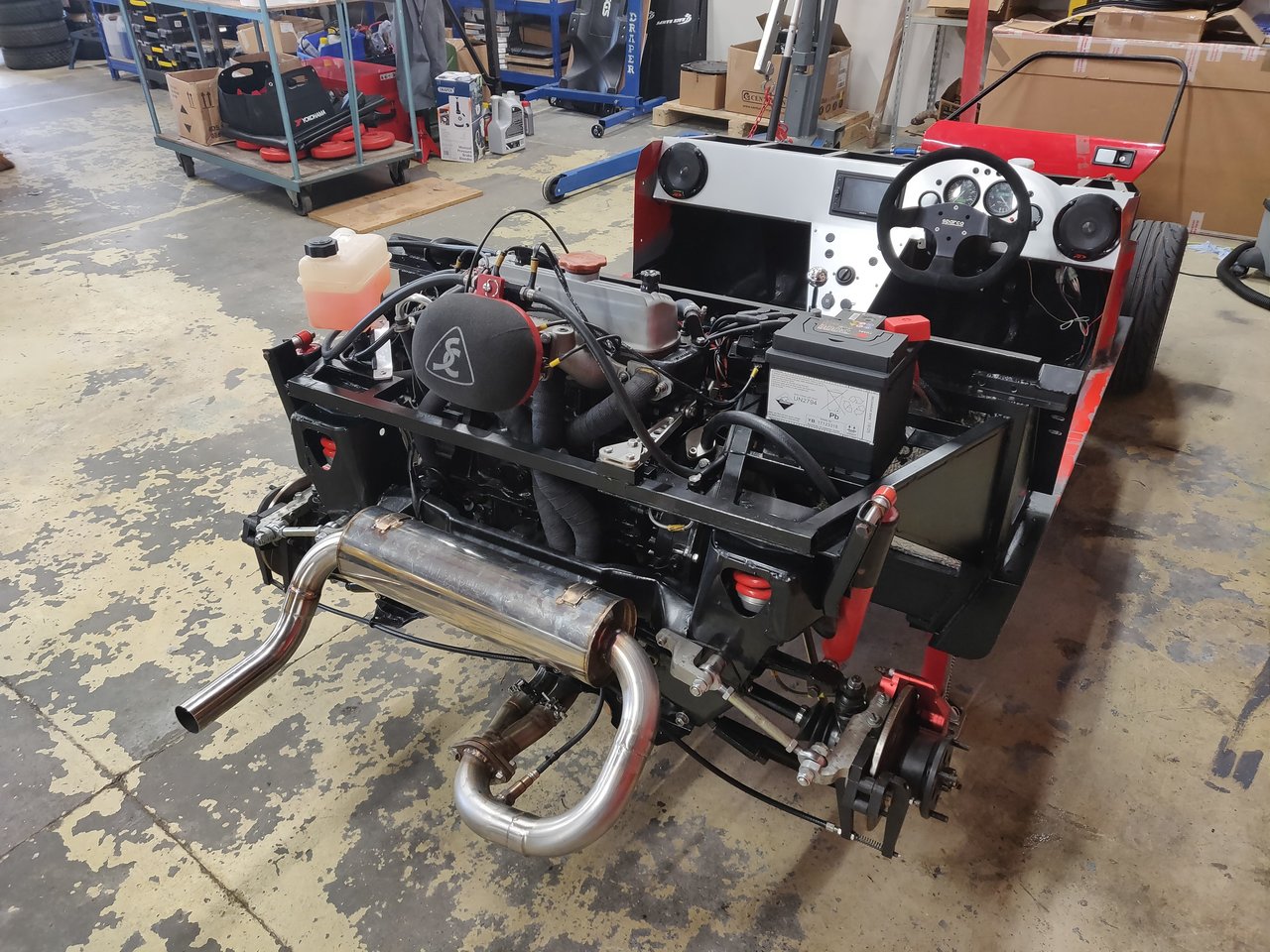

A stainless steel exhaust system has been made for the coupe fitting the biggest silencer in the possible space.

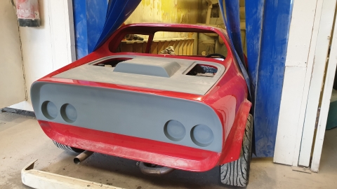

Trying the GTM rear bumper with the new exhaust system did not fit well so this bumper that has been made by another owner is going to be used.

You could get a slightly larger silencer in :wink: what I have done fills the area completely!
I see you have gone for the Nankang track day tyres, be very careful in the wet, any standing water is scary.
Have you thought about moving the battery to the front for weight distribution?
I see the Vauxhall rad is fitting well :wink:

I have experienced the tyres already :shock: we are planning on getting a second set of wheels for drives with any chance of being wet. What tyres are people running? Something like 175/50 R13 A539 Yokohama. https://www.minisport.com/yok1755013a53 ... -mini.html
Did originally plan to fit the battery in the front as suggested, but that means you have to run the heavy gauge cable from the front to the back. So the battery is fitted in the engine bay to shorten that cable, and the battery only weighs a few kilos so it shouldn't affect the weight distribution very much.
And yeah the radiator is fitting well and cooling the engine very efficiently. During the rolling road session the main fan had to be turned off when it was idling as the engine could not get up to temperature. Maybe too good :)

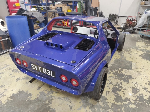

We have had some fiberglass work done in order to fit the rear lights, these are the led rear lights from a lotus elise. This was done rather than trying to make some up using Hella components. And a rather big change is now being a painted car, it is painted in Volkswagen's Lapiz Blue and now looks like a completely different car :) there have been some other minor adgustments such as moving the pedal box over slightly for more clearance around the steering column, however it is still a squeeze. The bumper and front end which is now modified to remove the mini front bumper need to be fitted however I have now moved out to university so progress will be slower.
