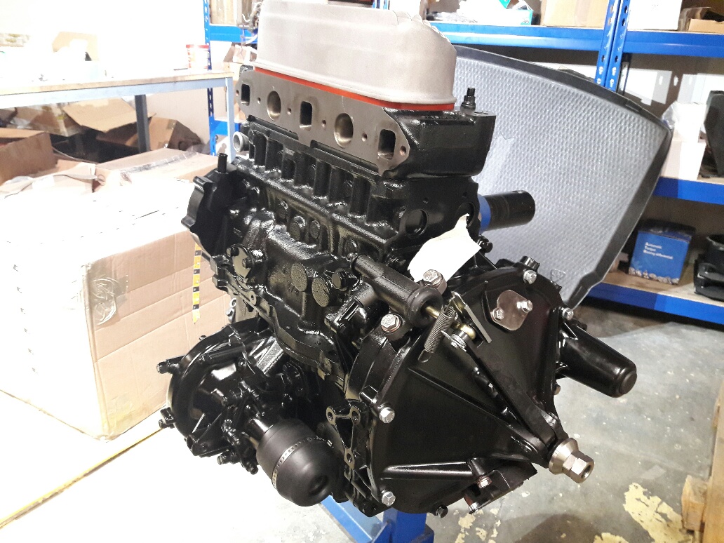

Preparation on the tub is going well, alongside building the engine and subframes. The subframes and compomotive cx wheels have been powder coated in black, which you can see below, in my opinion they look pretty cool. :lol: We are currently working on fitting the pedal box, which should be completed soon. :D

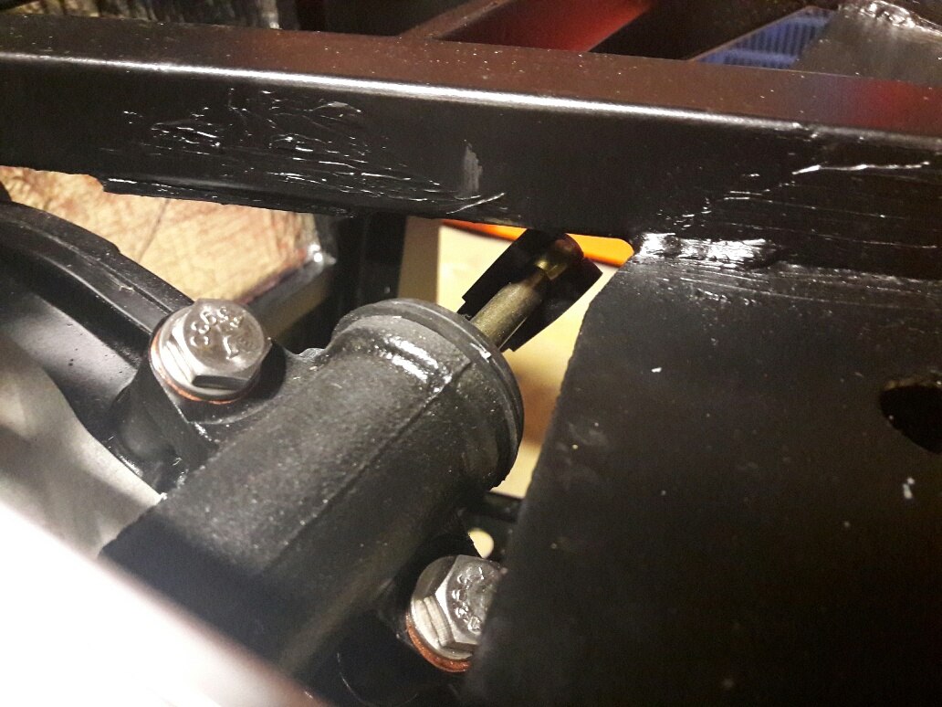

After a struggle the engine is in the subframe, and now onto the car. Pictures will be posted soon. But while we were fitting it we noticed that the clutch slave cylinder return spring hits the chassis, so we had to remove it. Is this normal? And is there a different way to attach the spring?

I remember having a similar issue on mine when I was A series powered. I ended up profiling the arm around the pin to increase clearance. I did get a return spring fitted too.
Also think some careful positioning of the engine on the steady bars helped and having the engine fairly stiff made sure it never caught.

The early Cox build recommended the clutch arm should be bent a little to give a clearance with the more bulky early sheet metal chassis, cant remember how much but it was shown in the CCC GTM build project.
