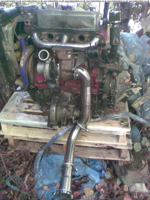

i'm using a different plenum, but in total, the carb, manifold, plenum etc goes back 10" from the manifold face of the head. Also is there anywhere with good airflow near the engine to mount an intercooler? I have an engine mostly built but have no car to put it in, as my mini died an untimely death a few months ago!

thanks this is all very helpful. I believe the smart car uses a fan on it's intercooler.
this is a pic of the mirage setup on my engine (if the pic works!)
