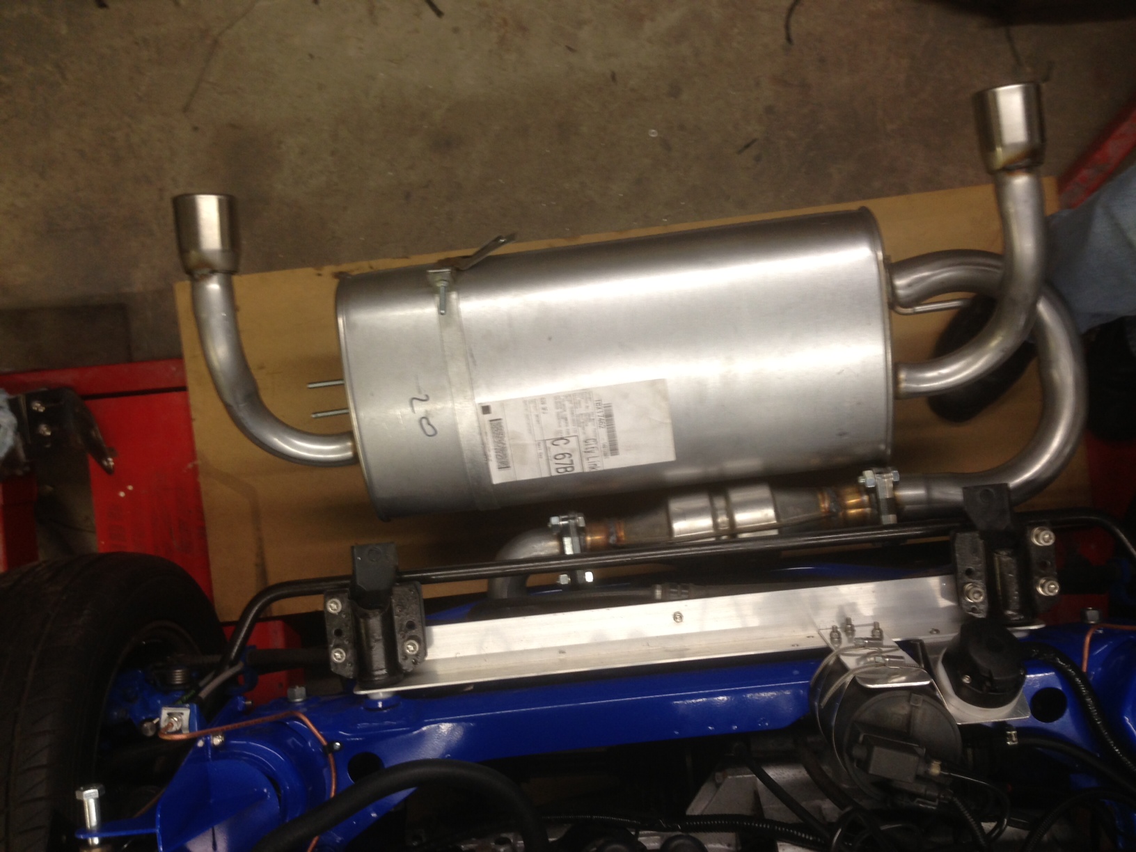

This is how it looked with the cat installed. It pushed the box out too far and would have needed surgery to the rear clam so I made my own.
Peeps.

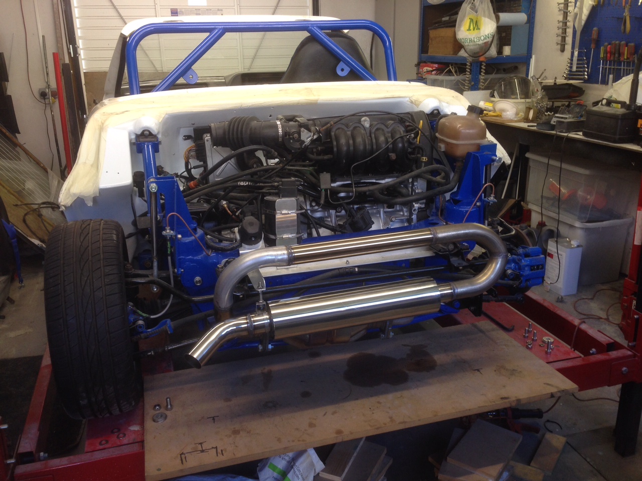

Hi J,
No, I did away with the original box section horror, fastened the arb to the mount brackets as shown and made my own adjustable clam pivot plates that bolted directly to the subframe.

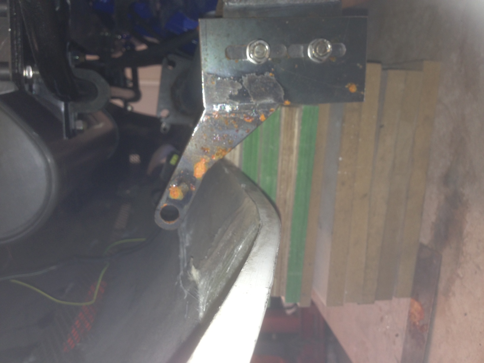

The triangular piece that takes the pivots originally was hanging off so I removed it, bonded in a couple of stiffeners and then bonded in a couple of stainless brackets which then lined up with the subframe brackets. These gave me 30mm adjustment up and down and in and out. I will see if I can find the original drawings for the subframe mounts, I had these laser cut (surprise!) and welded one into an 'L' shape for the other to bolt to.
Peter.
