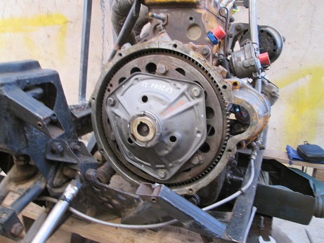

28-29 December dropped out the engine with my newly made A frame and chain block, then put it up on my work table on wood blocks under the subframe to hold it upright, with my modified subframe I could still get the clutch cover off, but don't think it is intended to remove the clutch housing without removing the engine, with enough chocking, tilting and loosening the timing cover mounts you can get the clutch housing off but only just, the 1st time I've seen inside for more than 30 years when I built it up and it all looked very clean and decent in there, now to inspect the oil pump to see if that is the cause of the oil draining back to sump, or do I have to dig deeper?

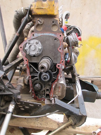

Housing off oh and I put the Body back onto the chassis, but just sitting there not attached

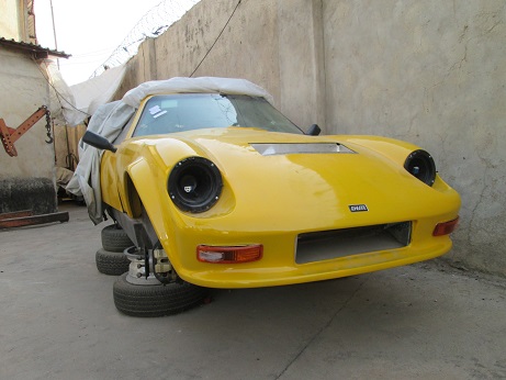

Post 9ger Coupe
As Kano Coupe refuses to open and let me post updates this is the continuation version,
I decided the round Mini/Defender style indicator and side lights did not look right on the front section they will be taken back to UK as spares for my Defender, so I looked around here and found something almost fitting the slight GTM front curve fitted to Indian Bajaj 3 wheel tuk tuks, so that's what we have fitted.

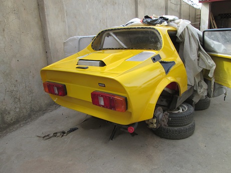

The nether regions have been fitted and the engine/subframe refitted (but not for long) along with the mk2 riveted in rear screen, I could not find anything to replace the rear lights locally so stuck with what came with the car after lots of soldering to sort out the internal earth connections.
