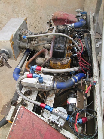

The oil pressure saga continues, we have it (psi) but only if primed 1st, I suspect because the oil supply and return to the Laminova cooler goes up to cylinder head level and then down to the vertical mounted oil cooler in front of the timing cover, this was done to ease water pipe connections. Plan B is to mount he cooler over the clutch cover ( in what was intended for a place to put he battery?) with short pipe runs, the inlet water to the block will have to pass across the rear of the engine just under the inlet manifold.
Have to put into position next weekend to see how it can fit
Thu Jun 13, 2019 6:12 am
The revised mk3 (or is that mk4?) oil pipe to Laminova oil cooler connections with re-routed water pipes, oil pump primed and 40 psi when cranked, will leave it for a week to see if it self primes, fingers crossed.
