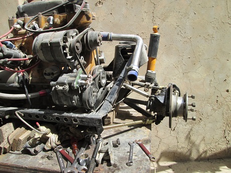

Its a squeeze but fits and clears the bulkhead with the tensioner extended phew :lol:

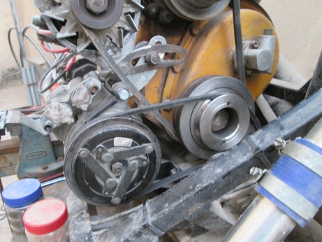

Now to get the shortest proper sized belts

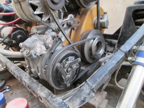

Made and fitted adapters to fit hoses to the compressor and had a rethink (plan C) to fit the 'Rossa Bits' style steering locking link that I started with until I found it fouled my original (salvaged from my old Cox) exhaust manifold

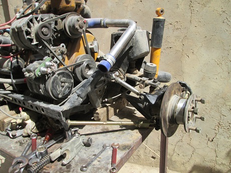

At least I now get to use the Mini Spares lower arm and link :lol:

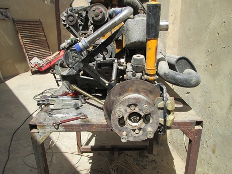

I still have to fabricate a support bracket for the inner pivot and make slightly longer brake pipes having swapped the calipers to behind the uprights (and left to right)

I'm guessing no need for a handbrake/E-Brake on the car?
Mon Feb 05, 2018 11:16 am
Loads of our local trucks have a boy who jumps out as they come to a stop and puts a big wood chock under a wheel, can be a worry if you are behind one doing a hill start :roll:
I have the hydraulic handbrake, I don't want to carry a "motor boy" and a chock :wink:
