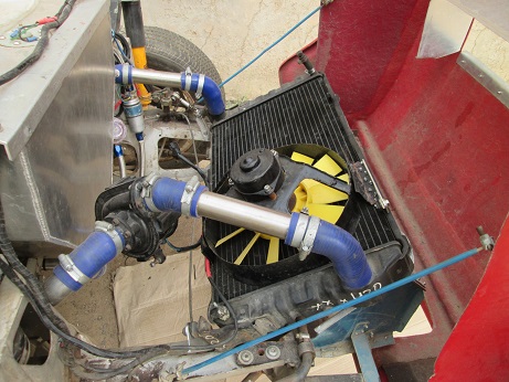

The MK2 Radiator has been fitted along with adapted Mini type fan, as its inlet and outlet were opposite to the radiator that came with the box of bits (Allegro??) I had to rearrange the pipes coming from the engine inside the tunnel and put the electric pump on the R-H side and swap the fuel pump to the L-H side, The rad has Toyota printed on it but I have no idea what model.
I also got hold of an air conditioner rad that with jiggling could be fitted but found it leaking when pressure tested this morning at work :(

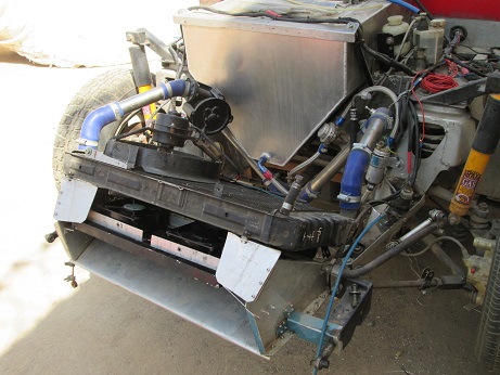

Air con condenser rad in position with its 2x12v axial fans, now to find a compressor, drier and condenser rad assembly

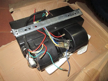

I bought an underdash aircon evaporator unit with fans and controls, just under gbp60 quite a bit cheaper than Car Builder Solutions?? still looking for a small compressor, there is not a lot or room in the rear :lol:
