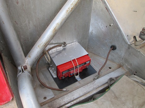

Thu Jun 29, 2017 10:08 am
Nice new battery box

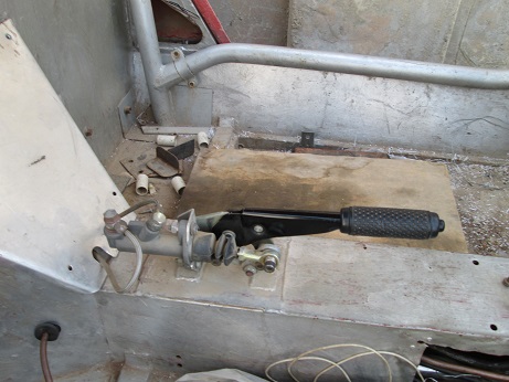

Wed Jul 05, 2017 6:38 am
mk2 handbrake
