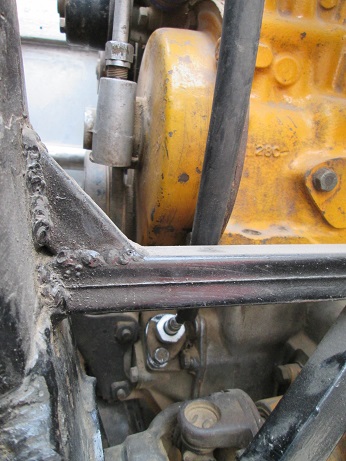

Fitted Sanzomats MGF speedo cable, I had to recut the thread on the little cast aluminium mounting block from 3/4" tread to M18 x1.5 for the cable nut to fit

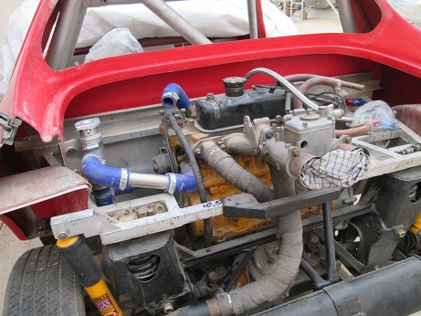

Water hoses and header tank in position

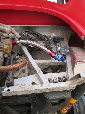

Remote oil filter in position, still have a Laminova oil to water heat exchanger and more fittings to collect on my next UK visit to complete the job

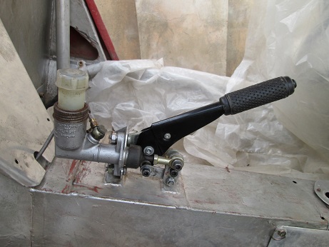

Thanks to my Muslin brothers having 2 days holiday for the end of Ramadan I made a hydraulic hand braked using my ex Jedi clutch master cylinder, (it now has a cable operated clutch)

A hydraulic handbrake, that is a nice idea for the future!
Nice to work on the car with the loose rear end, but how is the rear end fixed?
Harold
Sat Jul 09, 2016 3:26 pm
I had no other option, no handbrake or Hydraulic as I'm using the same Toyota calipers front and rear :wink:
Sun Jul 10, 2016 5:36 am
John,
Are you using separate/additional rear calipers for the hydraulic handbrake?
I ask this as you have used an integral reservoir master cylinder rather than using a remote type.
Hydraulic handbrakes normally feed through a remote type master cylinder with the main rear brake line as the feed to the cylinder and the output going to the rear calipers.
Doug.
Wed Jul 13, 2016 8:34 am
Cheers Doug, you just spoiled my day :oops: luckily I do have a remote cylinder that could be plumbed inline.
Thanks for making me think a bit more
Wed Jul 13, 2016 9:46 am
Don't worry John - guess who else made this basic error :oops:
Mon Jul 25, 2016 3:41 pm
We all have our moments, engage brain before taking action :lol: and I was feeling quite pleased about my hand brake solution :!:
