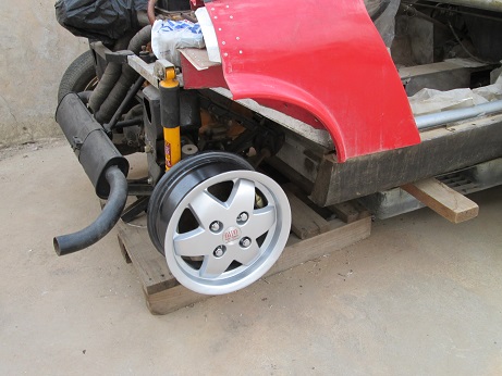

Just bought 4 BBS 13" wheels for Toyota hole pattern at less than 50 quid :D
I still have the 13"x6 wheel bought off Runk the Punk in the UK if anybody is interested
