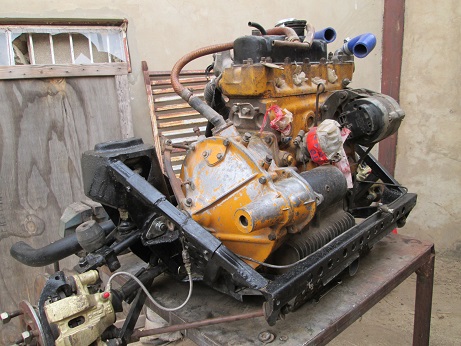

another

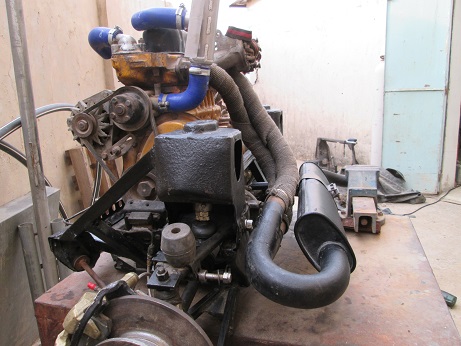

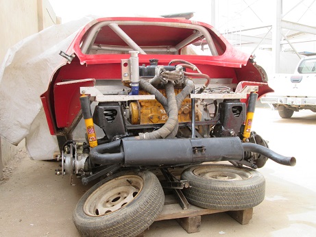

Getting close to sticking it in the hole :wink:
Sat Mar 26, 2016 9:10 am

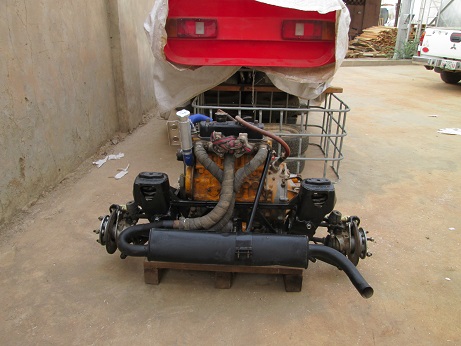

It is a long time since an engine has been in there, had to have a little surgery to cut out the 1" square cross tube, never had that in my old Cox GTM, another problem for my one off LCB exhaust. will make a bridge piece to bolt in.

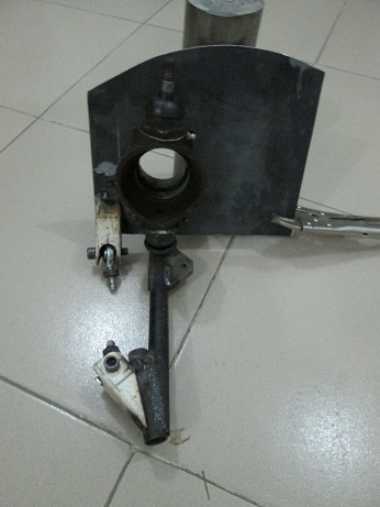

An alternative steering locking system?
The caliper back plates are not yet cut to size and everything just tack welded together to see how it looks, it would be drilled to suit my Toyota calipers, reduced in size and ribbed around the locking arm pivot to stop any flex under load; the inner pivot is attached to my local made camber adjustable lower arms that are Mini Spares copies.

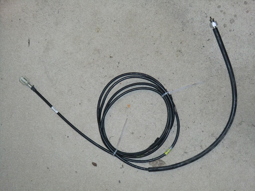

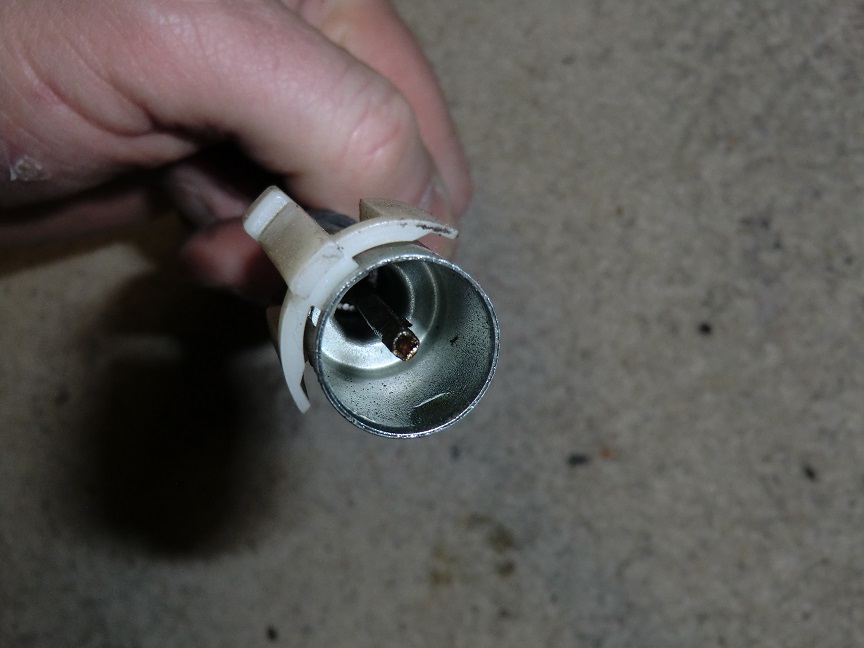

Anybody know off head the length of a speedo cable?
Mon Apr 11, 2016 5:29 pm
From memory 12ft.
Yes it is that long, longer than a Coupe thus allowing you to get nice gentle curves in the cable.

Anybody got a speedo cable for sale, or know the bset place to get made?
Tue Apr 12, 2016 9:35 am
I've got an MGF one if that's any good to you?
Tue Apr 12, 2016 9:00 pm
Hi Sanzo,
I would guess the speedo in a box of bits that came with my car is Metro of MG it is made for a moulded connector that snaps into a groove on the speedo at T'other end is the normal Mini gearbox nut onto an outer cable flange, the speedo end is a square drive and if I remeber corectly the gearbox end is a flat "spade" Sadly My sample end fittings are in the UK as I took them back last year with the plan to get one made and did'nt :oops: I'll be back next Monday and will pass Bristol M4-M5 on 22nd April and again on 30th April or I will be at Stoneleigh on the Monday, if we could meet up?
Wed Apr 13, 2016 6:59 am
Hi Sanzo,

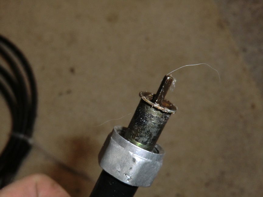

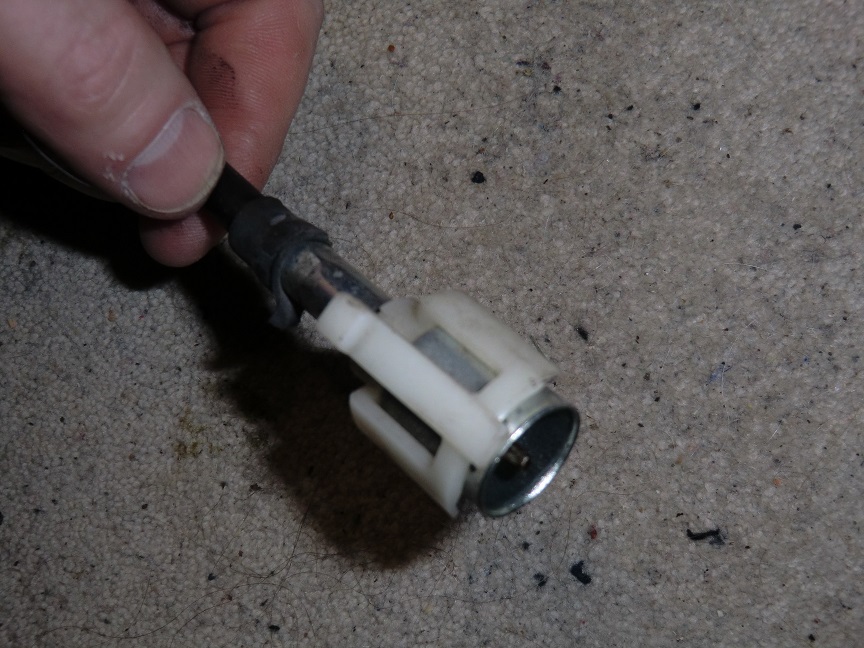

TBH I can't remember the end fittings on the MGF cable as I simply removed it and then it went into the shed somewhere as I have an adaptor to convert the gearbox output to electronic pulses and then just a wire to the speedo. Pretty sure the speedo end is a square. At a guess I would have said the gearbox end is a square too. I'll dig it out of the shed and take some pix.
I am currently planning (but not def) to be at Stoneleigh on the Sunday but could leave it in the tent for you. Alternatively on 22nd I'll most likely be at work very close to J19 of the M5 (Portishead) during the day or home (Yate - North of M4 between 18 and 19) in the evening.
Wed Apr 13, 2016 7:16 am
John,
It might be worth giving these guys a call -- http://www.speedycables.com/ -- near Swansea I think.
Wed Apr 13, 2016 8:57 am
Thanks Steve I will pass Swansea ovenight on my way to Llys Y Fran maybe stay over till monday and call in on the way back :idea:
Wed Apr 13, 2016 9:29 am

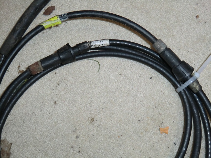

A few pics of the MGF speedo cable (which wasn't nearly as buried in my shed as I thought!)
