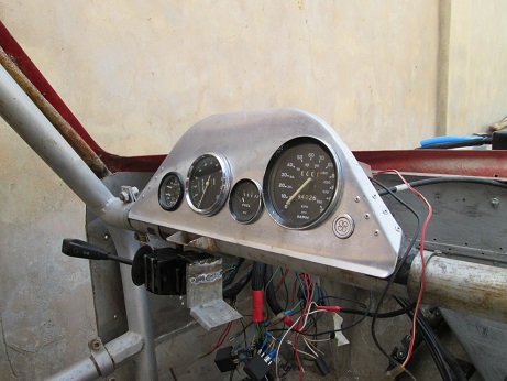

Dash as simple as it can get!!

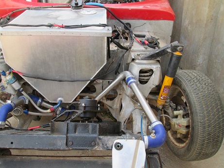

Front end from L side

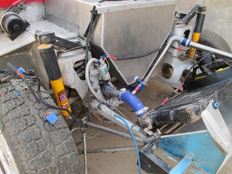

just to show I'm not biased now from the R side

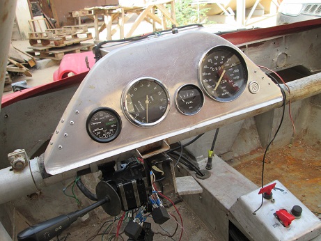

Dash, battery isolator, ignition and and starter button

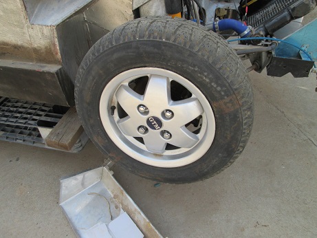

My cheap local purchase 50quid wheels fitted with 165-70 just to check clearances in case I cant find 60 series tyres :cry:

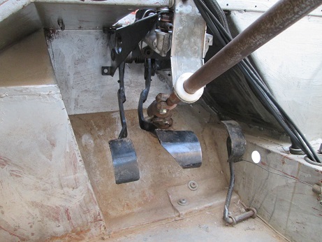

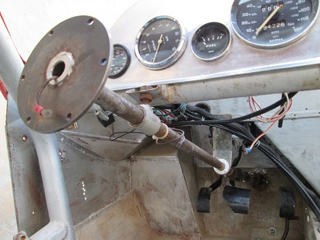

One step forward at least 2 steps back, assembled my steering column with 2 U/J's to give a better alignment on my L-H drive installation, the good news is it does,"BUT" I now have a slight foul on the brake peddle, OK strip out the brake/clutch assembly, remove the brake peddle and put a little kink into the lever each side of the cut and shut joint, then found 1 of the brake cylinders on the bias bar assembly is seized, (it has been outside more than a year) so take the whole assembly into work where I have compressed air to blow the pistons out and to clean :roll:

The peddle box is at work being tweeked, if it all goes together OK next week I'll take some pictures, the biggest problem in L-H drive is there is not enough room to pass the column between brake and clutch peddles as would be normal in a Mini or R-H drive GTM, to give enough room for the brake and accelerator peddle next to the center tunnel the brake peddle must be to the left hand side of the column, big feet would end up at the chiropodist :oops:

column with 2 u/j's

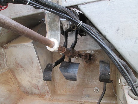

column missing peddles

"small' steering wheel??

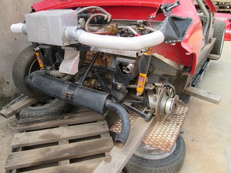

nether regions

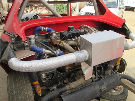

nether regions 2
