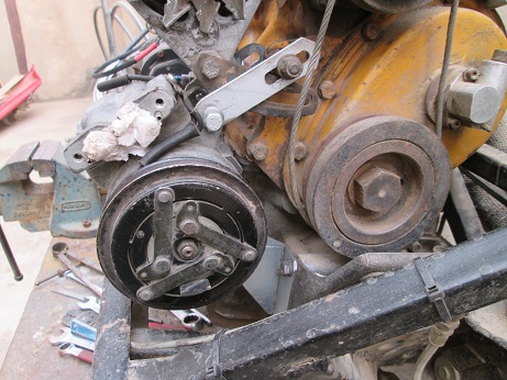

Made mounting brackets for the compressor fitted onto the engine mount over Christmas, back to work today will get gussets welded in the mounting bracket and a long nut turned up in the lathe for the second adjuster to fit the other side of the adjuster for both alternator and compressor, then make a new pulley, but struggling to get the pulley bolt out and no rattle gun available here will make a tool with 2 pegs to fit into the pulley with a long handle :wink:

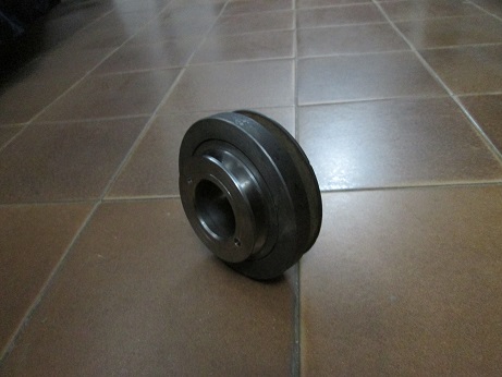

My modified crank pulley and a/c drive pulley

Fri Jan 12, 2018 6:39 am

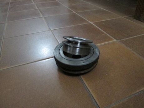

loosely assembled
