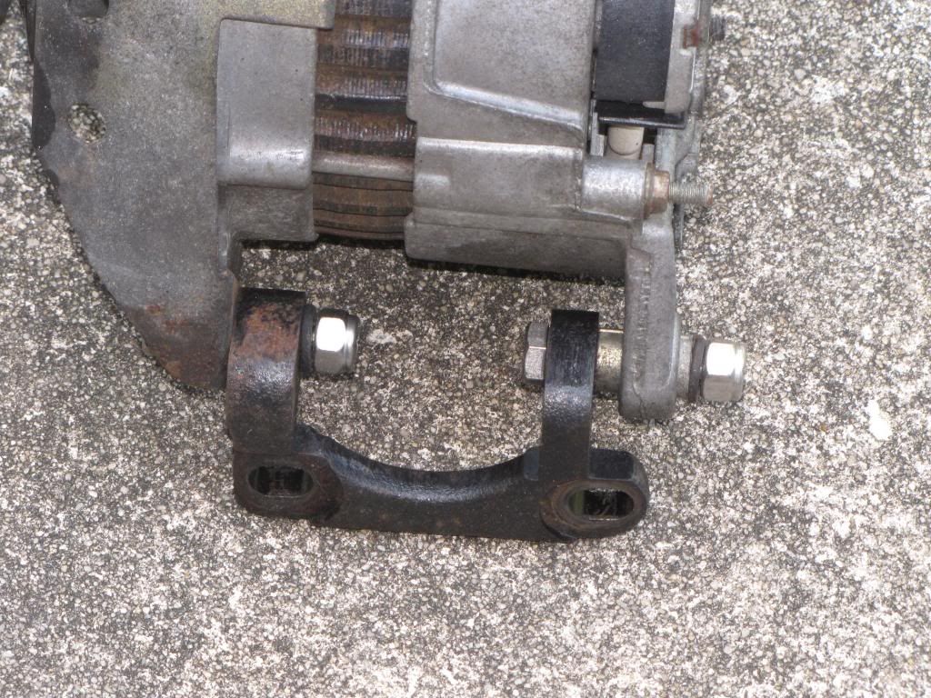

And it looks like the alternator is hung on the upper lugs on the compressor??
Mon Dec 18, 2017 11:50 am
Nope, on a L shaped bracket that hangs off the two extended head studs next to the thermostat, the ones with 2 nuts in the pictures
