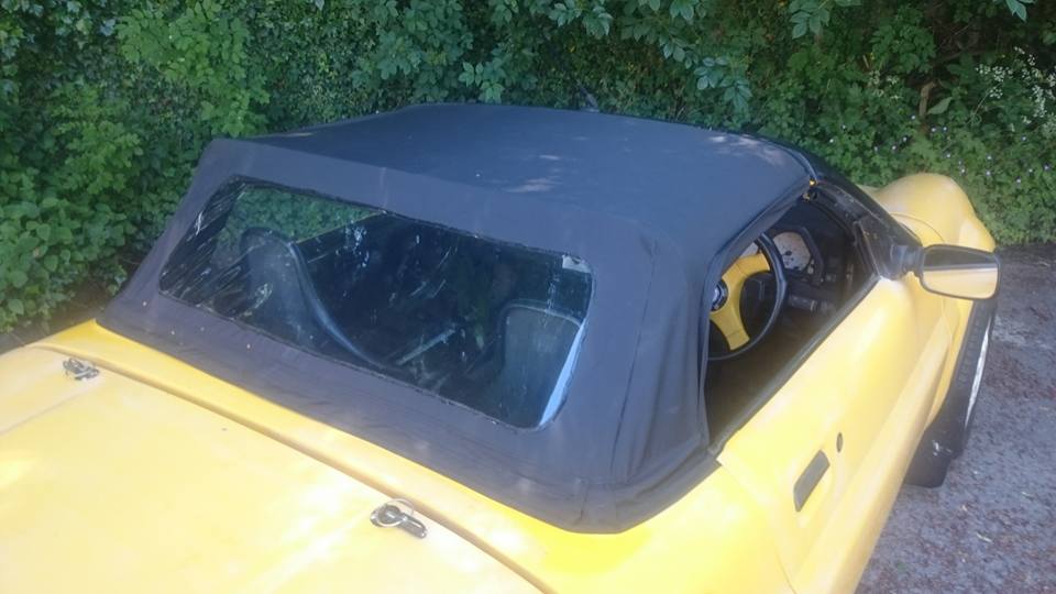

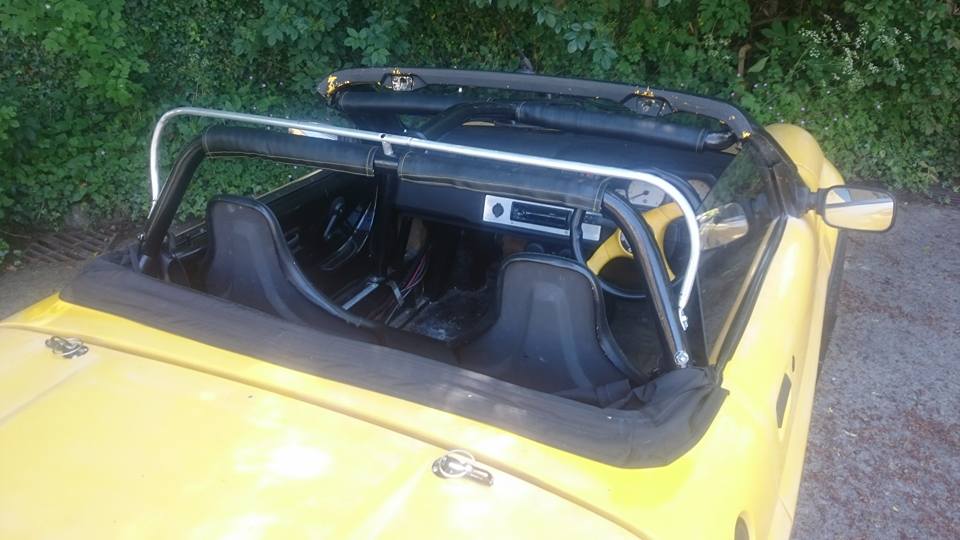

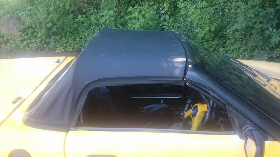

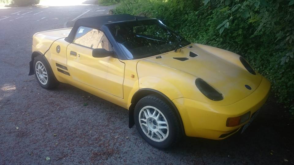

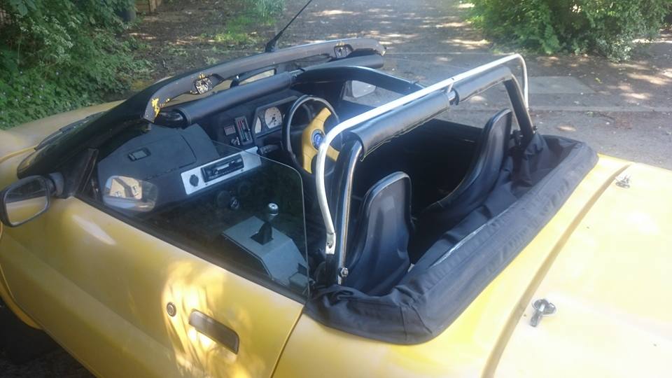

So while i love being able to take the roof off the car, only having a hard top has been a bit limiting on having to commit to not having a roof for a full day, which is rather optimistic with british weather!
I decided to give making a soft top a go! Results can be seen below, rough method was to laminate a front section to match the curve of the window frame and make an ally frame for the hoop and rear, then stretch fabric over it. Took about 3 days for ~4 hours a day but quite happy with it! It's not perfect but never really done any sewing before so rather pleased with myself and will give it a propper test drive tomorrow! It all is good I'll be using it on my trip to le mans this year :D
If people are interested I can do a more detailed build log but don't have a huge amount of build photos but can do sketches/diagrams if people want them!

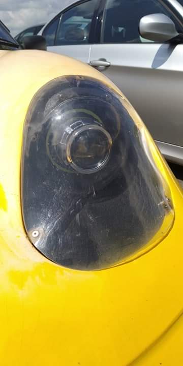

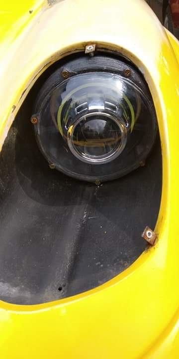

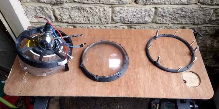

One area I've always struggled with is headlights, the original 7inch cibies were tolerable at best but compared to modern cars were useless. So I decided to fit some HID projectors, I 3d printed a housing and heat moulded some perspex for the lenses. Once fitted and adjusted properly (although airing on the low side to avoid blinding at the moment) they are easily the best headlights I've ever used and have less glare above the cutoff than the halogen headlights they replaced.

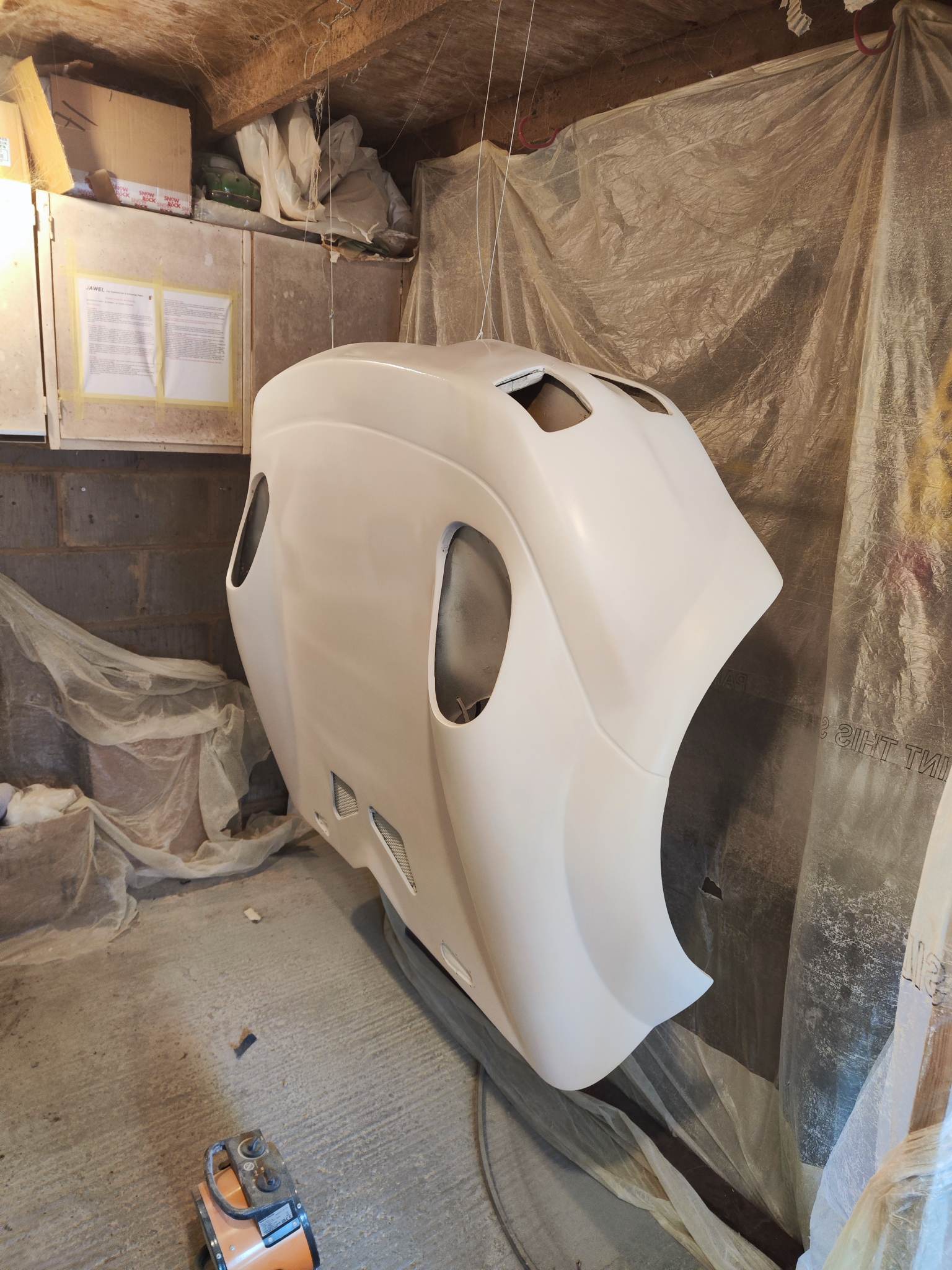

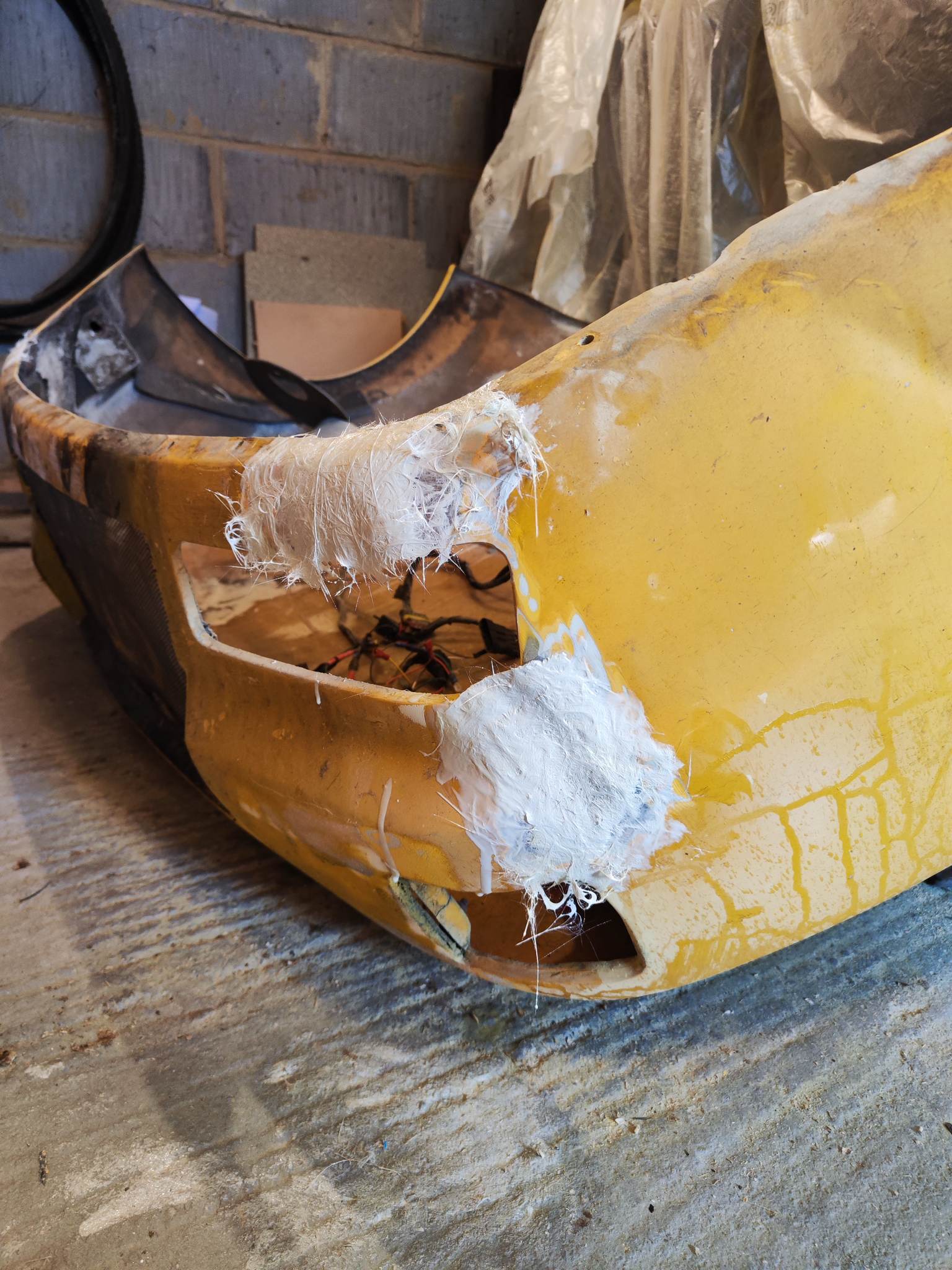

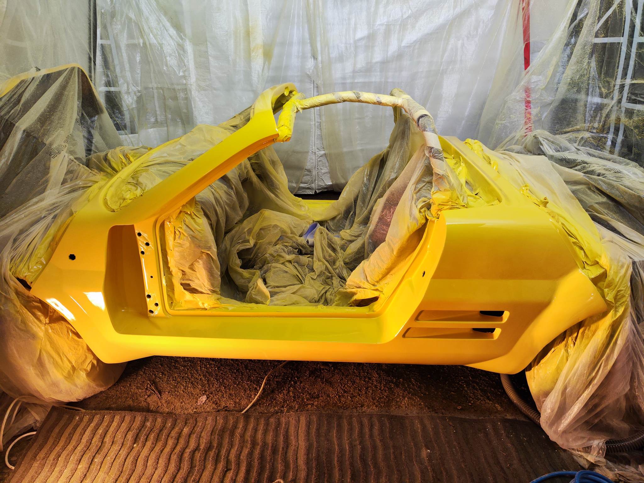

4 More years on and I finally got around to painting it! It's needed paint since I got it but finally found a few free weekends to get on it!

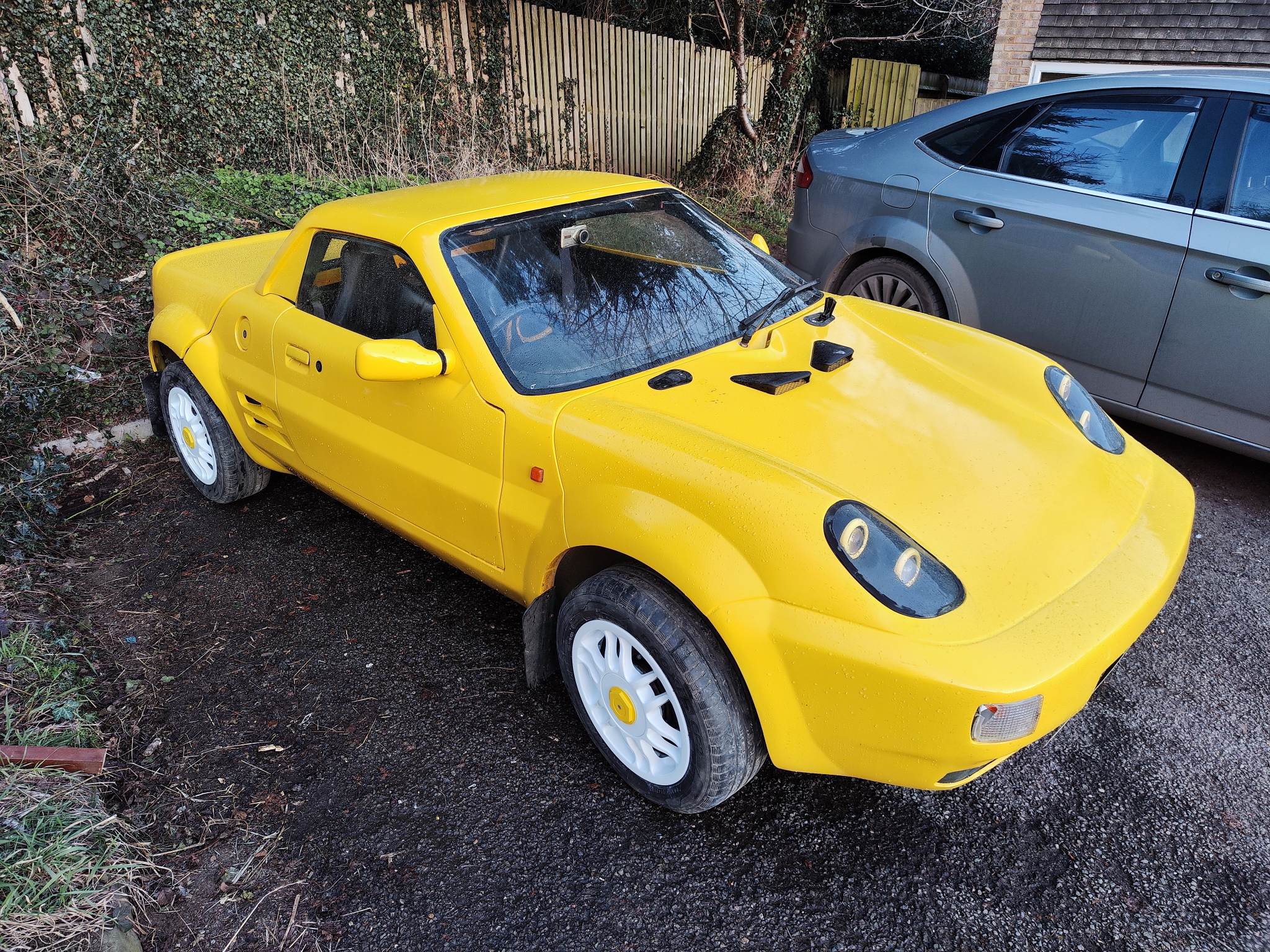

Went with MG FAR trophy yellow which is properly bright, but if you've got a yellow kit car it might as well be properly yellow!
Also re-engineered the headlights (dual projector now), blanked off the second fuel filler and widened the rear arches so I don't need the addons - front's are still a bit marginal but going to leave without the rubber strips for the moment as might put some narrower tyres on the front and they're cheeky but not taking the piss https://badobsessionmotorsport.co.uk/official-bom-tyre-stick-out-gauge/!
